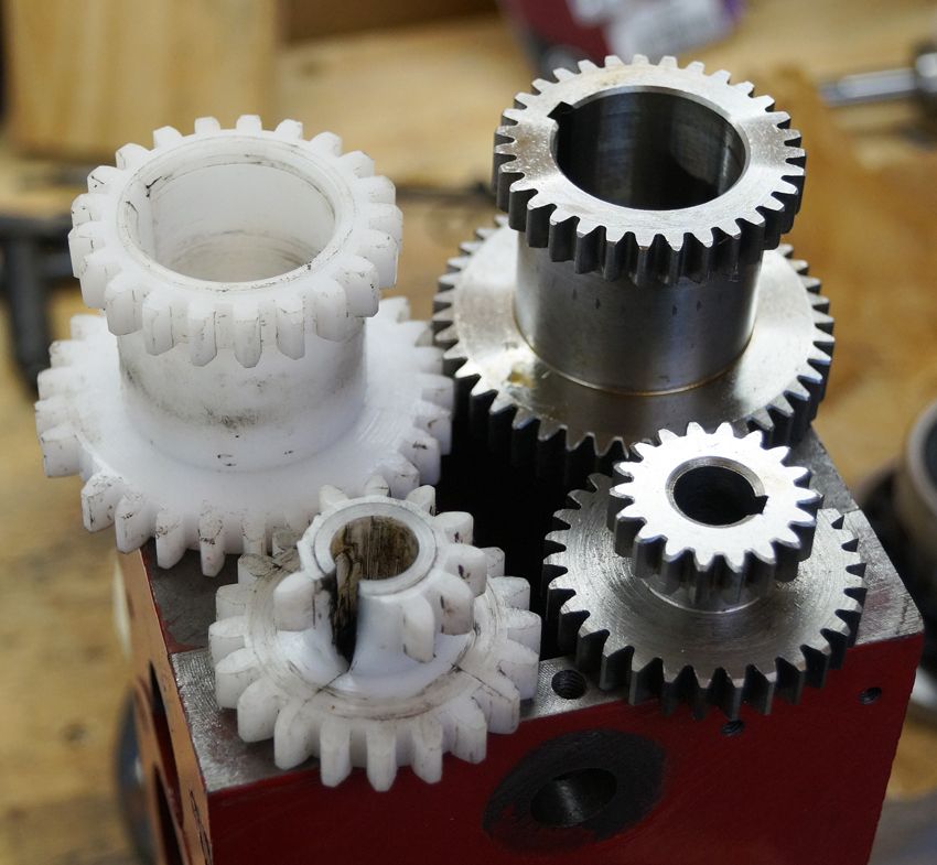

    Ron Laden
      @ronladen17547
      The metal gear set arrived, quite a difference when compared to the plastic set. I probably wont get them fitted until tomorrow, it will be interesting to see how they run and sound though I,m not looking for a silent machine.

          Ron Laden
            @ronladen17547
            Posted by Ady1 on 12/12/2018 10:39:51:
            I changed the plastic gears for metal ones earlier in the year
            Aluminium?
            I used T6 on my backgear and its been great
            As previously mentioned though, the plastic ones are a good weak link in a disaster
            Ady, in one way its good that the plastic gears act as a weak link but what is not so good is that the weak link is in the wrong place i.e. inside the head. Having to break the machine down to remove the head and then having to strip the head is far from ideal.
            I am hoping that the steel gears will be a fit and forget and using Jasons idea of a poly belt adjusted with a little slack will offer a weak link but outside of the head. Yes I will need to make a new motor and layshaft pulley to suit the belt but hopefully that wont be a problem.
            What I am annoyed about is me breaking the lathe in the first place, having stalled it (twice) whilst parting off, though I doubt I am the first and guess I wont be the last.

            Ron Laden
              @ronladen17547
              The lathe is back together with the metal gears fitted, it is a bit more noisy compared to the plastic gears but not horrendous and I am happy with it. A couple of things I sorted with it stripped down, one of the three small wires to the DRO sensor had broken, must have happened when I removed it. Looking at the solder joints they were pretty feeble so I resoldered all three. The motor was around 10 degrees or more off the horizontal when mounted with the belt riding to one side of the motor pulley. On refitting I adjusted and aligned the motor with the belt running central on the pulleys.
              Its good to have the low speed range back, the drive is still on the timing belt but I need the lathe running to make the two new pulleys for the poly belt.

              Ron Laden
                @ronladen17547
                Just noticed that I have gained a few revs, the DRO always read around 2505 in high range, it now reads 2610.
                Must be the new gears I cant imagine its anything else.

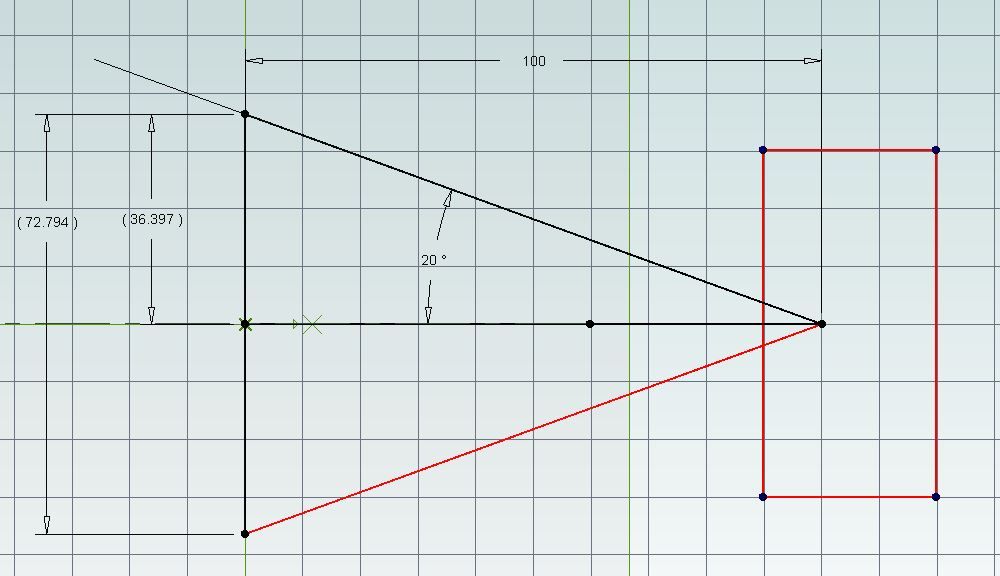

                                            Ron Laden
                                              @ronladen17547
                                              Picture below of my old thread angle gauge, can you get similar with angles not thread related, one with 40 degrees would be ideal. I found one with a single 40 degrees but it is from the States and carriage is £17.
                                              I have to make a lathe tool for the poly vee pulleys and would like to get the angle as good as possible. If nothing is available then I will have to make something but I dont have much in the way of tooling re measuring/setting angles, not accurately anyway.

                                                For a one off why not drawn it out on a bit of stiff paper or light card then use a stanley knife to cut out the vee and make a little rectangular tool.
                                                Simple if you put a line at right angles to your papers edge 100mm long, then mark 36.4 or 36.5 would do each side and make the triangle.

                                                Ron Laden
                                                  @ronladen17547
                                                  Typical me, complicating things, thanks Jason I have some decent graph paper which I can paste to some thin card. I think I was getting a bit hung up on how good the angle needs to be, using the above it should be pretty close anyway for making the tool.

                                                  ega
                                                    @ega
                                                    Ron Laden:
                                                    Axminster do various angle gauges including one by Veritas at £7.20.
                                                    Another idea would be to turn a 40 deg groove in a piece of stock using acute angled left and right hand tools and setting the topslide to 20 deg either way; that method would allow you to make gauges to a variety of angles.
