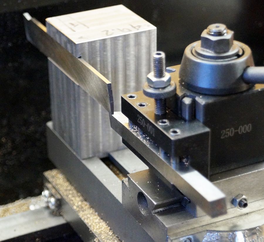

              Despite this mornings senior moment the tool post if back on track, I have machined the tool mount with the top and bottom dovetails. I was wondering how to machine the dovetails as they are shallow (8 degrees) but it was easy in the end. After cutting the slot I angled the post in the vice and used a 60 degree dovetail cutter adjusting the post to give the correct angle.
              I have offered up a parting tool (needs shortening) sitting in the mount and comparing it for centre to a tool in the qctp and it seems to be as near as damn it. Ignore the end of the blade thats how it arrived new, looks like a grinder touched the side of it.

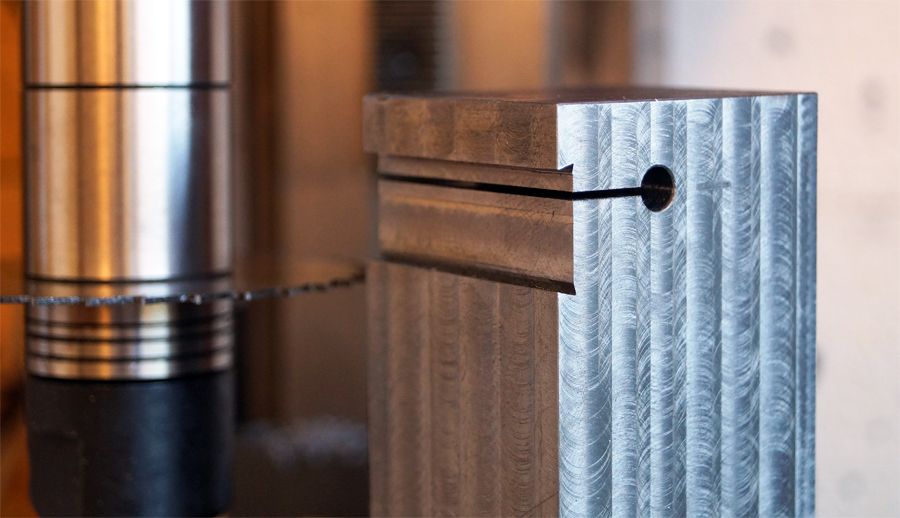

                The arbor and slitting saws arrived but having never used one any tips or advice would be greatly appreciated.
                I need to cut a 1.0 mm slot 48mm long x 13mm deep, the slot breaks through into a hole running parallel along the length of the slot like a keyhole shape. The material is EN3 and wondering whats the best approach, a number of shallow passes or deeper ones or even full depth and take things slowly..?

                    First time using a slitting saw and it went well, well it did once I got the speed set-up.
                    Jason suggests in his beginners guide that you cant always go by the book speeds with small variable speed machines and that proved to be true.
                    I started out at 200 rpm with a 80mm x 1.0mm saw but the mill didnt like that with a couple of hesitations and a stall, increased to 250 and it was better but I could tell it was on the edge. Went up to 300 rpm and it obviously got more into the power band and worked a treat, no hesitations and it didnt feel it was working hard and cut nicely, pleased with it.

                      Apart from a mounting stud and a flange nut its finished, found a M10 bolt to fix it so I could give it a try. It may be a simple post but it is very effective and so far works a treat. I havnt tried any larger diameter steel yet but parted a few pieces of 50mm alu and 25mm steel with no issues at all. It does feel different without a doubt so I assume that the rear post and the heavier cross slide have stiffened things up some what.
                      Certainly worth the effort in making as was the cross slide.
                      p.s. Forgot to say that with the tool fully forward and the cross slide back it should cut 70mm diameter, I,m happy with that as I dont fancy cutting any bigger in a mini-lathe, especially in steel.

                        I have made a mental note of your ingenious use of a standard dovetail cutter.
                        The slit looks very neat – I think I cheated by using the bandsaw.
