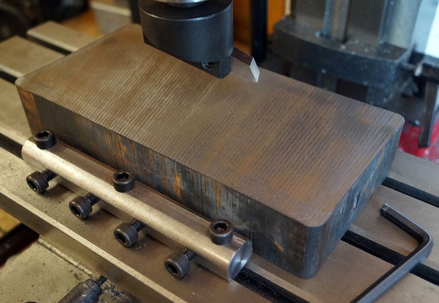

                                    Thinking about the machining I need to achieve a top and bottom face which are not only flat but true and parallel to each other, I am intending to flycut them and the blank is not going to be flat to start with. If I clamp to the table to machine the first side I can see it will spring back when its released. Should I shim it to the table to start with or is there a better approach.
                                    #393244
                                      I'd shim it up much like I would a casting.
                                      #393414
                                      Ron Laden
                                        @ronladen17547

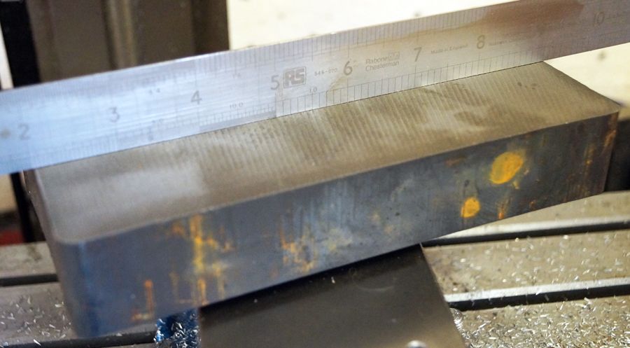

                                        Well I was not expecting this, today I received my first ever piece of cast iron from M-machine and its way better than I was imagining it would be. I dont know what type of machine they used to cut it but its nigh on flat, I can get a 3 thou gauge under the rule at one end and a 4 thou on the opposite side and thats over 7 inches.
                                        I dont know if this is the norm for cast iron but I was expecting it to be rough cut and no where near flat, really impressed with it.
                                        Edited By Ron Laden on 28/01/2019 16:57:31
                                        #393432
                                        John Rudd
                                          @johnrudd16576
                                          Ron, most likely been saw cut…they have a 'very extensive arsenal' when it comes to machinery….Their service and staff are unequalled in my book…The guys there were involved in the Tornado loco project….they do a lot of machine work for other local companies…,well worth a visit to their premises..

                                                    #393704
                                                    Ron Laden
                                                      @ronladen17547
                                                      Made up a low(ish) clamp bar for holding the cast iron lump whilst I flycut it. I dont have any square or rectangular bar so I had to make do with round which meant milling some flats. Its a pity the rear T slot is underneath the work as I could have done something similar there or at least a bolt down stop bar. I will have to find something that extends out from the ends of the work and clamp it from the rear slot.
