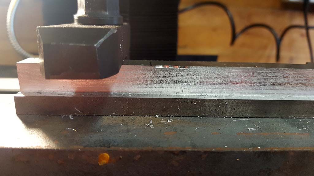

          Posted by petro1head on 04/03/2017 09:46:11:
          I removed the tool and took a couple of photos. oh dear its fooooked
          See above, use my tip about grinding the corners to 45 degrees then relieving them.
          Feeding a cutter too slow or taking too shallow a cut can rapidly blunt them as they end up rubbing not cutting and the tips do all the work.
          If you don't want to feed at manic speeds, slow the rpm.

            I'd get another HSS ARC one probably 12mm, one thing I do find with the ARC ones is that the shanks are a fraction smaller than other brands and they are loose in an untightened collet so you have to make sure they don't drop out and hit the table when fitting as this will chip the corners off.
            Either go 7mm wide and say 2mm deep or as Andrew says full depth and come in 1 – 1.5mm.
            #287085
              The advantage with full depth and shallow cuts is that you spread the wear over a lot more flute.
              The advantage with shallow depth and wide cuts is that all the wear is on the end so easier to resharpen the cutter.

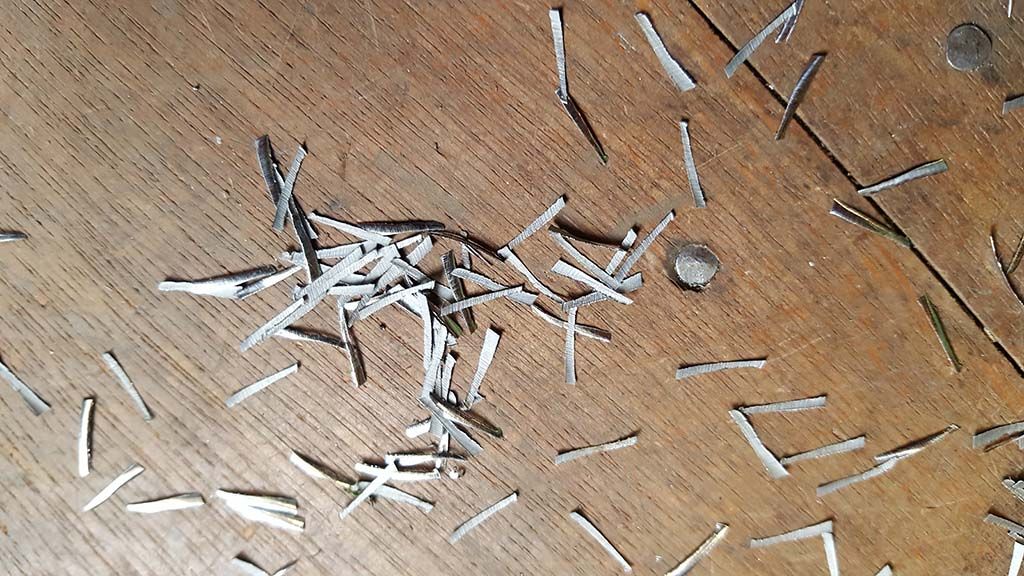

                Posted by JasonB on 04/03/2017 13:24:09:
                Thats what I did, finished the other side with no movement of the quill this time.  Have orders a replacement 14mm and also bought a 10 and 12mm roughing cutter
                Nice swarf?? Mind its bloody dangerous as it went all overe the floor and is very sharp

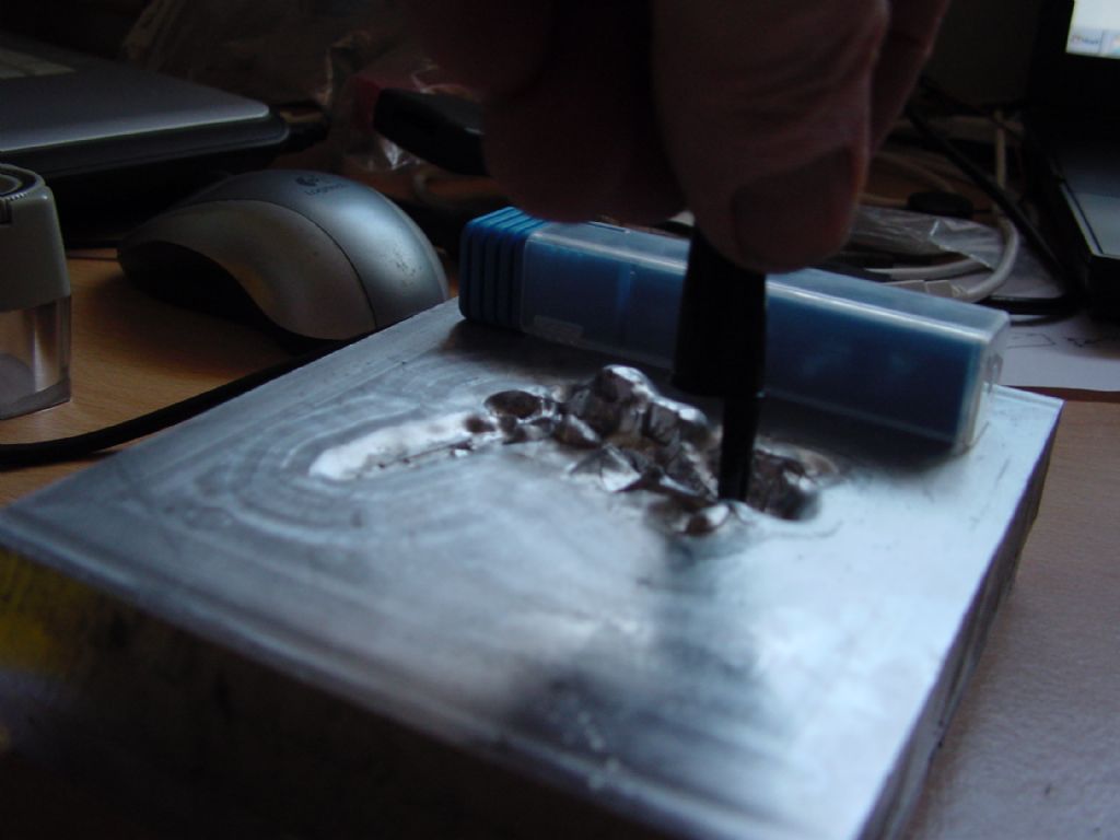

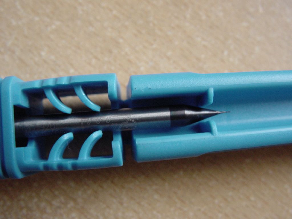

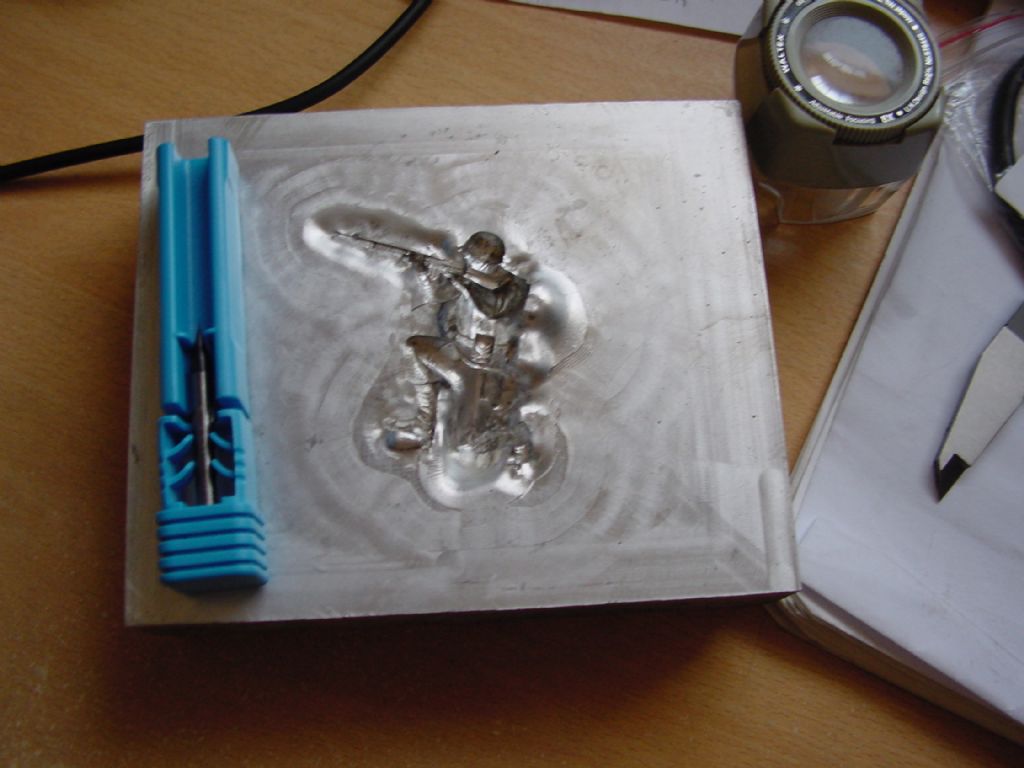

                Involute Curve
                  @involutecurve
                  Too true!
                  The rule of thumb is that if you have a spare cutter you won't break the first one. If you don't you will. The smaller the cutter the firmer the rule.
                  I've recently made some bevel gears using a 1mm ballnose cutter. In all 20 hours of machining with the same cutter; but of course I had a spare.
                  Andrew
                  I made a test piece a few years back for an injection mould tool here's a pic of one half, its quite dirty now and is only used as a paper weight but you get the idea, the finishing path was also around the 20 hrs mark, 0.3mm ball nose cutter these aint cheap!!, the figure is approx 52mm kneeling down, with an eye loop you can see the knots in his boot lases, I remember the split line was a nightmare to draw, bit it did shut off ok with no flash, I later went on to machine 20 odd of these in differing poses and uniforms………..
                  Pen top to show depth
