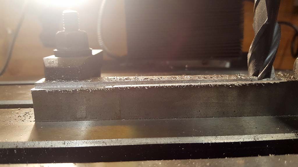

      Got my new mill and busy making some T nuts
      One side cuts fine but the other is tapering off the job
      The work is flat against the bed
      So any idea why what I am doing wrong?

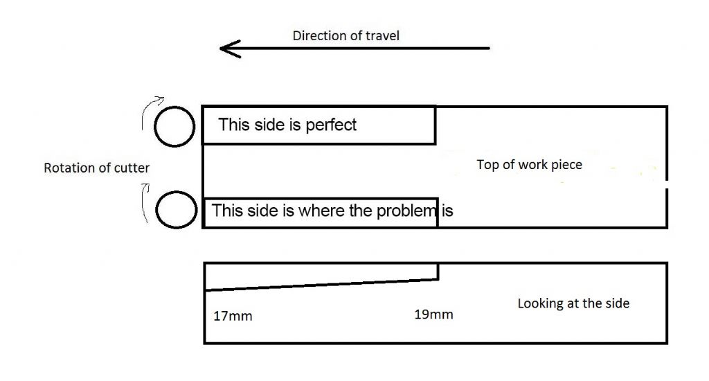

          Look up 'climb milling' that is whats wrong I am pretty sure.
          The bottom cut is correct but the top one you must go the other direction to avoid climb.
          You must always feed against the rotation of the cutter, same as a woodworking router.

            Looks to me like the cutter is blunt, this could be causing the cutter to get pushed up into the collet or push the quil up, also you should not really be climb milling as you depict on the top part of your drawing!, although with that amount of stepover you will probably get away with it.

              quill or z-axis not locked well enough?

                  If the diagram is the top view of the piece surly the one that is tapering up is the one that is NOT climb milling (ie the "bottom" one?
                  Stephen: surely if the workpiece was bowing that much you would see it? There looks to be a few mm taper on the cut but the bottom of the workpiece is still flat on the table?

                    Grrr, its a bugger you can't edit posts after a period of time.
                    I have redone the drawing for clarification
                    Hi Toby, yet its the bottom bit, hence why I redid the drawing

                      Cutter is moving up into the chuck. Better than when it goes the other way.
                      What type of toolholding chuck are you using?

                        It is good practice to lock all axes apart from the one feeding, what type of holder are you using to hold the cutter?

                            So the "good" side was the side you were climb milling on P1H – so that doesn't seem to be the problem here.
                            Basically, something seems to be moving for some reason. If the taper was in the other direction, I would suggest that the tool is being pulled out of the collet – but this seems to be the other way around. Even so, what kind of tool holder is being used? (not shown in photo) – as either the tool is moving in it or the spindle/quill is being pushed upwards l have to assume. So two things to find out – where is the tool "movement" and why is it happening.
                            What does the tool look like now and what feed/speed were you using when this happened?
                            Suspect blunt tool and collet not it holding tight enough…

                              As Neil says tool is riding up into the chuck/collet. Not helped by being a bit blunt.

                                  I am using these collets – **LINK** which go straight into the spindle and the supplied draw bar.
                                  Will check the tool however its brand new from Arc, HSS type. Spped was about 950rpm as per the chart I got off this forum. Feed, dont know Feet Per Min but not fast . I was take a .5mm cut. (when everthing is working fine could I take a deaper cut?)
                                  Being logical I would say either the tool is moving in the collet or the quill is moving. If, and it could well be, the tool was blunt I am sure I would be able to tell and it would still try to cut.

                                      I suggest you lock the head to the vertical dovetail(two levers on side) and the quill lever on left by quill.
                                      Also lock the Y axis when milling on the X axis
                                      I have a similar mill and everything has to be tight.
                                      The milling cutter is dull and you need to learn to mill conventionally

                                        Ok, when back in the hut to have a fresh look. Places the workpience on the table and wound down the head until the tool just touched the work. Then wound down the head some more to see if anything was moving and YES the handle for the quill was rotating. So I think thats the problem, I should have locked the quill Doooh!
                                        So thats to you guys I have learned something and will lock everthing aexcept the moving axis.
                                        ASF, what do you mean the cutter is dull? This is the cutter I am using – **LINK** At the time of buying I did wonder if I should have splashed out and bought Carbide but they were 3 x the price?

                                          Everything is lined up OK, and climb milling isn't the problem as the climb milled side has come out OK (assuming the diagram is right).
                                          If you are using R8, then (1) they need to be done up very tight and (2) the cutter has to be the same size as the collet (unlike ER collets R8 won't work with undersize shanks).
                                          You also need to be sure that both the head and the quill are locked in place.
                                          I suggest marking the position of head, quill and tool, then taking another trial cut to see what is actually moving.
                                          People are warning against climb milling, but it very much depends on how rigid you mill is and how tight your slides are and backlash is controlled. I climb mill on my wee X2.
                                          There is actually more vibration with conventional milling when the mill is set up right, which could be the cause of the movement. How 'happy' did the mill sound and feel when you were taking the cuts?

                                            I mentioned the cutter being dull because rather than a clean cut, the picture shows a rather messy burr as the cutter exits the workpiece. Inspect the corners of the endmill they should be very sharp. Cut (scratch) your nail sharp I would say. I am in the process of making a power feed for mine and a test today of a 12mm cutter (cutting full width) cutting 1mm depth was uneventful in mild steel

                                              Ah – the revised drawing make things clearer. Ignore my earlier post about the workpiece bowing, that's not causing the problem here.
                                              I agree with the other folks, it looks like the cutter's shifting or the table's shifting, likely because the cutter has blunted. As an attempt to provide suggestions (and no criticism intended), the following can really shorten the life of a tool:

                                                The chips look very small to me. You may need to increase the feed rate to do more cutting and less rubbing.
                                                Do you have a spindle lock? If not then trying to tighten the R8 collets tight enough to hold the cutter with enough force may be a problem.

                                                  I think you've identified the problem P1H – sorry used to horizontals (where the knee doesn't tend to move too much on it's own – and is sometimes hard to move when I went it too!)
                                                  If this is a new tool – then it should be fine. Even a sharp tool is subject to very high forces, so if your quill moves that easily – then the tool will most likely cut properly once it's held to the work (so to speak).
