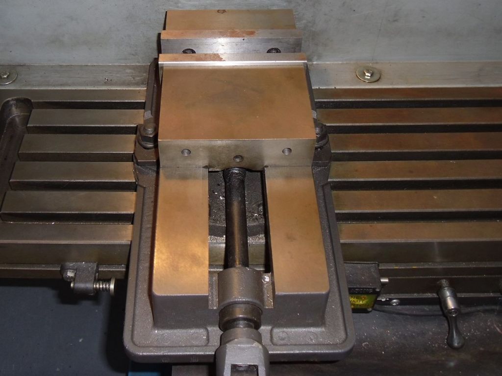

      Poorly made vice repair
      #593084
      Neil Lickfold
        @neillickfold44316
        I have a milling machine with a Free vice that was part of a package deal some 12 years ago. The owner said it needed these shims to try and square up the vice and he did not use it much due to it not being accurate. I have stripped it down over the weekend. It has no name brand on it to be seen. It looks like a Vertex vice but is not the quality of the only vertex vice I have seen.
        The base is not flat nor is it parallel , with a micrometer has an error of up to 0.2mm .
        The fixed jaw block is not parallel or square to the keyway slot. It is a good fit to the keyway though and the key fit to the base is good. They got that part right. The fixed block error is around 0.15mm out of parallel from the bottom to the top. And then over the length has a similar error of 0.18mm.
        The moving jawblock has similar errors to the Fixed jaw block but over a loner distance.
        When the vice was all assembled, it all looked very nice, with hardened jaw insert that all aligned up about even for height and width when closed, but did have a funny looking gap at the bottom.
        I have done No investigation to the swivel base that has come with the vice.
        My question is, what is the normally acceptable run out on a milling vice for hobby use? This is a large vice with the Jaw width being 6 inches and has a swivel base as well. I found a picture of the vice.

          Better than that Neil. I own two hobby vices and they're both flat so far as I can tell.
          However, I don't expect mine to align accurately with the table slots. Instead, I fine tune the alignment with a Dial Indicator on the fixed jaw by tapping the loosely nipped vice with a mallet, tightening up when it's straight. There's room to align the vice because my bolts aren't a tight fit in the slots. I can get the fixed jaw straight better than 0.01mm over 100mm, or at least what my DI believes is 0.01mm. Pretty good anyway.
          I'm not sure your other measurements matter. The vice should be OK provided it's fixed jaw is aligned with the table, and it's front face is flat, and the area the work rests on between the jaws is parallel to the table.
          The funny groove sounds like a stress relieving feature. One of mine has it – makes it hard to position thin work, but annoying rather than a show-stopper.

            Posted by Neil Lickfold on 05/04/2022 20:34:34:
            It depends really over how great a distance you're measuring and what the end user himself deems acceptable for his own purposes.
            Some of the vices sold for hobby use quantify the level of precision you can expect them to meet.
            Eta: I'm not sure what Neil and Dave mean by the funny gap/groove. Could we see a picture? We're not talking about the swarf gutter* beneath the fixed jaw, I take it?
            *I'd always assumed it was primarily a swarf gutter and not a stress reliever. Maybe I'm wrong.

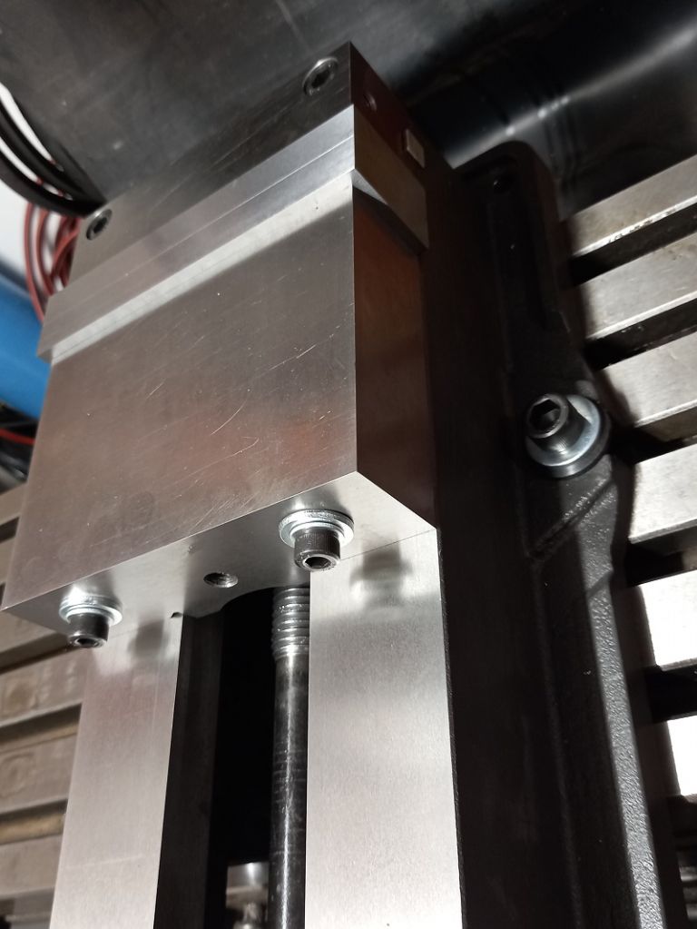

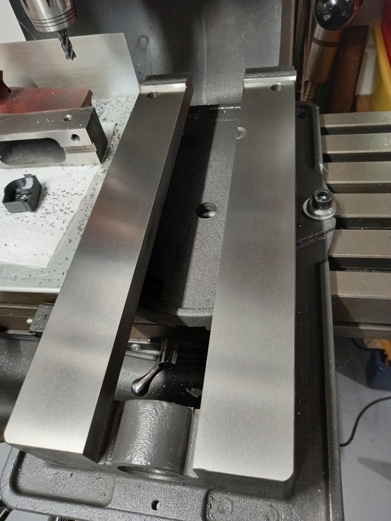

                            I got the base ground flat to better than 0.01mm so am happy with that aspect. The top part was quite true, only about 0.03mm or so deviation. But the base took 0.3mm to clean up in the end. I also ground the sliding jaw parallel surfaces and the fixed jaw parallel (The one that is fixed with the keyway) and the top side. While at it made them both the same thickness. After cutting down the pressed in 10mm keys, I just discovered that they are on two different angles and neither makes sense as to why it is this way.
                            Is there any specific reason for making the keys on different angles ? The only one I could think of was to preload the fit of the fixed jaw to the vice. It will also explain why the original keys were so radiused on the top of them.
                            This project is not really worth it, I should just go and by one of the better made better materials, branded vice. But I have started now and don't like throwing away things that could be salvaged.

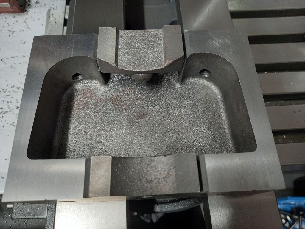

                            Here is a picture of the base and the fixed jaw. Another is of the moving jaw that required 0.07mm to clean up the underside that was a mill or flycut finish in a hurray.
                            Ground moving jaw-Minimum cleanup. Milling marks as a witness still. Vice edges will be left sharp as a wiper against the swarf.

                                I did it after hours on the works grinder. They have 2, a small one that has a nice set if magnetic blocks, and a bigger one that is most often used. The rest of the work I will do at home on the refurbished quill HM50 mill. Looks like I need to look at the gibs all round for the mill too at some point.
                                Thats a good point that I will know what I have actually got too. It may have to only be used on finishing work or light duty stuff to help it keep its accuracy.

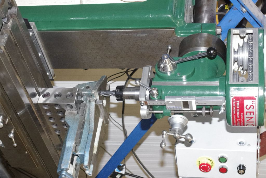

                                      The solution if you don't have access to grinding is to set up a 1-2-3 block, or better still a 2-4-6 block parallel to the X axis and clamp the vise upside down to the block. Put parallels on top of the block if the jaws are too deep. _igp2463.jpgThis should square up the rear jaw and vise bed. Then skim the underside of the vise, having removed the swivel base first. This should be fine for home shop use, most vises are only milled underneath.
                                      #593264
                                      Neil Lickfold
                                        @neillickfold44316
                                        Thanks for the input . All ideas are appreciated.

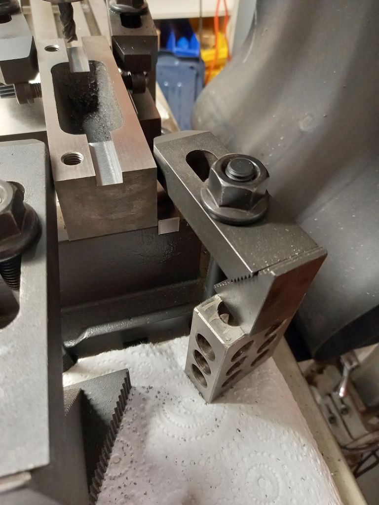

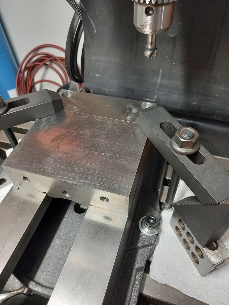

                                        Once I get the top side sorted, this is how I intend to do the key alignment for the base of the vice. I still need to get the top sorted yet. What I am going to do for the top fixed jaw is to just put it back like it was, and mill a reference clean up cut while I have the run of the base true to the table. Then place the jaw onto the angle plate and cut the jaw parallel and square to that reference face and then make it parallel. Will also square up the end faces and tap them for setting stops etc as well. After seeing Stefan's video and how he has tapped holes in the top of the vice, to hold round stock secure etc, I will do the same and then make some covers for the holes when not in use.
                                        With these soft castings, I can see why the old school millers used 4 clamps to hold the vice and not the slot and 2 tee nuts.

                                          Even the hard jaw sets are out of parallel buy 0.06mm over a short width of 44mm. One jaw is .04 short one side and .05 short the other side, so kind of like a twisted board. But one side feels flat , while the other side feels warped and rocks on the table. It looks like the only part that has not needed attention is the screw and nut. Lucky that I have access to a surface grinder to be able to fix the hardened jaws. One test I will do is to see how much it all moves when it is done up with a block in the vice. The error on the fixed jaw is going the wrong way to compensate for any load on the vice tightening up though. It is larger at the base side than the top side by about 0.04mm over it's 40mm height.
                                          As an update, the keyway will get recut to the larger 12mm key stock and then an extra set of screws will clamp the fixed block down , but will be M10 capscrews drilled from the top. Just can't be bothered turning over the vice to drill and counter bore the holes from the bottom through what would be a partially interrupted counterbore as well.

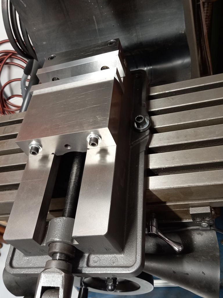

                                              Neil Lickfold
                                                @neillickfold44316
                                                Some more pictures of the rebuild.
                                                After cutting the Keyway slots to take 12mm keys in the base, upgraded the slot on the fixed jaw to take the 12mm key and used the newly made keys to be the reference for cutting the fixed jaw.
                                                Added two more m10 hold down positions on the fixed jaw while it was all set up. To go from the underneath side was going to be too awkward.
                                                Back bolted jaws are much easier to allow for re alignment if the jaws are swapped to one of the ends like when doing wider work holding.
                                                Finished vice with the M8 end stop holes on the side of the fixed jaw. The moving jaw and the fixed jaw are the same height for when wide stock is being held down. I still have not yet put the top clamp holes in the moving or the fixed jaw yet , like Stefan has done with his vice. I was going to wait until such a job arose and then decide on one centre clamp tapped hole or to have two holes either side of the centre. The base runs very true to the table of the mill now, and the jaw is now square to the base of the vice.
