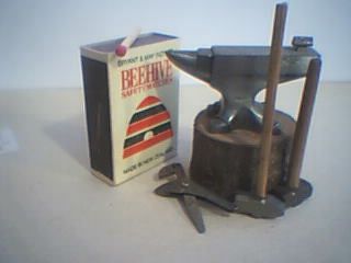

                                              Ian S C
                                                @iansc
                                                In many places where the ‘experts’ use the milling machine, I find it just as quick, or quicker to set up in the vise and take the piece of metal to size with a file, and if need be a hacksaw, in the latter perhaps the bandsaw, or with the anvil, a drill. A bit over an hours work, it lives in a miniature workshop with other tools, a lathe and a drill press driven from a line shaft.  Ian S C
                                                Edited By Ian S C on 05/03/2011 10:12:17

                                                  mgj
                                                    @mgj
                                                    Lovely work Ian
                                                    I do actually work to great accuracy – more than is needed , but that is just a natural caution against having to do it again – or bodge about getting it to work.
                                                    I admire the filers and cold chiselers, and the pattern makers too. They are far more skilled and patient than I. I suppose I just enjoy using machine tools. I don’t design any more, (all that rithmetic strains the brain)I just want a sound workable set of drawings,something with dials, and a thing that works well at the end. Bliss!!!
                                                    Edited By mgj on 05/03/2011 15:36:45
