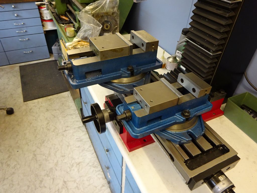

                    I recommend the ARC Euro "versatile" vices Jason shows above. The 100mm suits my WM16 fine, although maybe a little on the tall side for a WM14. While some of the other ARC machine vices are lower, some need custom made clamps to utilize their full potential.
                    #644209
                      The "SG" versatile ones have a bit less rear overhang and being that they don't have a fixed lug to hold them down can be slid forwards and back as needed.
                      The swivel bases shown in my photos are best put in a cupboard and only taken out for thw odd occasion when they may be needed which saves on height.
                      There is always the option to mount lengthways too

                        I have a 80 mm vice that is 65 mm high. I use it for most jobs. For large stock, I have a 100 mm vice that is 95 mm high. I can only use it with short mill and drills.
                        The rotary stand for both vices is only place when needed. It just takes up to much space and makes the vices less rigid.

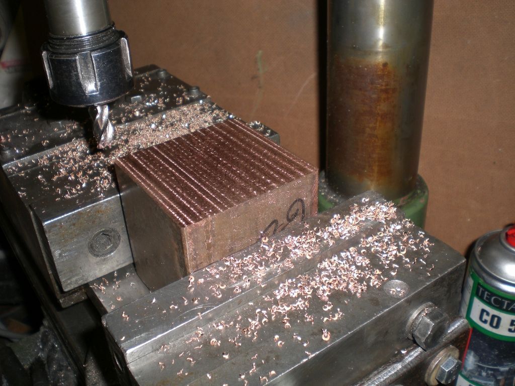

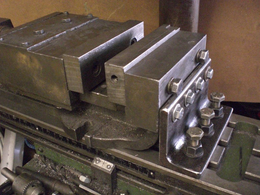

                          Hi Stephen, like JasonB says, you can put a big vice length ways on your table, just like I did with this rather over the top one I used on my old Chester Champion machine a few years ago, so that I could hold and mill a 3" cube of ally-bronze, although I did have to make and fit the piece of angle iron bracket to hold it down, because the two side slots couldn't be used, and I didn't have anything else big enough.
                          Regards Nick.
