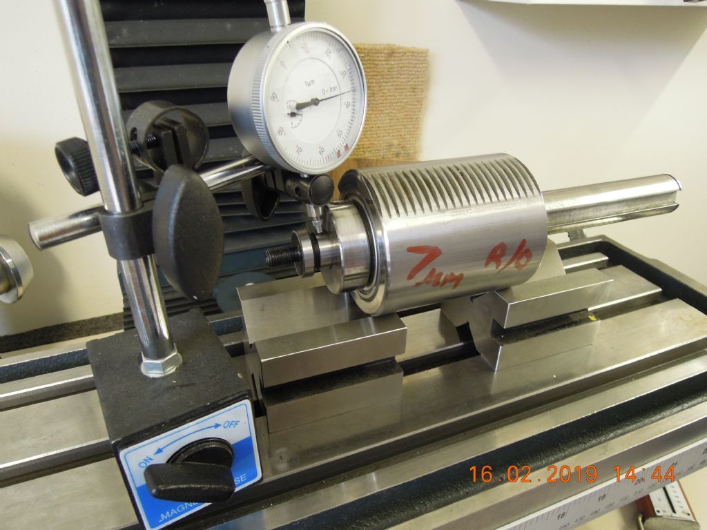

                                        Ive started to strip my mill and inspect the parts to see if I can improve the rigidity. The head is off the vertical slide and the spindle is out of the head.
                                        The first thing to become obvious was that the clamping face that goes against the slide was far from flat !!!
                                        When I put the casting on a flat surface and it rocks right and left. The finish of the face suggests its been on a linisher instead of being ground ! Extraordinary! Witness marking on the face confirms erratic and one-sided contact with the slide.
                                        Whether it has always out of flat or has warped over the ten years or so that I've had the mill it I'm not sure. But I suspect the former based on the dreadful linished finish.
                                        So the first thing I need to do is get it face ground. Does anyone know of a good place to go in the Leighton Buzzard / Milton Keynes area please ?
                                        The quill is a clearance fit in the cast head of course and is clamped on the lower edge only. Clearly this doesnt help with stabilising the upper portion of the quill due to the 'cut' not being completely through the body. So Im thinking of completing the cut and fitting another clamp bolt at the upper position. I'll have to move a screw hole of course but any thoughts on the wisdom of this modification ? I can think of a few risks which might or might not be manageable but I welcome your thoughts on whether I should be so drastic.
                                        Inspection of the spindle threw up some surprises too. It spun smoothly with a nice uniform 'hiss' typical of well preloaded-bearings. I put it on some V-blocks and tried to measure the runout. After the struggle of getting the DI into the internal taper I could confirm this to be around 2 microns.
                                        I did initially try measuring the spindle runout on a chuck inserted into the spindle. This produced variable results of up to 7 microns. Playing about I found the cause of the variability was micro-movements of the chucks taper in the spindle. Small differences in taper angles and other geometric non-uniformities was allowing the male part to rock. I hadn't used the drawbar to pull in the chuck and that might have helped reduce the rock. I'm pretty sure though it wouldn't have eliminated it completely. Clearly there are MT2 tapers and there are precision MT2 tapers !
                                        Another interesting and unexpected characteristic of the spindle was that applying a few Kgfs of load to its nose caused not only elastic deflections but some semi-permanent deflections too. The latter were in the order of too 3~4 microns which was a bit concerning at first. I then found that with the tiniest rotation the spindle returned exactly to its origin. Clearly there is frictional hysteresis in non-rotating ball bearings too. I have spent years in bearings and didn't know that !
