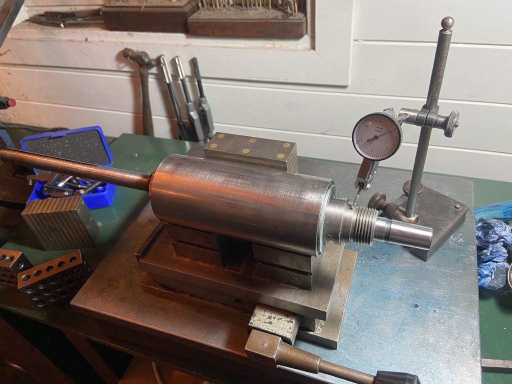

      Hi
      I noticed the other day that my Dore Westbury mk 1 spindle was loose vertically, so I took it to bits to investigate and tighten it up. While doing this I thought I’d check the runout before I put it back in. I have some 0.0001 clocks these days, which I didn’t have when I got it.
      I found that it was about 0.0025 which obviously far too much. I’ve tried with various amounts of tightening of the preload (?) nuts and it doesn’t seem to make much difference. I’ve tried measuring it at the (point where the spindle exits the quill?) and also with a test bar in the mt2 socket, same results.
      The spindle doesn’t have a very good finish (home made obviously). But I’m not in a position to remake it as it’s too long for my lathe.
      The bearings look ok but there is some unevenness and roughness when turned manually! Which seems to correlate with the runout,
      How do I tell if it’s the spindle or bearings at fault? The bearings are expensive and I don’t want to get new ones if that isn’t the cause,
      im getting a nice new surface plate next week, it would be good to know what measurements to take to check out the spindle, if anyone has any ideas.
      pic below
      thanks
      Steve

          If "there is some unevenness and roughness when turned manually" and this is at a low preload, the bearings ar worn or damaged.
          You should measure the runout at the inside of the spindle taper. If that is not possible, then on the outside of the chuck taper.
          If you use a drill chuck (not a collet) than the runout of the drill chuck is probably more than the runout of the spindle.

            I agree with Huub’s analysis, but would also mention that if “The spindle doesn’t have a very good finish” then you may still be disappointed with the result of a bearing change.
            My ‘working hypothesis’ is that inherent runout in the spindle has abused the bearings.

                Mine had a lot of issues. The bearing end faces were not true to the run of the spindle barrel or bore. I have some pics of correcting the barrel.

                  Well, eliminating the thust bearings altogether I stuck the spindle on some V blocks on a mag chuck, aligned with a parallel.
                  On the nose, I again see the 0.003 runout….
                  Runout at nose
                  On the bearing surface (which has a much better finish than other surfaces, Both bearing areas are exactly 0.999 diameter.) <0.0005 runout. Within expected tolerance.
                  Runout at bearing
                  Unfortunately I think I have to conclude that when it was made, it was turned around, either in a chuck or between centres or something and wasn’t perfectly realigned. So I’m not sure there’s anything that can be done, the Morse taper is simply not aligned with the axis of the spindle. Spindle itself is running true.
                  Any brilliant ideas very welcome.
                  Steve

                    I think the spindle is damaged during use because It is likely the bearing and spindle are machined in one fixation to avoid runout.
                    You could repair the seating of the nose and/or the taper on the lathe!

                            The ‘obvious but not trivially simple’ thing to do would be to re-finish the register and the socket in situ
                            … use the spindle assembly as the headstock.

                              I can see how to do that…. But it has an MT2 taper (constantly used) and a myford thread (less used). Those are the bits that look tricky to me. I have an Mt2 reamer. It could be possible that if held rigidly enough it would “centre itself” and ream the taper centrally if advanced a little further than it currently is. But it feels like a bit of a long shot.

                                Regardless of runout, if clean and dry bearings have any feeling of unevenness or roughness, or noisiness, they need replacing. They must be immaculately clean and dry though. Wash in clean solvent and dry with compressed air.
                                If the bearing roughness seems to coincide with the runout, that is quite likely your problem.

                                  To prove if it is the bearings at fault rotate the spindle in a matched pair of vee blocks. The bearing registers resting on the vee block. If you get the same run-out it as was present in the assembled spindle and then it is not the bearings.
                                  Also put a clock in the centre between the bearing registers and see if there is a high spot. Mark the high spot with a felt pen. Move either side to see if the readings are the same or less.
                                  If the readings are the same magnitude then it will be safe to assume this portion is running out from manufacture.
                                  If the readings either side are occuring at the same point but are less then the spindle may well be bent.
                                  If the high spot in the centre is opposite the low point at the Spindle nose then this would confirm it.

                                    I did notice in the videos that the lever of the indicator didn't seem to be tangential to the spindle, that would give the best figures. Could you also mark the high spots and do a third test on the MT tool in the spindle taper.
                                    It would be possible to have the journals built up with nickel plating or metal spray and then re machined true, the surfaces would have to be reduced in diameter by about 0.01" first. It might also be possible to find bearings with a slightly smaller bore, but that would depend mostly on how lucky you are.

                                      Point 1. I'm not sure magnetic mounting is the ideal for this test.
                                      Point 2. Do you not just need to remachine the 2 Morse internal taper with the spindle running in it's own bearings? It has got to be spot on after that.
                                      All that said, it's not terrible and I would say the machine is perfectly useable as it is.

                                        The main spindle ran beautifully, with a decent standard of workmanship, but the internal taper for the grinding wheel arbor was off centre.
                                        I cleaned all components, and re-assembled the spindle into its housing; the housing is essentially a bit of steam pipe bored out to suit, with bearings at each end.
                                        I then set the housing in the lathe using two fixed steadies, and clocked everything to centre height, square etc.
                                        I used the lathe chuck to drive the spindle in its own bearings, and re-machined the taper.
                                        It's only a short taper on that so a fairly simple job.
                                        Whilst the top slide was set over, I also made a load of spare arbors with a matching angle.
                                        In your case, you could do the same thing, but that would leave the external chuck register wrong, and maybe the Morse tapered hole too deep.
                                        You have a drill chuck arbor there, which is likely to be concentric and accurate, as well as being centre drilled.
                                        Is the outer chuck register off in the same direction as the MT2 internal taper?
                                        Also, using a test bar, is the taper parallel to the axis of rotation, but just off centre?
                                        If so, how about removing all of the outer components of the quill, add the arbor into the taper, and run the centre main spindle between centres.
                                        You could then re-machine the spindle's surface(s) where they touch the main bearings.
                                        A shrink fit, or loctite'd sleeve could be added and re-machined concentric.
                                        You might get lucky and find a speedy sleeve to fit to make up the difference.
                                        Another possibility might be to convert from imperial to metric bearings or vice versa, and re-machine accordingly
                                        It is possible to carefully re-machine a very small amount off the inner or outer diameter of ball/roller bearings.

                                            I'm with Old mart, the angle of the Dti lever does not look right, I tend to set the arm at right angles to the movement I'm trying to measure. Would be interesting to see what it measures with either the whole Dti horizontal or move the lever so it's horizontal.

                                              Whilst it needs to end up as mt2 (probably) it doesn’t have to be mt2 whilst fixing it.
                                              I would bore the spindle to a suitable cylindrical diameter (probably large end of mt2 ish)
                                              Then loctite or shrink fit a plug in and finally bore and ream that using the spindles own bearings.
                                              Probably worth replacing the bearings whilst your doing it – modern new bearings of reasonable quality are not expensive and are sufficiently accurate for the job.

                                                I think with the arm set tangential to the surface it's trying to measure the runout will be a lot less. I'd do the test again
