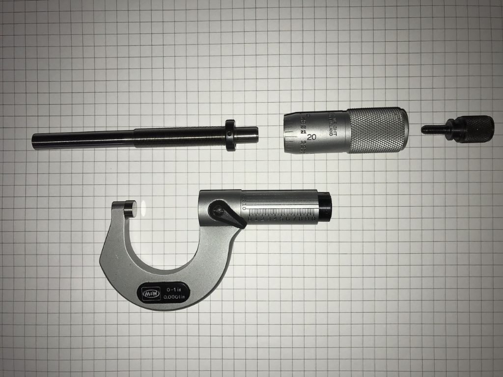

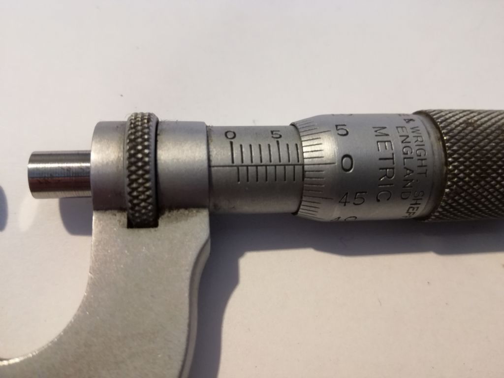

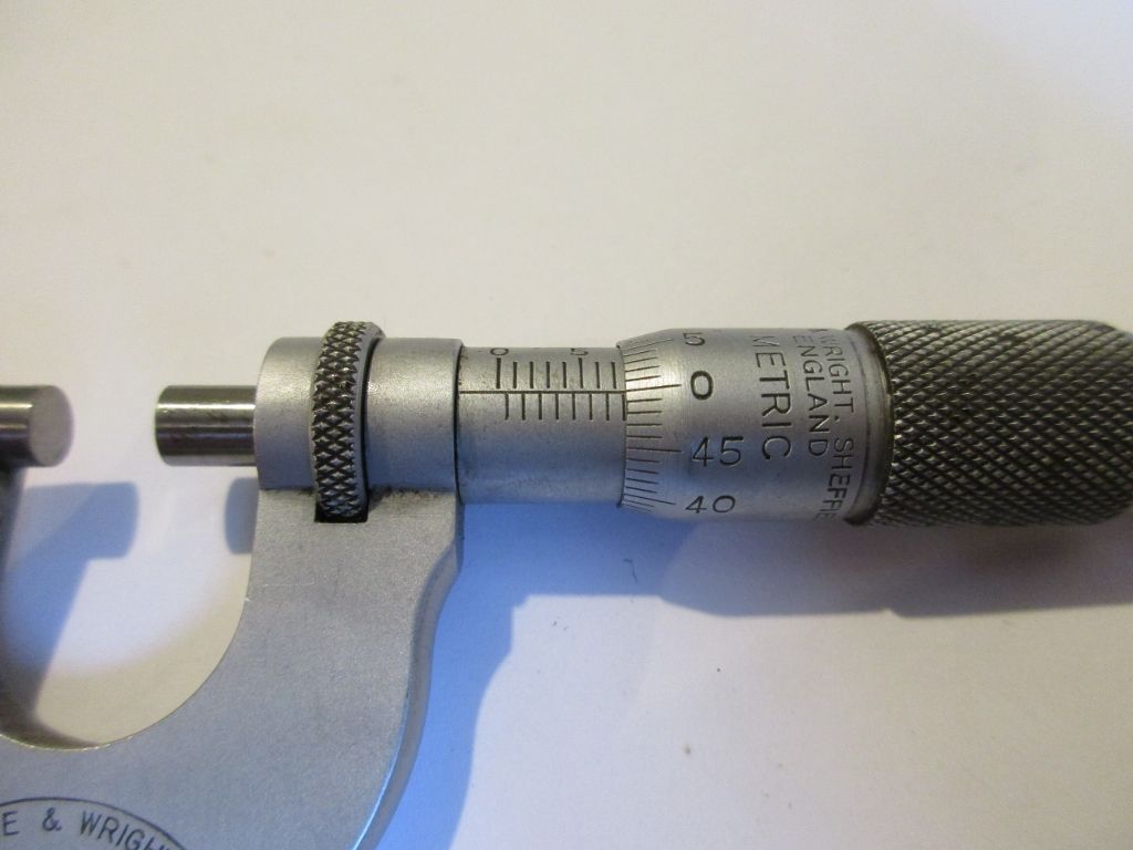

      Hi, I've had the same problem with a Moore & Wright 0-13mm mic.
      Very difficult to see the markings without a magnifier and then had to look at it at a slight angle from the left.
      Well this morning I've cured the problem by removing the sleeve and taking a smidgen off the head end of it while holding it in my collet chuck and then refitting it back onto the mic and placing the datum line in a more central position. I then had to loosen the screw holding the thimble and tuning it up slightly to bring the zero mark back in line with the datum line when the mic was closed to zero.
      I can now read the mic clearly seeing the marks just with my normal glasses on and looking at it face on. Much better.
      Personally I don't see how this can affect the accuracy of the mic, because there has been no interference with the measuring components. In my mind it is no different to shifting a zero point on a DRO.
      Regards Nick.

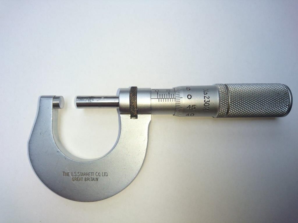

            Before everybody starts machining their mics, check that it is not adjustable like this Moore and Wright. The thimble position can be adjusted by the black nut shown on the spindle here, the thimble is released by unscrewing the ratchet. This probably doesn't apply to Nicks 13mm mic as it is a compact thimble and likely to be like the Starrett I pictured.
            Mike
            #293326
            Nicholas Farr
              @nicholasfarr14254
              Hi Mike, my 13mm one has a cone on the ratchet that engages into a corresponding split cone in the spindle, which opens it out into the hole on the one piece thimble.
              Regards Nick.

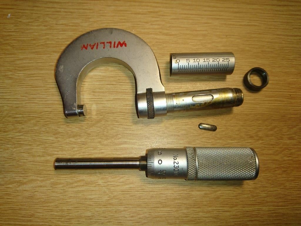

                Seems like it's Easter Egg Holiday Micrometer Modifying Friday!
                In between toasting hot cross buns, I too have been modding my micrometer.
                Here's the sleeve dismantled:
                The brown crud on the inner is dried oil. Carburettor cleaner is wonderful stuff…
                And here it is after taking 8 thou off the LH end of the scale sleeve and re-assembling it.
                I did it by holding the sleeve into a 12 mm collet and popping it into the T&C grinder so I could control the amount of metal removed. Is it fixed? – time will tell!
                Now, why has the toaster caught fire…..
