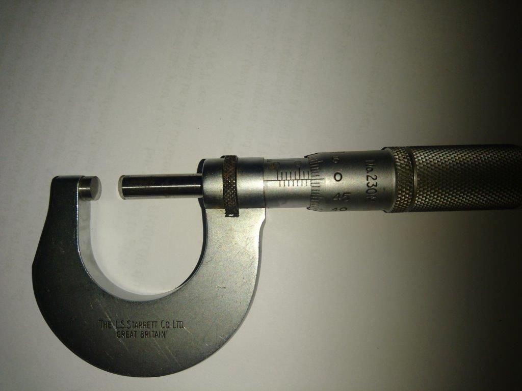

        Good evening everyone, after some advice please.
        x
        I find this quite difficult to read, as the fiducial line is inside the thimble. This presently reads 7.50 mm, but the 0.5 line is obscured by the thimble sleeve. It can be quite confusing particularly at intermediate settings.
        So is it possible to move the thimble about 0.2 mm to the right on the spindle? How is the spindle held in the RHS of the thimble?
        How many heart attacks would I be responsible for if I took the angle grinder and took 0.2 mm off the left end (scale end) of the thimble, heretic that I am?
        Thanks as ever in anticipation of The Knowledge!
        Simon

          Looks perfectly normal and correct to me. If you really hate it, get a digital one.

            With your picture viewed full size in your album it is clearly seen reading as 7.50mm, don't forget you only see halve of the line width. I sometimes have to turn the thimble a bit to check exactly before turning back to the measured position.

              I can just see the line peeking out from under the thimble. You might try disassembling the mike to see if the graduated skeeve can be slid toward the frame. On some mikes the sleeve is just a friction fit. It might also be possible to stone off the end of the sleeve to allow it to slide to the left (according to the picture). I like the Brown and Sharpe mikes with the slant line graduations.

                Hi Simon it is possible that the sleeve has worked is way to the right and using the adjustment C spanner rotate it and pull further to the right clean the gap then twist and push it back and adjust and calibrate to check size. It is tight fitting sleeve but only use the correct spanner.

                  All my mics look like that!
                  Always thought it was correct.

                    Looks perfectly normal to me too, you can see daylight after the 7mm mark, so it's obviously not 7.0mm. Having said that, I hate metric mics, I've lost count of the number of times I've made something exactly 0.5mm wrong. Eventually you'll get used to it. I''ve bought a digital mic, but I hardly ever use it.

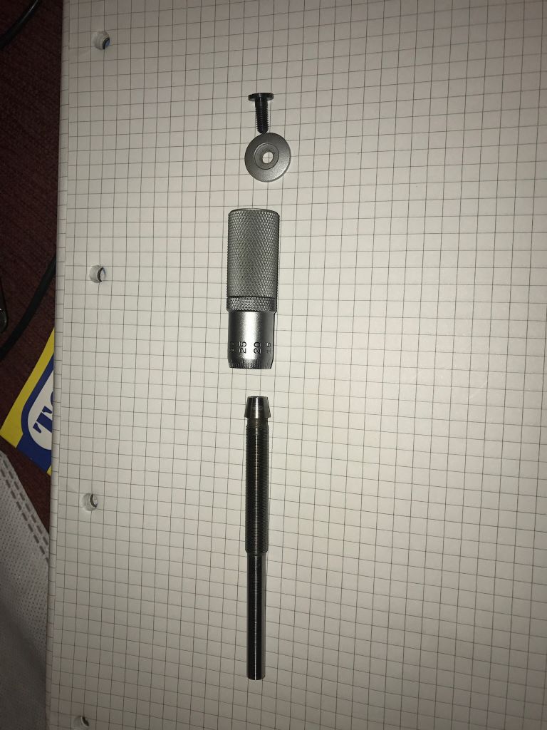

                      Take a look at the youtube channel mrpete222 Shop tips #302 he stripped down a mic and lightly skimmed the end of the barrel opposite the thimble so more of the line was showing as he had troubles seeing it when most of the line was under the thimble .

                        If it makes it easier for you, just skim the barrel.

                          I agree with others, this is normal. I have found over the years that it takes practice and a basic knowledge of how the things work to use instruments consistently, just keep using it and thinking about the reading until it becomes second nature.

                            MrPete222 on YouTube has a video on rectifying this issue here… **LINK**

                                Looks spot on to me.
                                Send it to me and I will replace it with something which would be easier for you to read. I think I may have something that reads to the nearest 0.1mm with an accuracy of about one digit.
                                As there appears to be only one reading among so many that troubles you, I think there is no reason whatsoever to consider potentially destroying such a precision device. Live with it and learn how to use it, is my advice. You clearly know where the 7.50 reading occurs, so what is the real problem?

                                    I have had mikes worse than this but it is annoying, skimming the barrel end is about the best option if it bothers you that much.

                                                    This style of construction has no adjustment for positioning the thimble on the screw, it may be preferable to alter the sleeve rather than the thimble but I would be disinclined to do either. Reading the mic in the position shown the line is partially obscured but I tend to hold a small mic with my little finger through the c frame and third finger clamping it in my hand, thumb and forefinger to turn the thimble. In this position you tend to have the thimble vertical and looking into the joint between thimble and sleeve and the lines are much more visable. Moore and Wright mics can adjust the position of the thimble as it is clamped between a nut and locking screw so you can choose where the lines show.

                                                      Well, many thanks as always to all those who took the trouble to reply, it's been hugely entertaining watching this develop over the course of the last 24 hours or so.
                                                      There seem to be three schools of thought –
                                                      1- don't fix what aint broke,
                                                      2 – you're going to make it a whole worse
                                                      3 – I've been there too.
                                                      The back story is that I bought this mic' back in the late 70's, and have hardy used it since, because I've never learnt to read it reliably. I'm not sure I understand why the same is not true of almost all of the imperial mic's in my toolbox, but this one seems particularly obnoxious. To me.
                                                      I was sorting twist drills yesterday, and took to this one to see if I could get on with it, and decided the answer was no. So I might as well modify it as throw it away. Yes, I completed the job using a digital mic', but there are times when a tidy little thing like this is easier to use.
                                                      Tubal Cain's video gives me some hope that I'm not going doolally – well probably I am but it's nice to have company – so thanks for that link, and particular thanks to Mike Poole who seems to have dismantled a perfectly good identical mic' just to show me what the internal arrangement is, which was my original question. I'm still humming and hawing over whether the game's worth the candle – but I've just worked out how to get the sleeve off so that gives me the option of taking a lick off the heel of this instead of the thimble. Less likely to get grinding dust in the measuring thread.
                                                      I'm keeping schtum about whether my metaphorical angle grinder is the way to do the job. I never said I was going to plug it in!
