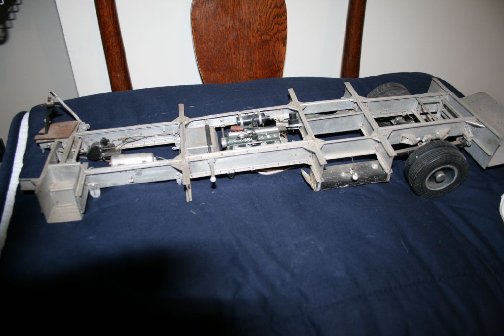

      I'm trying to restore an old model bus chassis . Pretty sure its a Harrington Contender Integral chassis .. with a Rolls Royce B80 petrol engine . Who ever built it was a fabulous modeller . Perhaps it was for a motor show display . However , I guess it has been dropped .. It's constructed as per original , aluminium and rivets … 100's of them! And quite a few have either pulled through, or just missing .And the chassis is flopping about .. They're about 1mm dia..and iron.. A lot of the ones that need replacing , are in an awkward place ..
      I don't suppose there's a tool , i 'm imagining something . say like a stapler..or a goose necked stapler .. or something like a leather punch shape .. that could set a rivet ? Any ideas ? If not , i'll make a snap and set , but it'll be bloomin awkward ..i'll have to get another pair of hands to hold it !! I don't really want to just glue it back together . Thanksimg_4894.jpg

        #524423
        Hacksaw
          @hacksaw

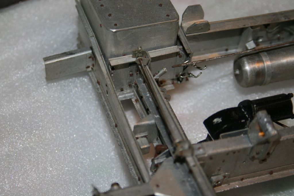

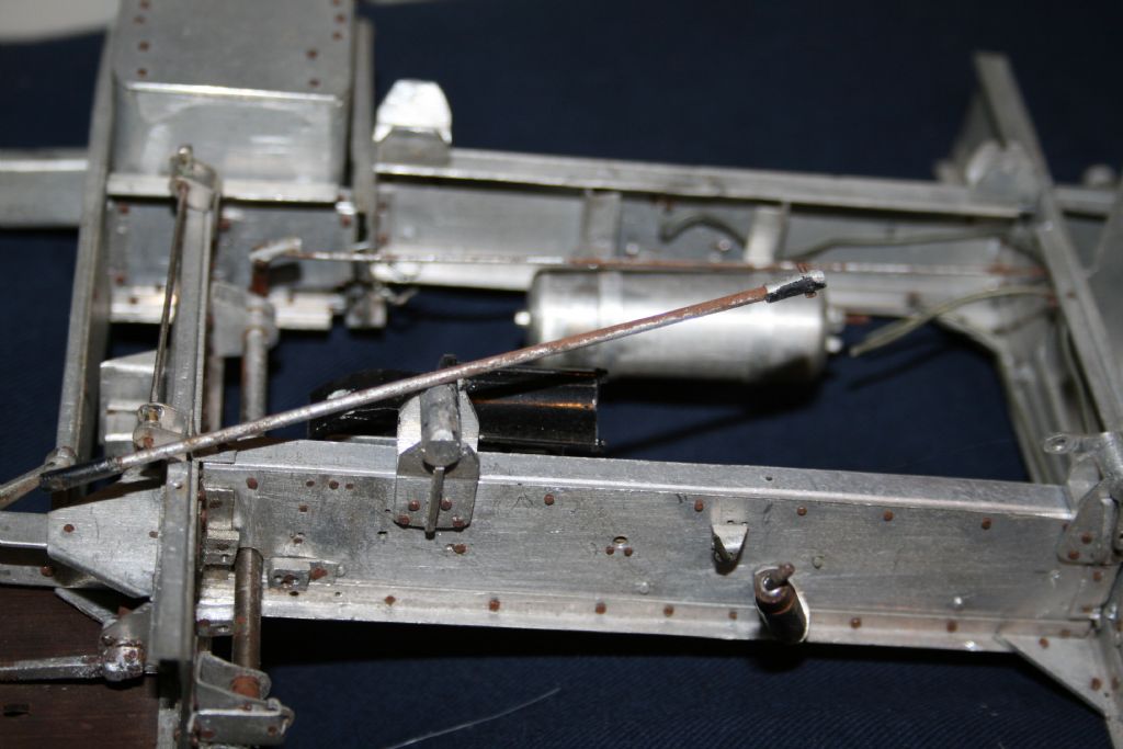

          Here you can see twisted wire holding the crossmember together ! How the hell am i going to re -rivet that !

              It appears there is a bit of room to swing a hammer if you remove the round tank.
              You need to make a support (anvil) to hold the rivet head while the opposite side is formed. Perhaps a solid piece of steel with a half round hole in the end to match the rivet head profile and clamped in a vice. Then with the chassis held vertically and the rivet head supported, set the opposite side. A centre punch with a concave end (used for punching nails) is all you will need as a snap..
              Your idea of something like a stapler would also work but would have to be much stronger to squash a rivet. Perhaps using a pair of vice grip pliers and modifying the jaws.

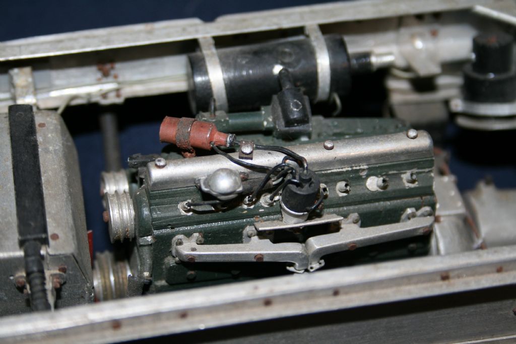

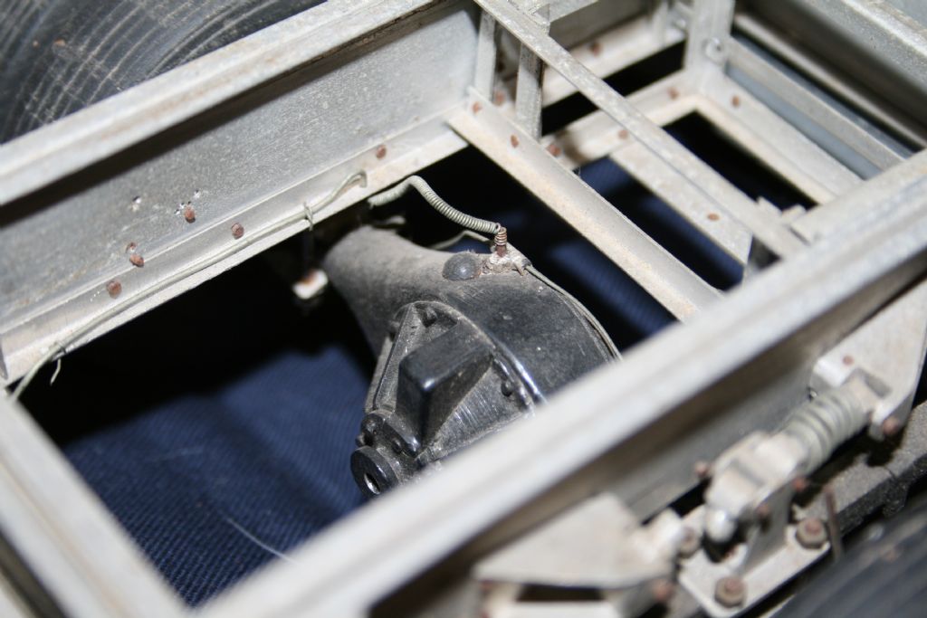

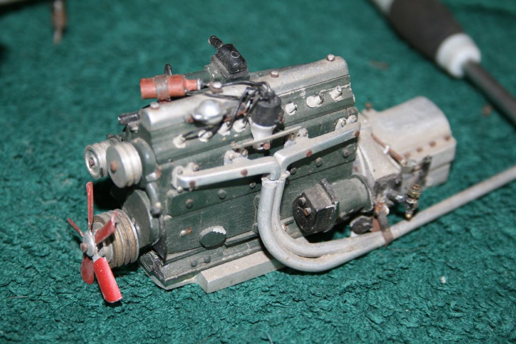

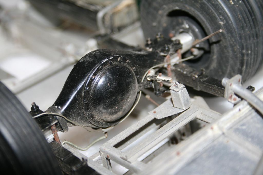

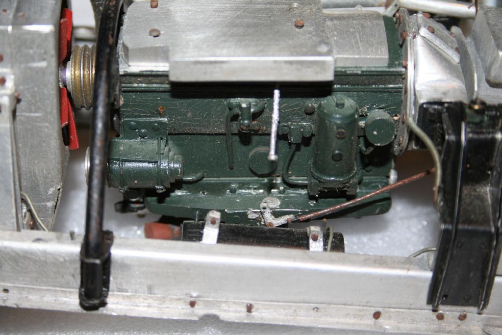

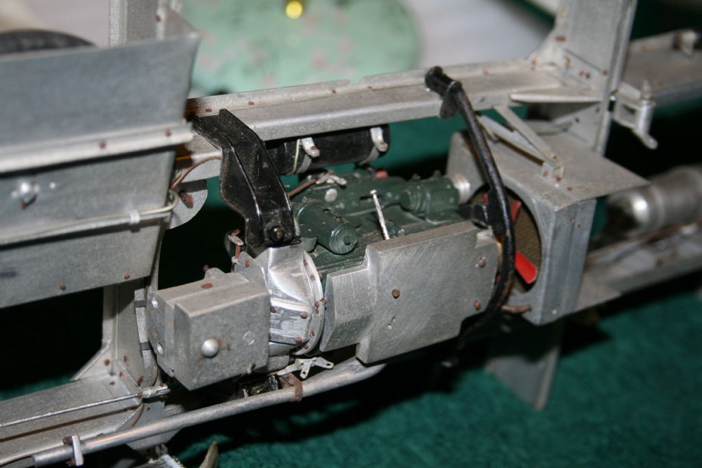

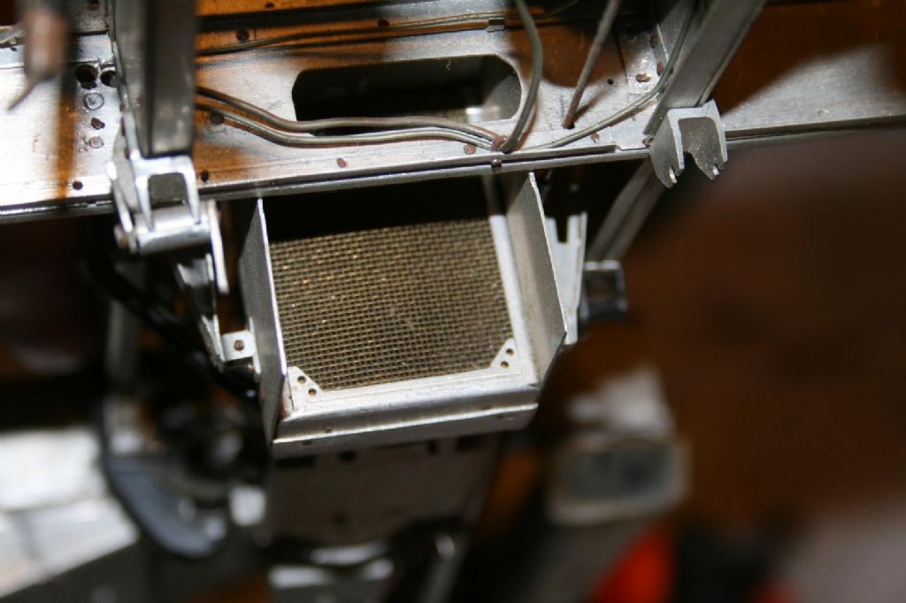

                              More pics
                              sump side of the engine
                              Axle
                              Fan side of radiator ,engine and gearbox mount . Dipstick ..Pulleys and fan do actually rotate !

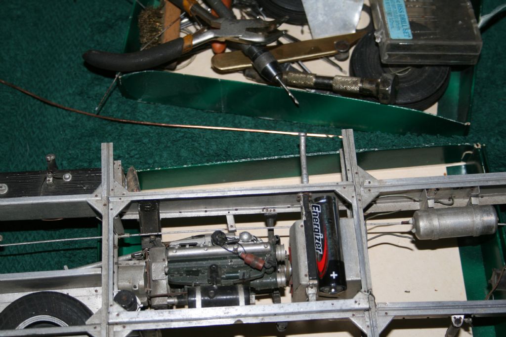

                              Size wise ..that's an AA battery on the top.. so you can see there ain't a lot of room for hammering a rivet !!

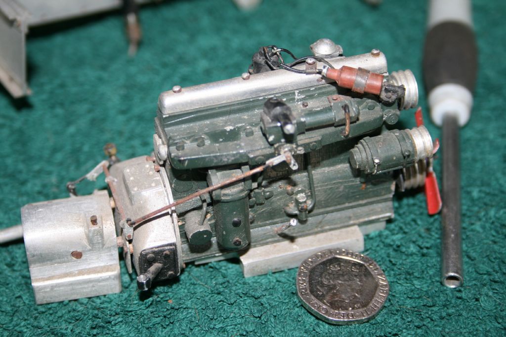

                                                  I've removed the engine ! Low mileage i guess ,but the oil is a bit low on the dipstick , and compression is low … gummed rings I daresay , ruddy 1950's monograde oil… cheeky
                                                  Sweet innit ? smile
