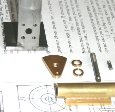

              I’ve just included the only photo I have of a dovetail joint  on a simple oscillating engine made for my grandson, the majority of my models were destroyed by fire.  The joint is between the upstand and the base. This was not a swaged joint but was designed for silver soldering.  The photo shows it after soldering and pickling but before final cleaning up and assembly of the engine.
              The whole process including silver soldering took about 10 minutes. Not bad when compared with using screws with the drilling and tapping (not to mention possibility of broken taps) etc,

                    Terry, Nice joint!
