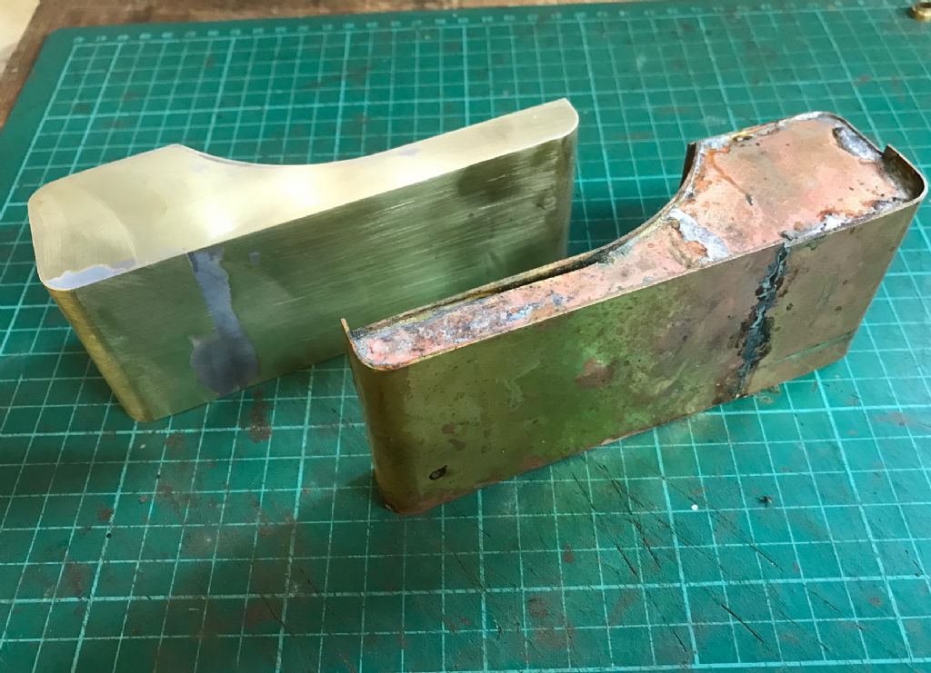

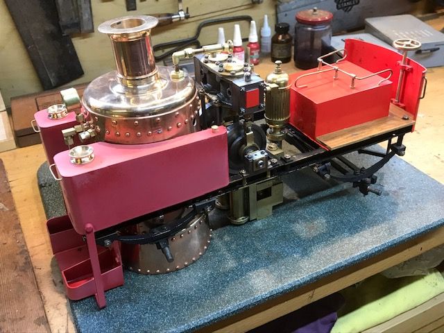

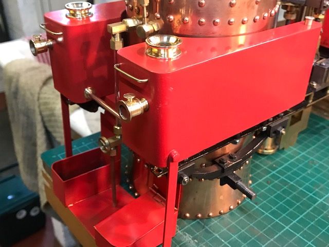

        So we are progressing with the water tanks. Quite fun metal bashing. Here is one after soldering and the other after a bit of filling with JB weld and then cleaning up:
        Next up is the rear platform, and then some painting.

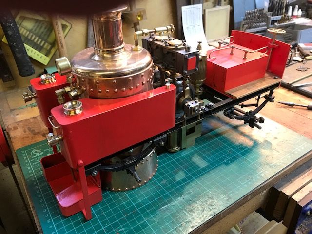

              A Nightmare Painting Job
              When I finally got to paint the water tank assembly I discovered to my horror that there was absolutely no colour match with the front parts. This was despite the fact that I used the same tin of paint.
              I contacted the supplier who suggested it was something to do with the primer I had used. He very kindly sent me some isolating primer and some more paint (at a very nice discount). But this was not much better. He then suggested I brushed on more coats. This ended up with an awful finish, so I spent ages with paint stripper to get back to bare metal. In desperation I went to my local paint shop and a very helpful guy found me some spray paint that was almost the same colour as Fire Engine Red. So finally I got a good finish, and assembled all the fittings. I added a few more, such as the spotlights and filler mountings. These were not on the Julius drawings but I copied them from Cherry Hill's model, just to add a bit of detail and also because I like machining little bits of brass!
              Next up the wheels, which look a challenge. Not to mention 60 tapered spokes! I nearly forgot. I was thinking about pinstriping on the tanks. Never done that before, so any suggestions would be most welcome.

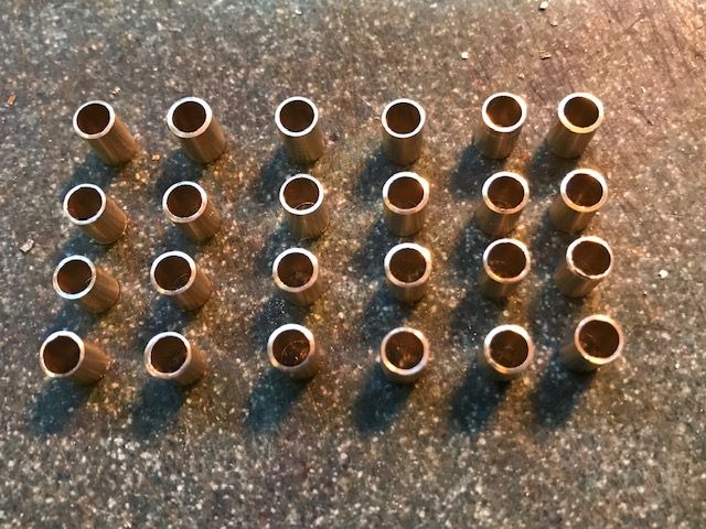

                              Who said model engineering was interesting and challenging ? Got to make fifty six of theses little blighters to locate the wheel spokes !
                              And then there's the little matter of fifty six spokes.

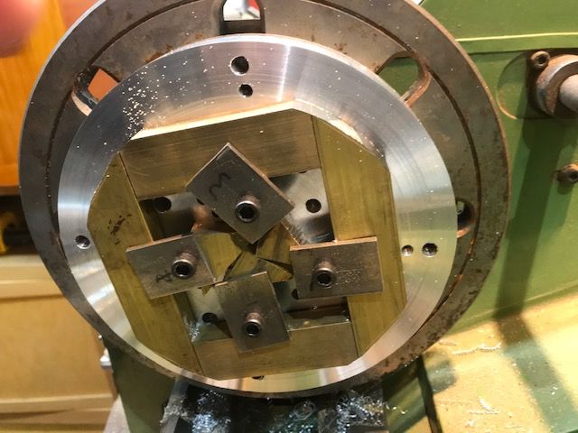

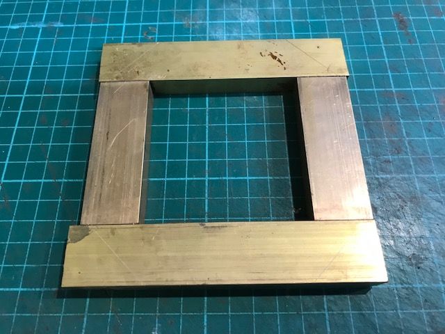

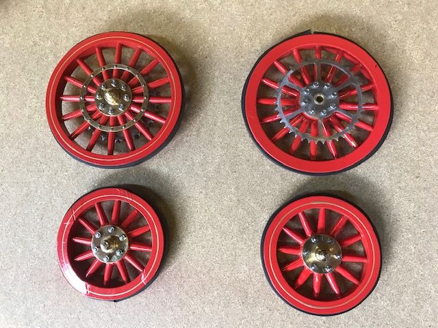

                                Good progress with the wheels. I thought I'd show some of my machining operations as I was using a faceplate for the first time. Any comments from the experts would be post appreciated. My idea was to build the whole assembly on a disc of aluminium which could be moved between the faceplate and the mill rotary table without moving any parts. This way I would (hopefully) maintain concentricity.
                                The outer rim was made from four strips of brass pinned and glued together:

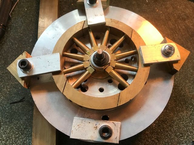

                                Mounted on the faceplate I machined the outer diameter:
                                Then the inner diameter:

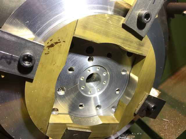

                                Because of the size of the rim I couldn't figure out how to machine the tyre groove on the OD, so I transferred to the rotary table and slowly milled the groove:

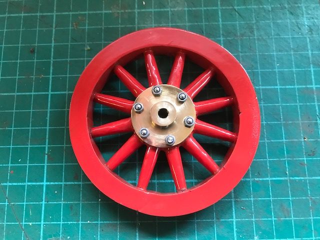

                                I also drilled the holed for the axles with the same setup. Then on the bench I could assemble the axles and the hub:
                                I was disappointed to realise that when I machined the tyre groove most of the pins I had put in to hold it all together had been nearly machined away and the whole assembly looked a bit flimsy. So I decided to add a brass tyre at the bottom of the groove and screw that in place. That seemed to work well, but it did reduce the depth of the groove from 8mm to 6 mm. Fortunately I already had the neoprene square section for the tyres and with a bit if experimenting found I could mill 2mm off the thickness – disaster averted. So here is one of the finished wheels. Not sure how to bond the neoprene tyre to the rim though. Any suggestions?

                                    #590627
                                    Bob Wild
                                      @bobwild67557

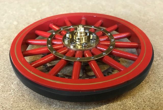

                                      Finally got the wheels finished, including some gold striping. Quite pleased with the results. The lines could have been wider, but that was the maximum my pen would open.
                                      Added minor details to be more like the real thing. The rear wheels have an extra (strengthening?) ring. The chain wheel was solid when I got it, so I machined some spokes for authenticity. Also each hub has a funny fitting in the centre. Not sure what they are; grease boxes perhaps ?
                                      And finally it is starting to look like a fire engine:

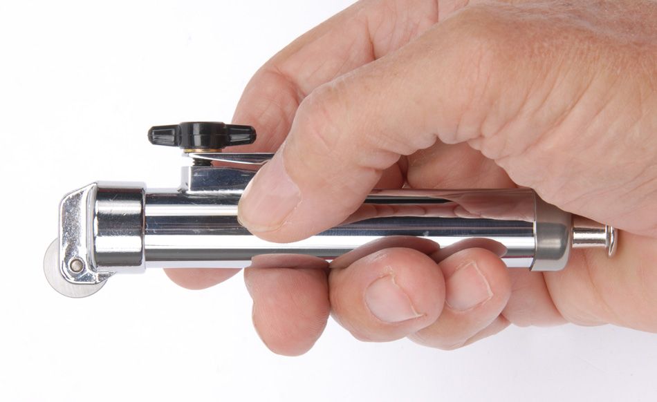

                                        beugler.jpgYour engine is very impressive Bob. Well done.
                                        Thicker lines can be painted with a Beugler pinstriping tool. Rollers are available in different widths.

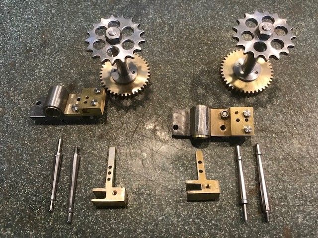

                                          Cut the gears, which was a new experience for me. Not too many problems once I got the hang of the dividing head. Since I moved the valve eccentrics ages ago I couldn't use the engagement lever as Julius designed it. So I had to resort to what is probably an unorthodox but effect design of my own. The gear slides in a clevis which is moved in and out with a square shaft. A pin is used to lock the clevis in either the engaged or disengaged position. Here are the parts of the assembly (the chain wheels are proprietary items) :
                                          And this is the complete assembly:
                                          And here installed in the engine:

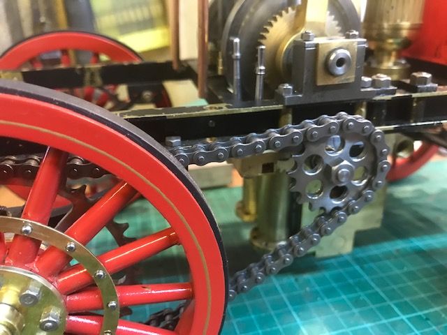

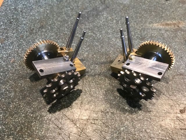

                                          And finally I have drive to the wheels. Fitting the chains was a nightmare. To start with I made the chains such that they just fitted with a minimum of play. But the links kept jamming. So I tried making them a bit longer. But you can't get a bit longer because you have to increase by one whole link. The end result means that the chain flaps around terribly. So I'm going to try inserting some sort of tensioner. Anyway the engine does drive the wheels which to me is a major achievement. I was quite pleased that the control valve does indeed control the speed. Pity the wheels are a bit wobbly, so I'll have to have a look at that!
                                          #612538
                                          Werner Schleidt
                                            @wernerschleidt45161
                                            Hi Bob,
                                            it look nice running. To the length of the chain you have to think when the fireking is on its wheels yo have a length change by compressing the axle springs. I do not know how much it is on your small engine , but it is not negligible. In addition normally there are bars to adjust the tension of the chains.
                                            Werner

                                              Paint is a real nag, I am building a booth in my workshop as I never want to paint when there is good weather. It takes up a lot of space but should help my sanity.
                                              Does you chain manufacturer do "half links"? that might halve your problem. A tensioner is a good idea although to allow axle movement I think the bars that Werner refers to are better, not sure how they fit in this design.

                                                in this original picture I marked the tension bar . It is connected to the rear axle and to the drive axle. This shifts the springs in the radius of the tension bar, but it have to be adjusted when the fire king is on the wheels. It is adjustable with right and left hand thread.

                                                  Thanks Werner and Roger. Yes, I am going to put a tensioner on the chain. I tried it with a hand held support which did indeed help. The method used on the Hungerford machine looks too complicated for me. The springs are very stiff and don't deflect very much at all. My only problem will be fitting one in the space available – ti is getting very crowded in that area!

                                                      A major milestone today. Got the drive chains mounted and finally managed to get the FK moving. The video is a bit short cos it careered off under my car. Then I realised that the front wheels were not actually bolted on.
                                                      The end is in sight – just got the hoses and water stuff to do. Then a bit of cleaning and touch up the paint
