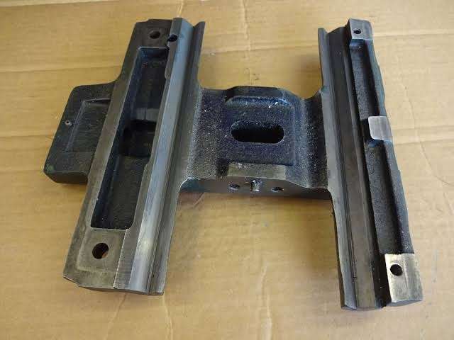

      Hi I am trying to measure the center position of the 2 Vees that the saddle sits on a Boxford lathe bed as I am thinking of replacing my existing bed with a second hand one. Now I have a good saddle which I have measured using a surface plate, angle plate and height gauge and had some surprising results in regards to the saddle Vees. Now my problem is measuring the vees on the bed to find the center distance between the vees without using the same method as I used on the saddle as My surface plate and angle plate is to small for the length of the bed. when machining/grinding the bed they must be able to check it while machining to get the center distance correct. This measurement would be needed if I have to recut the Vees in the saddle to reduce the amount of scrapping afterwards, as I don’t suppose that for one minute that they are exactly the same.
      Thanks in advance for the help

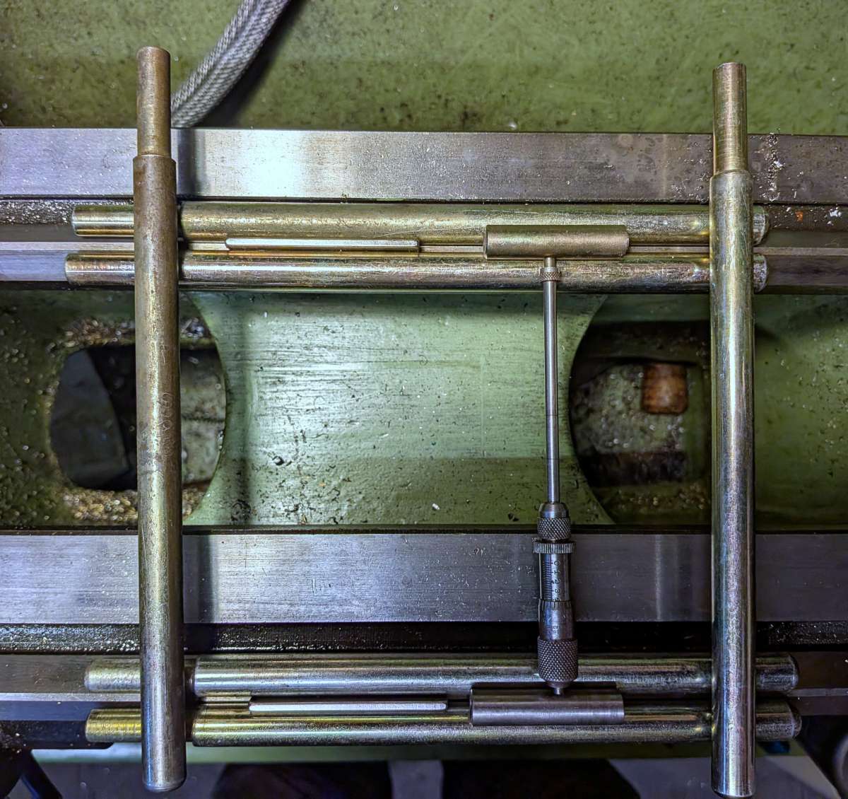

          Just thinking out loud;
          Take 4 round bars, all the same diameter.
          Lay a pair on a flat surface, or even across the bed front to back, and clamp together, possibly with a matched spacer between them, depending on diameters and bed wear.
          Repeat for second pair.
          Balance the parallel pairs on the Vs of the bed, front and back, along the lathe’s axis.
          Lay another bar perpendicular across them and clamp that down too, thus ensuring all 4 bars are in the same level plane.
          Distance between the V centres will be the same as between the fronts of the bar pairs.
          Alternatively, lay an extra pair of round bars on top, parallel to the clamped ones, and use those for the measurements.

              On DC31k Said:
              Two inverted vee blocks, measure either the internal or external dimension of their sides and add or deduct two half blocks. It would not even need to be a matched pair of vee blocks.
              I did think about that, but it might depend on the included angles of the V blocks compared to the lathe’s prismatic bed, hence using round bars.
              This is obviously just a quick lash-up using a pair of magnets, to act both as spacers and clamps; better bars would obviously give more accurate results.

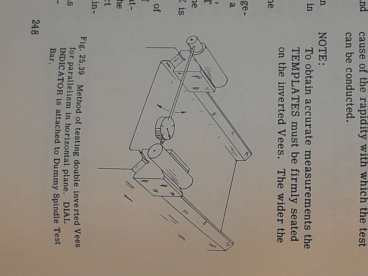

                It is a good point. Are there many vee beds around that are not 90 degrees?
                I guess that so long as the vee block is the same as or more acute than the bed, it would work but if the vee block were more obtuse than the bed, it would not work.
                A lot of the old metrology books show set ups similar to your own, and include a three dimensional case using balls rather than cylinders, so it is a good general method to know about.

                    Hi I like the 4 bars I don’t think you need the top bars as long as the 2 pairs were equally spaced you could measure directly the outside dimension minus the thickness of one pair had thought about doing that but didn’t think of  the bars on the top keeping them parallel across the bed. I will knock something up in the morning and let you know how I get on I will also have a go at the filler method as I can work out center that way too and check the angle and compare results using the same method as i used  on the saddle
                    Thanks again its been a help
                        The reason I took a photo of that setup, was that it was easier to balance; also I wasn’t sure how big a micrometer you had available.

                                  saddle20250717_190822
                                  Some Boxfords have double V saddle. AUD:

                                      Thanks, Only briefly used a newer one.

                                        Just to update everybody Had a play with trying to measure with 4 bars without much success due a couple problems the tailstock Vee being in the way and the sides of the Vees are different lengths the inner sides are shorter than the outer faces and the unused surfaces where the inner vees merge into are at different heights not by much but there not same which means that I going to have to support the bars from the top and have to measure the outside of the bars as the tailstock Vee is in the way. I will have to make some sort of fixture on the lines that peter has mentioned. It does not surprise me in what Nigel has spoken about in regards to milling the beds I would be interested to know if that milling machine had always been used ? My gut feeling is that it came latter. In regards about contact on the Vees It appears that its the front faces of the vees that wears lifting the rear faces as the saddle drops down at the front this I seen this by bluing the original saddle and had good contact on the front faces of the Vees but not a lot on the rear faces if any and the new saddle did not touch any where.
                                        I didn’t try placing saddle where the head stock sits which would have been worth doing in regards to the new saddle to see what contact there was. In regards to the Vee angle on the bed I very much doubt there 90degrees now as the wear on the front faces is quit a bit. the saddle has dropped quit a bit and higher on the rear than the front so the cross slide tapers up to center rather than dropping down to center which is what suppressed me when measuring the new saddle as the Vee angle is not 135 degrees from the top face its about 134.7 degrees
                                        which makes the cross slide at its maximum diameter above center allowing for deflection of the tool on its largest cut and I have checked this on other lathes and they all taper down when traveling towards the center by about 0.1 mm mine is traveling up by point 0.1mm at the moment.
