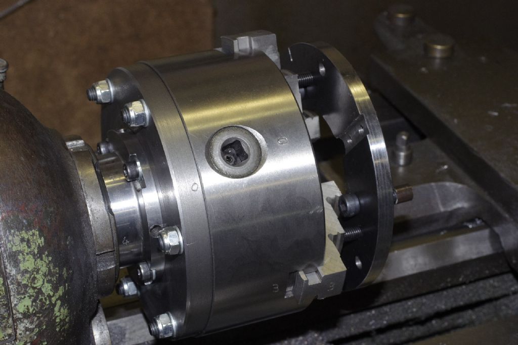

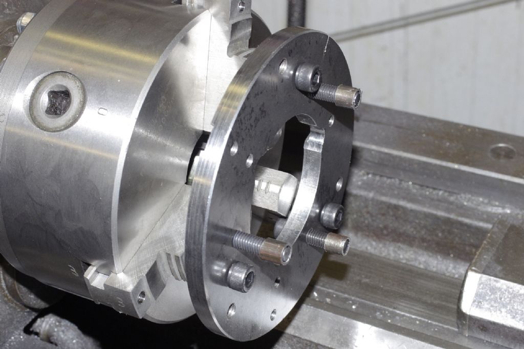

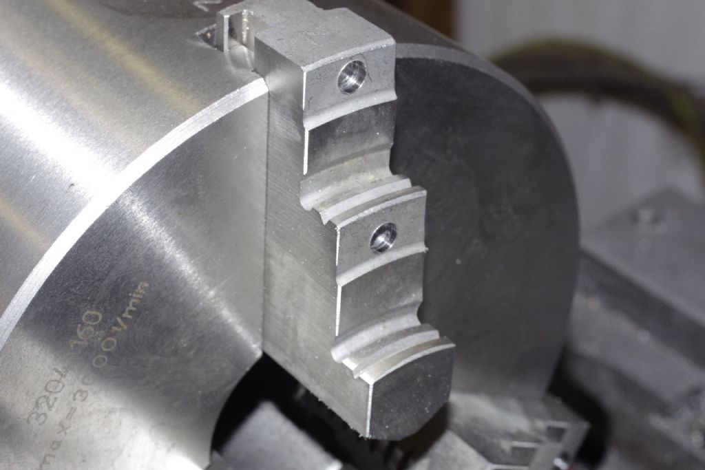

                                        _igp2787.jpg_igp2786.jpg_igp2785.jpgI have an update from preparing a 160mm three jaw scroll chuck for jaw grinding. Firstly, I modified the backplate for the lock to make running in reverse safe. After that was done, I skimmed the front face, it had 0.001" tir wobble. The chuck got dismantled and cleaned in the parts washer. The jaws were drilled in two places each, 6mm x 10mm deep with a solid carbide drill. The steel is surface hardened, but still quite hard in the core. The chuck is one I bought cheaply second hand, but it had never been used. I think it is of Indian origin as the jaws seem to be Bison dimensions, not the K11 design.
                                        Before doing anything else, I got the main body running true, and then tried out three sizes of ground barstock. Smallest was a 16mm od test bar, then a 1" od MT capstan lathe socket, and finally a 55mm size. I couldn't find anything bigger, but not too big.
                                        The results have been remarkably consistant. All three sizes using all three sockets gave 0.003" or slightly less runout with the high spot always in the same place. So far, I have only checked the inside of the inside jaws. It should be pretty good after grinding.
                                        Since there was no definite best socket, I will use the one marked with an O.

                                                I finished grinding the inside jaws of the 160mm chuck, both the inside and the 2 outside steps and stripped and cleaned the chuck. The outside jaws will have to wait, I haven't checked their running yet, and Mike needed the lathe, anyway.
