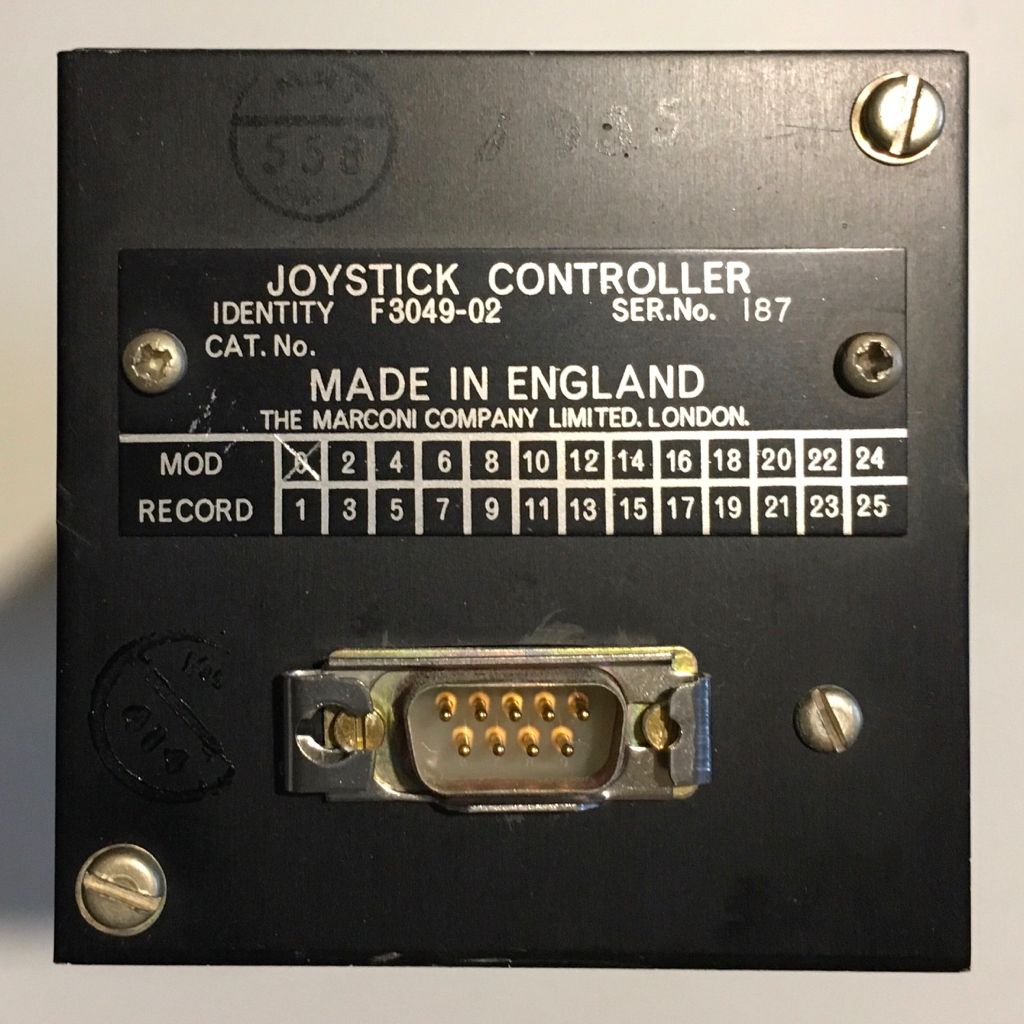

      A quick lift of the lid confirms that it is very nicely built, and I don't really want to start pulling it apart.
      Is there by any chance an ex-Marconi member who can advise ?
      It has a standard 9-pin D 'male' connector on the base panel … but is it compatible with the ordinary, common-or-garden Joystick Port on a PC ?
      Incidentally: Although clearly marked F3049-02 the stick does not appear to have a momentary push switch incorporated.

          Standard PC joysticks attach to a 15pin D connector on the motherboard or soundcard and consist of a series of variable resistors that are adjusted as the joystick is moved, providing an analogue voltage proportional to position.
          The 9 pin connector was found on Atari and similar machines and consisted of switches for up, down, right and left. Software within the computer/console polled these over time to provide positional information. Google Atari joystick pinout for images of the connections.
          Without more data it is hard to do more than answer your last question with a no as the connector is not correct. Whether it would work on a games console I can't say, but instinct suggests I would be surprised if it did.

                            Highly unlikely. 1977 pre-dates the IBM PC game port by a few years. Also, the way the original PC game port works is quirky(cheap), low resolution, needs frequent re-calibration etc. etc. Not something Marconi would want to be associated with. My guess would be that what you show uses some pins for power input, others for serial position output (RS-232 or relative).
                            I am going to disagree with Nick Clarke here. A PC joystick has just the variable resistors, the rest of the circuit is on the sound/game card **LINK**. BBC Micro joysticks did output analogue voltages.

                                          In the late '70s an RS232 connection would only have been D25, not D9. I think as the article mentioned avoiding the use of potentiometers it was most likely using synchros, certainly would have been my choice then as they were used for a lot of precision positional feedback, eg in avionics. It doesn't look like a GEC format part No and we didn't call things 'identity' it would have a Drg (drawing) or NSN (Nato Stock No). Since the article also mentions a circulator with a part No beginning with F it could perhaps have been made at Frimley.
                                          I was at Stanmore then, a completely different division, as Marconi Space and Defence Systems. It's an housing estate now crying

                                            I may be way off the mark here but the absence of a nato stock number (NSN) would indicate that it wasn't a military item. By 1977 anything that moved or could be removed would have had an NSN.
                                            The 'D' connector only having an sliding retainer would also indicate that it wouldn't have been used on anything military that moved. They would have used screw retainers and in serious applications wire lock them. Then again an Amphenol type socket would have been used.
                                            So with the circulator a civilian ground radar system?
                                            (Just noticed that Bazyle has said much the same thing, but then we did work at Stanmore at the same time…)

                                                That MoD identification label is an awfully familiar style. Although NATO stock numbers were officially universal from mid to late 1970's in practice much of the kit I saw at RARDE up until the mid 1980's when I stopped having regular contact with direct from the military equipment made do with a simple MoD plate of that style.
                                                Field and deployable equipment always got the NATO number. But fixed base, experimental and modified equipment frequently did not. Seemed to me that you could only be certain of finding NATO numbers on general issue equipment. Experimental and research et al kit, which was what I mostly dealt with, supplied via MoD made do with that sort of plate.
                                                Clive.
                                                #368792
                                                doubletop
                                                  @doubletop
                                                  Yes a very familiar format but for those less familiar, not to confuse MOD with MoD. MODification Record vs Ministry of Defence
                                                  Pete

                                                    Posted by Doubletop on 24/08/2018 06:07:11:
                                                    Not off the mark at all
                                                    The unit I have is built to very high standards, but it appears to be a commercial item … it is not ruggedised for field use, and has no NSN [that was the first thing I looked for].
                                                    As I have already stated, I don't wish to start dismantling it … I did lift the lid, just far enough to see that all the leads to the D connector are pink, and have tiny heat-shrink identifiers. The back of a glass-fibre circuit board is visible, and the leads pass through clearance holes in the board. …. Any further investigation from that side would almost certainly involve damaging the original assembly detail [which I want to preserve].
                                                    I am, for the moment, treating this unit as a rare historic artefact.
                                                    If no information is forthcoming, I may try dismantling via the top plate; but that again seems likely to ruin the integrity of the original construction.
                                                    Thanks to you, and Bazyle, for your thoughts yes
