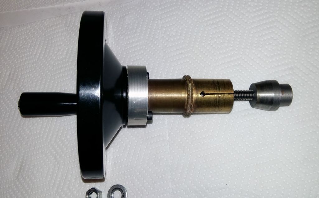

        Thanks for that information Michael and Howi, I see now how that system works but I must say I have never come across that idea before. I use the split tube and tapered wedge method for my handle but it is good to see other ways of doing it.
        I rarely seem to cut threads without the handle as it is so controllable and easy on the nerves. Very much a must have item.

          My mandrel handle is a wheel, an ally drive wheel of an old water pump, about 12" dia. Easier to use than a handle and can be left in place. It was made in a hurry, the split tube is a bit of ally tent pole and was a bit loose so wrapped with aluminium tape to suit. Only part made was the brass taper plug, tapped M6. The spindle bore is pretty rough but so far this has worked well.

                    … & here is my attempt
                    George.
