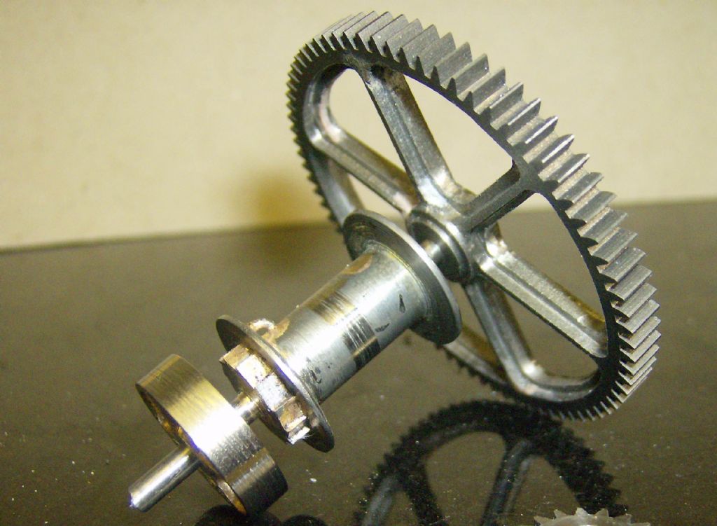

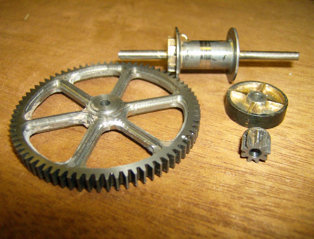

      I had some really useful feedback on the canalside crane at Fradley, so I’ve started making a 1:12 model. First a pic of the crane, then some bits;
       Main pillar:
      Gear wheels, winding drum and brake drum:
      Parts assembled on to the winding drum:
      The gear wheel is just over 2″ diameter, cast iron blank cut as a gear, then the spokes milled  on a rotary table.

          Looks great so far Neil, nice job.
