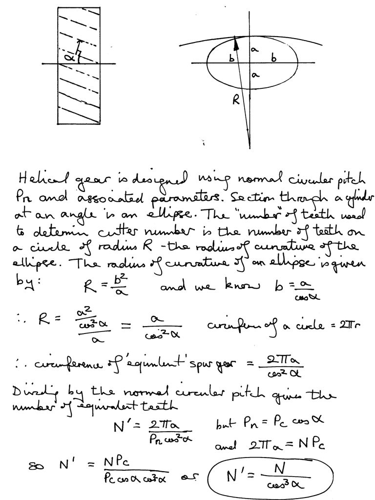

                                    Posted by JasonB on 22/05/2016 16:27:33:
                                    … I think its a different calculation for helicals so spur gear calculations won't work, also varies for parallel or crossed.
                                    … and I hadn't realised how big that variation is surprise

                                        Anonymous
                                          As a first pass the number of 'teeth' used to select an involute cutter for a helical gear is the actual number of teeth divided by the cube of the cosine of the helix angle. Here's the proof:
                                          The OD is also related to the helix angle, so not fixed for a given number of teeth.
                                          Andrew

                                                Posted by Andrew Johnston on 22/05/2016 19:40:55:
                                                … Here's the proof:
                                                Thanks, Andrew
                                                That's my learning point for the day
