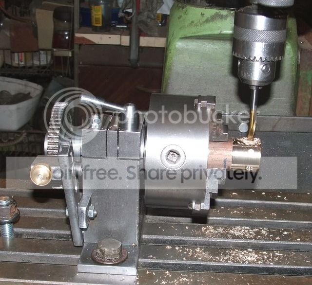

                              Posted by Dave Smith the 16th on 23/05/2016 15:31:31:
                              Free hobbing, shows where a lot of youtube videos are misleading. Quite a few are free hobbing with no initial cutting of the teeth.
                              There's nothing wrong with that; provided you're not overly worried about the exact number of teeth. In the picture below I didn't care how many teeth there were, just that the PCD was somewhere about right:
                              The worm wheel is for the adjustment of the governor on my traction engine. To save time the 'hob' is a 7/16" UNC spiral flute tap, bought on Ebay.
                              Andrew

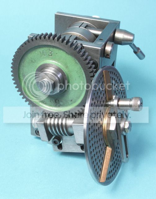

                                      A printed indexer is not going to be very accurate for gear cutting, unless you make it about 6 inches diameter or more.
                                      A traditional alternative is to use another 20 tooth (or multiple of) gear attached to the other end of the shaft that the gear blank is mounted on. A simple plunger engaging between the teeth of the gear provides nice accurate indexing. Any sized gear of the right number of teeth (20, 40, 60 etc) will do the job. Lathe change gears are the common choice.

                                          Make your own dividing head. Very simple to make one using change gears for indexing. Harold Hall's book on dividing I mentioned above has all the details on how to do it. A good beginner project on the milling machine! And then a simple job to turn up a matching worm and make some drilled division plates.
                                          GH Thomas's book "Workshop Techniques" mentioned above has all drawings and instructions for making the ultimate home dividing head the "Verstatile Dividing Head" with a double worm arrangement that gives indexing resolution of 1/1000 of a degree. Probably a bit over the top but a very nice project.
                                          Loctite might hold the gear for you. Or if the blank has a boss on the side of the gear, drill and pin and Loctite. I would avoid grubscrews. They tend to work loose over time. Pin and loctite are set and forget.

                                            Harold Hall's simple dividing head, suitable for gear cutting, and suitable to add a homemade worm and index hole plates to for further refinement at a later date:

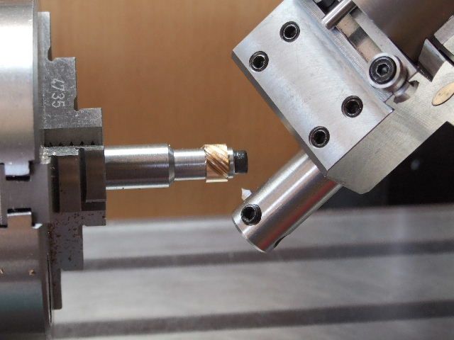

                                                      Graham Meek sent me a picture that shows an unusual approach to approximating a helical gear:
