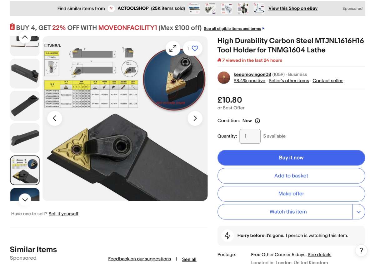

                            The one I bought had a 16mm shank. Too big for my little 8 1/2” x 14” but I took 2mm off the bottom with a carbide mill. The TNMG’s have 6 cutting tips so very economical to use. I know what you mean about making your own tooling though.
                            Edit: Even cheaper now. Only £10.80. But no insert.
                            https://www.ebay.co.uk/itm/196694256916?_skw=TNMG+TOOL+HOLDER&itmmeta=01J9CRH331QTXADNGW7SZ42KFC&hash=item2dcbe42d14:g:28wAAOSwu-Vm~5S4&itmprp=enc%3AAQAJAAAA8HoV3kP08IDx%2BKZ9MfhVJKm5uQd2ufgZiW2iRlg80E4c%2BoXqBxOjklZhWeyxU9MKNDBED96ZvCFdGF8bw0jfR4CUJjL49zXNapK6OPWa8PmBM11d3%2Fbw9DgL%2FPXDpfHAC2zTByVpPMrgN3GNLW2F4sye7p%2FtIm6qbv0vC2P8UiRzF0SeW2PnL0x%2B9cjEt8V%2BIjcpUc%2BTVW7FD2R5xMtevvg%2By%2BDS4uYqnPIhG35kBY%2B6WliJ7sDQZOGZFPzNQ88VnC34gMNhRM0UH9Qo%2BKtw%2BI0I7v9dNeRB7cwf7KlFa3%2BzZ71VaNZEHMjI3oXUZCIjpg%3D%3D%7Ctkp%3ABFBMzrHEmMtk

                              Hi Vic. I think I saw them once but ignored as the holder was left hand Meaning pointing to the right & not the left.
                              Steve.
                              #757482
                              Vic
                                @vic
                                The picture shows both left and right hand but the description does say left. Maybe that’s why it’s a few quid less? Mines very well made and the shank was of Hardened steel so I had to take it slow with the carbide mill when I trimmed it down. Recommended if you can get one to fit your lathe, albeit with some modification.

                                  Steviegtr’s toolholder would be better if he had tilted the tip of the insert downwards 7 degrees to give it the correct clearance. For his straight type, the blank could have been tilted in the milling vise, and the clamping screwhole drilled and tapped in the same setup. All neutral inserts have their seatings dipping for clearance because the face is 90 degrees for double sided types. The pictures in Vic’s advert show the dip, which is on the axis between the tip and the centre of the insert, whichever way it is pointing relative to the tool shank.
