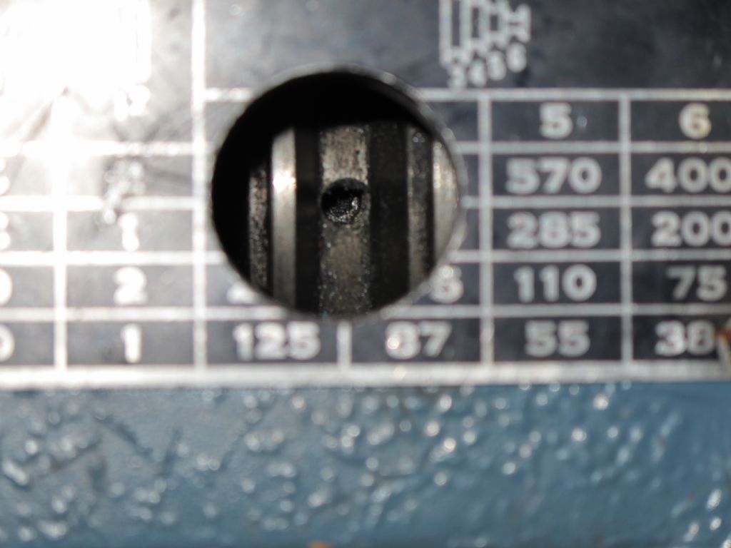

      I recently acquired a 1962 Mk1 boxford AUD lathe with which I intend to replace my Warco WM180. While familiarising myself with it and oiling anywhere that needs oil I realised that access to the two back gear button oilers for inside the headstock would not be easy from the front of the machine.
      I notice the Mk2 has much easier access and even has a hole in the top front of the headstock to facilitate this I'm contemplating making such a hole in my headstock to make the job (oiling) easier and therefore much more likely to happen regularly.
      Am i mad to consider this and is it even necessary? Obviously Boxford added such a hole to the Mk2 so someone thought it necessary.
      Has anyone on here ever attempted this and could offer some advice. Maybe It's a stupid idea and there would be trouble ahead if I did it.
      Many thanks, Simon

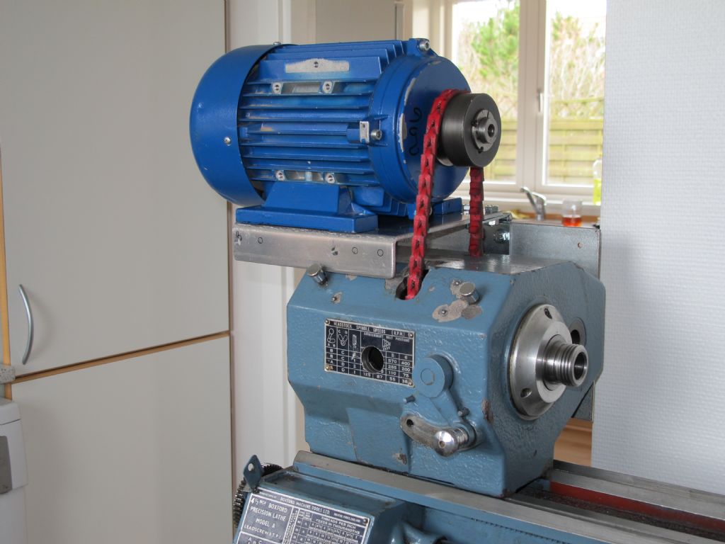

                Niels Abildgaard
                  @nielsabildgaard33719
                  I drilled three holes in a Boxford A and it did not die of shame.
                  It is at a friend now and is worlds best Boxfords I think.
                  Silent Box
                  Edited By Niels Abildgaard on 03/03/2023 04:32:52

                    #635981
                    Grindstone Cowboy
                      @grindstonecowboy
                      How about moving the name/data plates onto a piece of flat sheet and hinge it at the top, thus covering the hole and preserving the look of things?
                      Rob

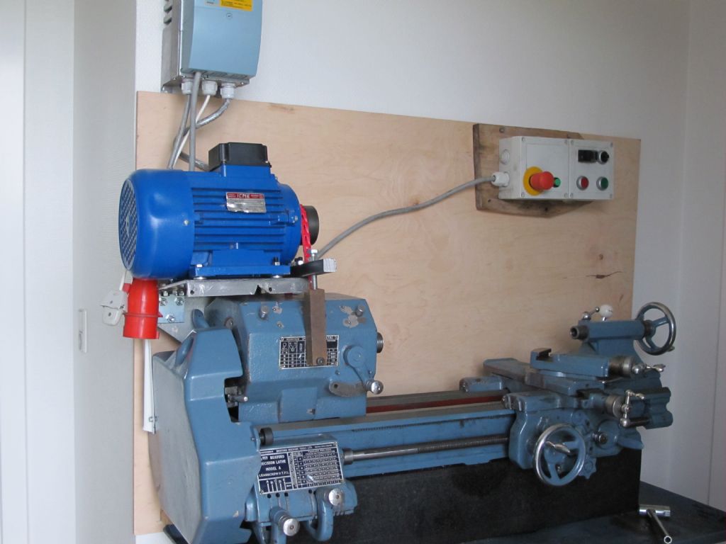

                      Niels Abildgaard
                        The date plate was superfluous as I ran a 1.5kW 3ph 6 pole VFD.
                        Main reason for hole was I needed support for belt tensioning.
                        It was a nice side effect that lubrication of that disc/backgear thing became much easier
                        My best Boxford
                        #636105
                        Simon Barr
                          @simonbarr48213
                          Posted by Grindstone Cowboy on 03/03/2023 19:11:14:
                          Rob
                          I definitely like that idea and it's not something that has occurred to me. Preserving the look while still having access would be perfect. Initially I was thinking the hole could be in the 45 degree angled bit of the headstock between the grease cups but there is a Boxford badge there. Your solution would mean the hole can still go there and hide under the badge.
                          Thanks Rob yes
