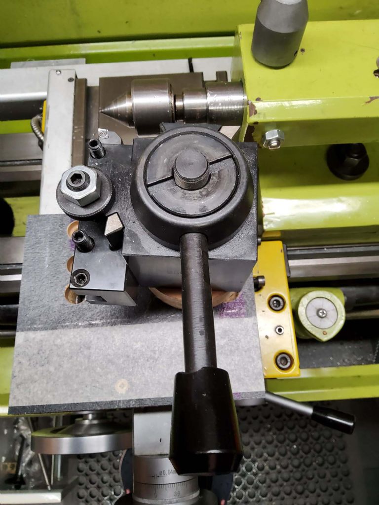

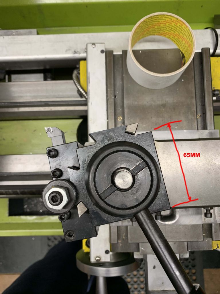

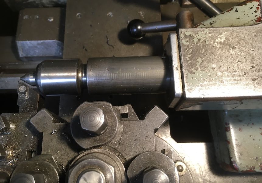

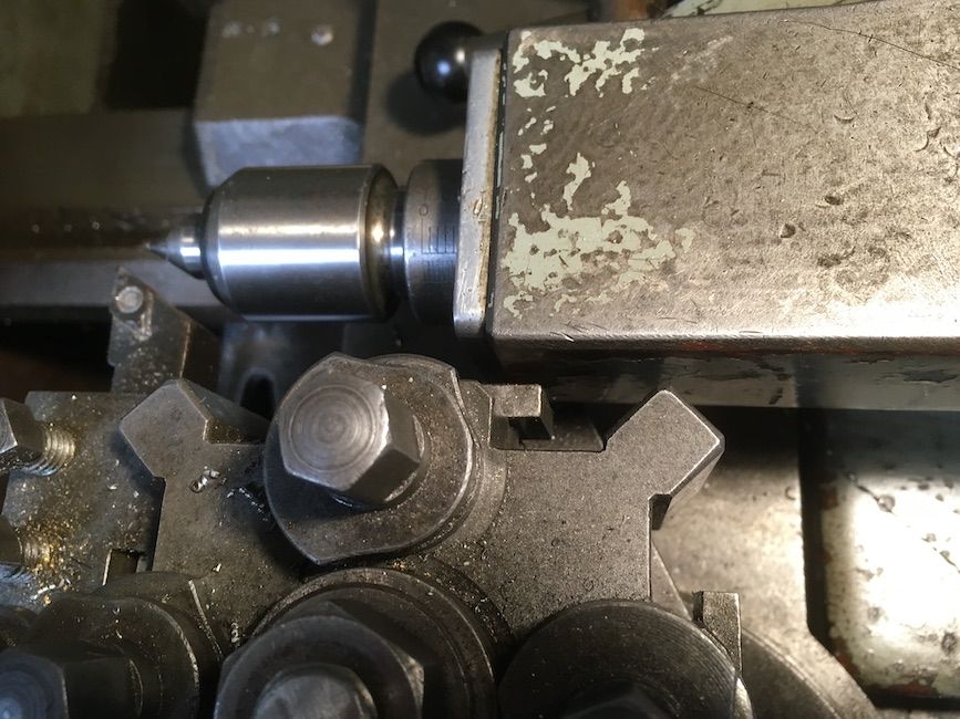

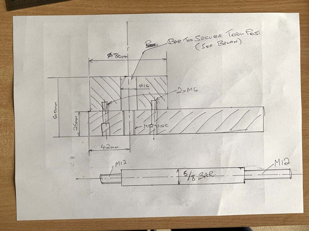

I fear we have gotten at cross purposes. Again!

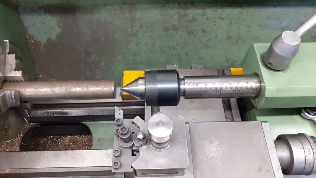

As I understood things the issue is avoiding this situation:-
where the tailstock barrel is undesirably extended to clear the toolpost. There is a considerable gap between tailstock base and cross slide.

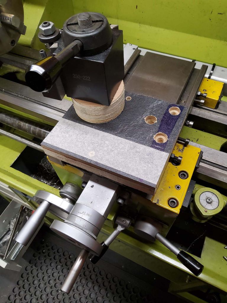

If the toolpost mount is moved outwards it can clear the tailstock casting like this :-
considerably reducing barrel extension and bringing the tailstock base close to the cross slide.

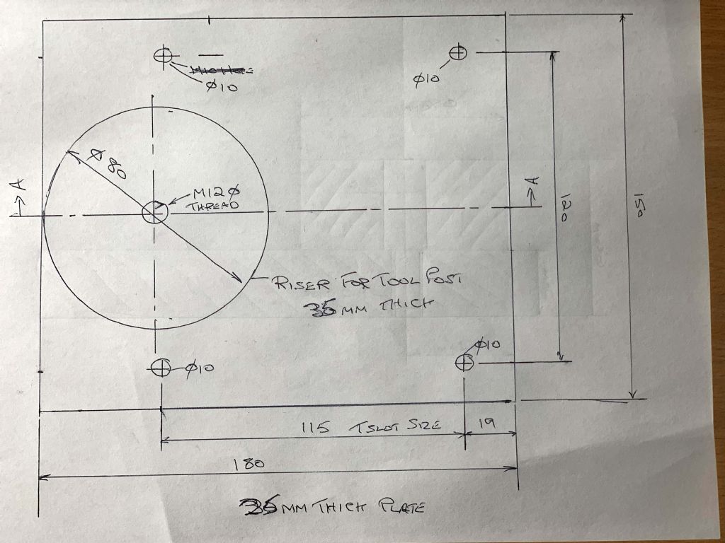

I think it inevitable, most especially with a smaller lathe, that one toolpost position suits all is pretty much impossible without work arounds involving undesirable tooling arrangements such as long stick outs or tool shifting mid job. Accepting that it seems sensible to not only provide several alternative positions for the toolpost and its mounting block but also make it easy and quick to move. If it's not quick and easy you won't shift it and struggle to do the job with things as is taking three times as long with worse results and considerable profanity. Human nature, Been there, dunnit, got the tee shirt and wrote the book.
I would use a simple stud of suitably hefty dimensions and just drop the block on relying on a locating pin to ensure it always goes back where it should. I'd also fix a locating pin to one of flat sides of the toolpost to either engage with the teeth of a flat gear affixed to the top of the block or drop into a one of a ring of holes drilled in the top of the block. Best to drill and tap the toolpost for couple of screws to either hold the locating pin directly or via a tube so it can be slid up out of the way when using the toolpost on the compound slide. Having the pin you may wish to consider whether some sort of rotational indexing can be arranged when using the compound.
