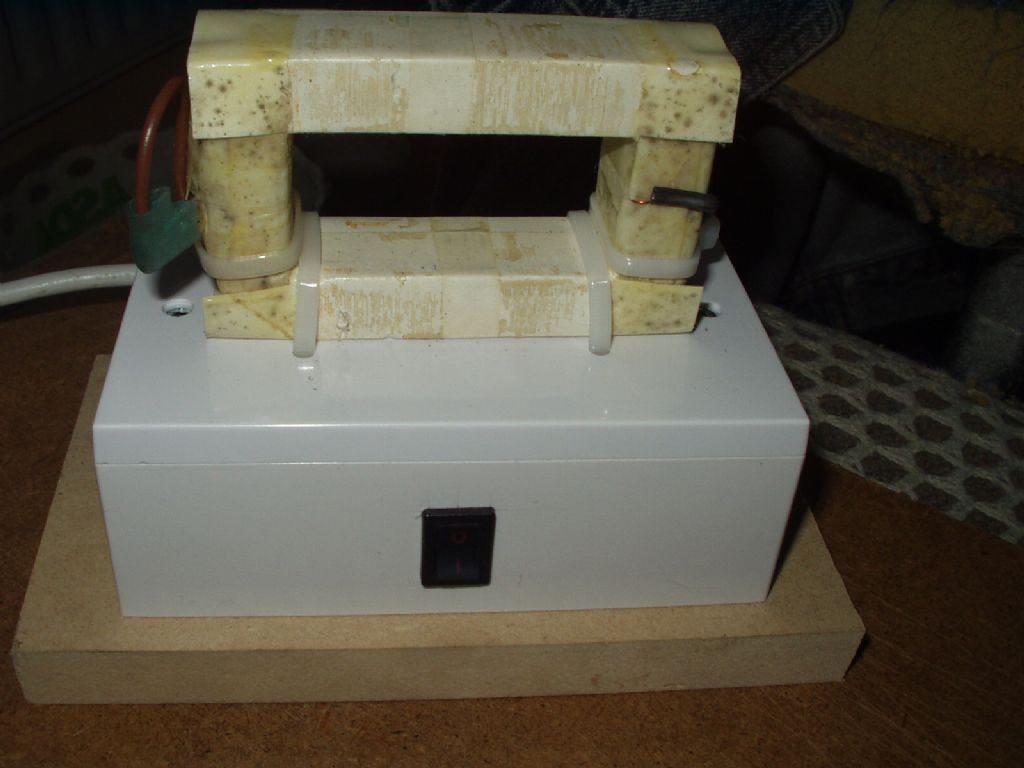

      Suddenly I have a lot of tools both on the bench and on the lathe becoming magnetised!
      Toolbits laid in the tray come up with a load of whiskers, any ideas?
      Screwdrivers on the bench the same, laid down and then picked up and again whiskers on the edge.
      I have no magnetic chucks, no magnetic stands or clamps. All very strange.
      If I give the tool a knock it clears itself.
      Clive

          Hi
          you can make one from the primary winding of a transformer from a microwave oven.
          it’s a bit hard to get at but it works well.
          Roy

                  I use Wheeltapper’s system with the coil removed from a microwave oven transformer, I’v built a box around the coil, leaving a hole throgh the center. I run it of a transformer at a bit over 12V, it works well, and cost nothing, just a bitr of time. For bigger stuff I’v got a large round coil, the section through the windings is about 3″ x 3″, the hle through the coil is 10″, the wire is 14 swg, and I use my workshop low voltage circuit at 17V. I have 2 of these coils, but one of them is in poor condition. Ian S C
