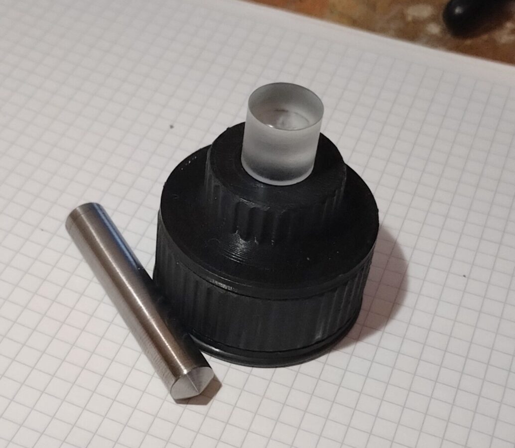

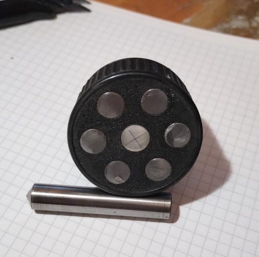

      I’m actually quite pleased with myself now. I just made a switchable magnetic optical punch, and it works every bit as good as I expected. And on the first attempt as well. The body is just 3D printed so I might make one in solid metal later. But that will be a vanity project, the printed one is more than good enough for me.
      It uses 6 Ø6x3mm neodynium magnets and locks in place with a 30° turn of the central body:
      The eyepiece isn’t exactly optical quality, but it’s easy to reshape so if anyone has a good trick here I’m all ears.
      #782705
      John Haine
        @johnhaine32865

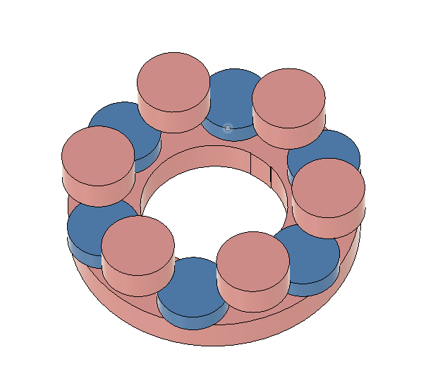

        Neat! How does the locking work?
        #782709
        Fulmen
          @fulmen
          Like this (viewed from below):
          The red parts are mild steel, magnets are blue and in an alternate north/south pattern. The 6 small steel pegs are in the base as seen in the photo. The magnets and the large ring move together. As depicted the magnets are off, if twisted so the pegs align with the magnets they’re on.

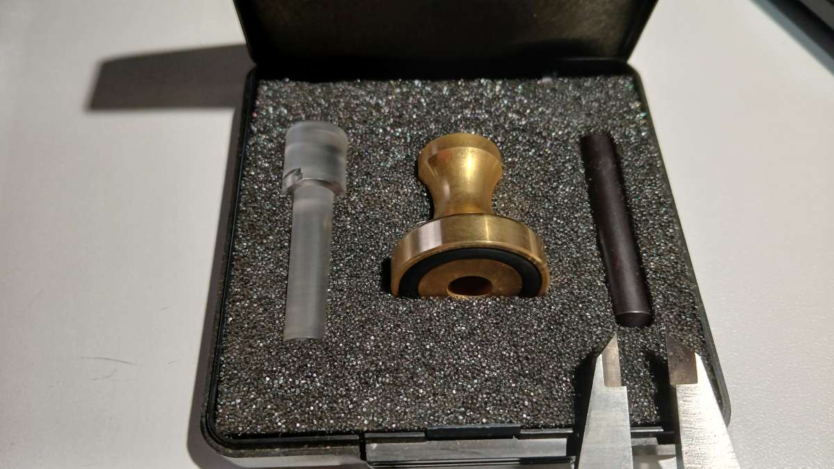

                        I can see the ring around the edge now that I look closer.
                        I don’t seem to have a problem of brightness with my commercially made one which only has an 8mm dia stem and 12mm head. Though the height may come into it as yours looks a lot taller than mine which only has a 30mm high body, possibly the straight rays of light hitting the sides rather than being able to get to the bottom or the polished internal bore of mine reflects more light?

                            John Haine
                              @johnhaine32865
                              So a strong detent action when “off” and lower when “on”?  Clever.

                                          I just looked mine up and it has 8x magnification. I’ll have a measure later and see if I can get an idea of the radius of the domed top
                                          Regarding “length to practice on”, if that was referring to recutting the cross hairs then beware of parallax the further the end of the clear rod is from the surface.

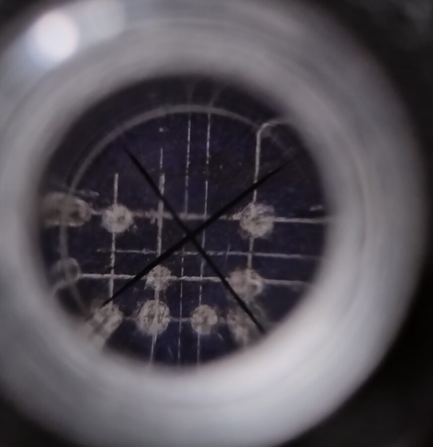

                                            Fulmen
                                              @fulmen
                                              What turns out to be the hardest part is to get the crosshairs juuuuust right. The best result so far has been with a height gauge with the lens held in a printed square holder. But it takes a bit of practice getting it right. And every time I get it wrong the lens becomes shorter…

                                                    An alternative to a punch might be a “spotting drill” – these have precise ground shanks (I have a 10mm dia one) and 90 degree point and are designed for precise hole starting (better than centre drills).  One that was a close fit in the punch body could be twisted by hand to leave a small mark – if you need something bigger then use it to locate a normal centre punch.
                                                    On the cross-hairs question, another approach is to scribe a line that is very slightly above the centre line, rotate the body by 90* and scribe another so you have two parallel lines.  Then scribe two more at right angles to give a small square which must automatically be centred.  Then you align the mark with the centre of the square.
