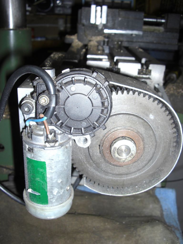

          hi i fitted a magnetic clutch to my champion mill and it works well it was made from a 12v clutch from ebay and a window motor from the scrap yard cost less then £50.00 i will take some photos on friday and post them

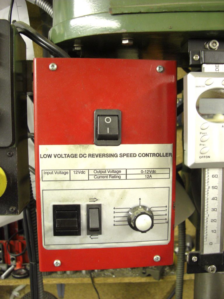

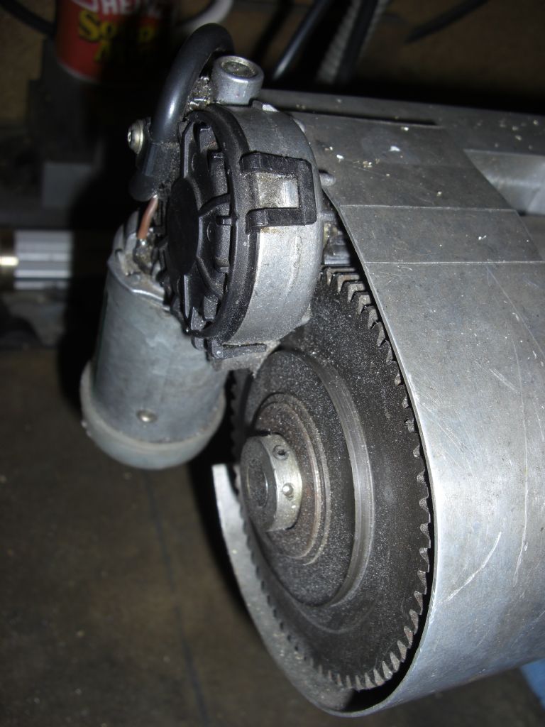

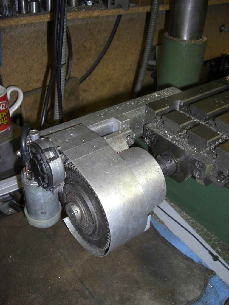

                    photos as promised this is a 12v clutch and a 12v motor from a car window runs from a small transformer as i wanted it to be low voltage and safe.
                    it was easy to fit but a few months to get all the bits from eBay and the scrap yard, i have the motor running all the time and just switch it on and off as i want it and it works very well.

                      Hi Kevin interesting photos did you buy the speed controller or make it.
                      Could you send me details of it please and the transformer.

                        hi Paul i was very lucky as it was a skip find from an in industrial retail park all the wires was cut off and was easy to re-connect , the transformer is a laptop type and was 12v not 18v as most laptops are now lots on eBay and cheep. the bed drive fixing is a rubber spider coupling this takes up the snapping of the clutch when switched as for the motor running all the time this lets you still use the hand wheel manually.
                        i will see if i can take a video on my camera i have never done this before so may take a while

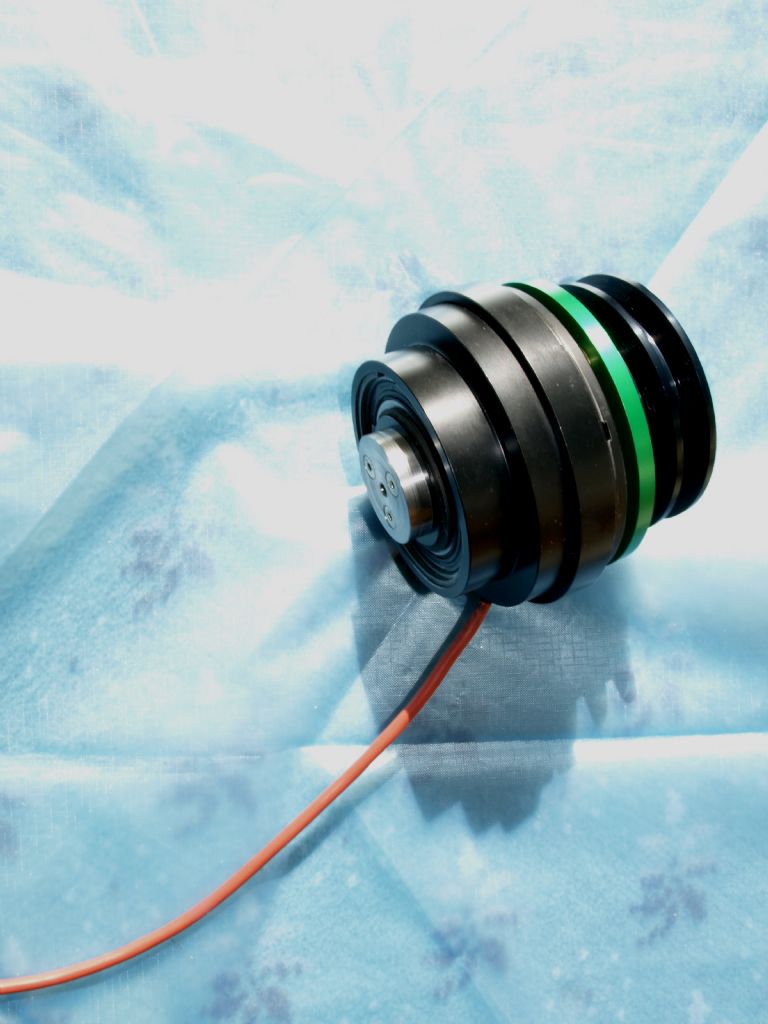

                            I've just obtained a car aircon compressor complete with clutch brand new for very few beer tokens.
                            I've spent the afternoon dismantling it and removing what appears to be useful, some very high quality thrust and needle roller bearings amongst other bits.
                            I will post some pics later of the 'salvage' and clutch unit.
                            Now need to apply a little grey matter to how I am going to mate this to the lathe cool
