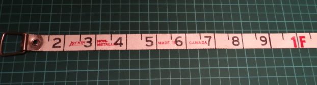

                      #446022
                        Posted by Howard Lewis on 11/01/2020 20:52:24:
                        Pity that no one standardised on ten inches to the foot. …
                        Wot like this?
                        Far too obvious!
                        Pedant Alert, there is no standard inch. The Imperial Standard was the yard, divided by 3 to give feet and by 36 to give inches.
                        The US Yard has been defined as a division of the International Standard Metre since 1893. In the UK BSI adopted inches of 25.4mm in 1930 and the USA followed in 1933. This "Industrial Inch" was slightly different from the inch used by the man in the street, but not many noticed.
                        In 1946, the Commonwealth Science Congress adopted a yard consistent with 25.4mm inches based on the unchanged International metre. Canada shifted to this system in 1951, the UK in 1964. There hasn't been a physical Standard Yard for about 70 years: in fact all imperial units have long been derived from ISO (metric) standards. In a very real sense, an inch is 25.4mm and nothing else.
                        The metre was first defined as the length of a seconds pendulum (half period) because it was possible to measure time far more accurately than anything else. Unfortunately pendulum time depends on gravity, which was then assumed to be identical throughout the world: it isn't, varying enough to render pendulums unsatisfactory as a way of defining a high accuracy Length Standard. Next attempt was in terms of a great circle quadrant; this came unstuck because the earth is an oblate spheroid, not a true sphere. Whilst it might be assumed from these mishaps that the metric system is foolishly flawed, these early metre standards were both far more accurate than the yard. At the time the Standard Yard was a length of old Brass Rod kept in a cellar…
