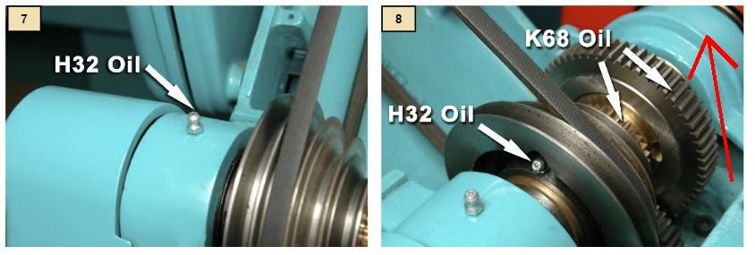

                                    Hi All,
                                    Some advice please.
                                    I read David Haythornthwaite's post on lubricating a Myford Super 7with interest.
                                    https://docplayer.net/42226569-Care-and-lubrication-of-myford-series-7-lathes.html
                                    The one thing I am unable to get clarity on, is how do I oil the "right" side bearing (just before chuck)?
                                    If you look at the above link – photo 7 shows how to oil the "left main bearing" (sorry not sure of official name); but how do I do the right side (top right hand corner of photo 8)
                                    I added a red arrow in this image to show which bearing I mean:super7.jpg
                                    how do I oil the right bearing, wouldn't this be the single most important bearing to oil? I would expect this bearing to be under the greatest load?
                                    Wayne
