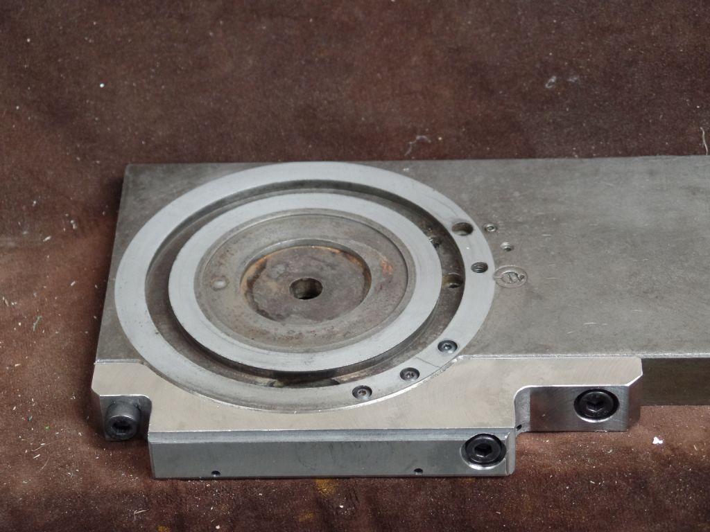

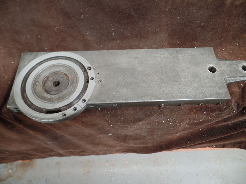

      sam_0800.jpgI have long put off making a replacement cross slide for the museum's Smart & Brown model A because of its size. Recently, I realised that the limited throat depth of the mills would not prevent me from making a new copy of the cracked original. The radius of the cross slide from the compound to the rear end is about 14 inches, but there is no need to be able to rotate that more than about 200 degrees to be able to mill the dovetail. Now I am looking for a piece of cast iron about 18" by 6" and just over 1" thick. SG iron would be better for its ductility than grey iron. Everything depends on the cost, I might have to give up if it is very expensive. Does anyone know of a source?

                    Have you thought about bronze tig or mig? I've had pretty good luck experimenting with it on cast iron, if it's just that little crack in your cross slide it wouldn't be a huge amount of work.

                      Is the projecting part at the other end to the circular slot simply for attaching the taper turning attachment? If so, could it be made of a separate piece bolted on, thus reducing the overall size of the stock?
                      Perhaps mill away the entire outer dovetail, replace it with a steel ring, bolted in place and remake the dovetail. It is not a high speed sliding surface and steel is better able to resist the tensile force induced by the wedging action of a dovetail bolt.
                      A better repair than the underslung splint, and one that has the potential to apply force to close the crack might be to mill out a bow-tie shaped part in the top and glue in a spline piece (just as woodworkers do for repairing cracks). You make the spline slightly small and heat it up before inserting into its pocket. As it cools, it shrinks and pulls the crack together.

                            Just out of curiosity could you tell us what's wrong with the bracing piece you've put on? Is it not working sufficiently? Or just not keen on the look of it?

                              The design is basically weak, but does allow the tailstock to be closer to the spindle than my bolt on repair. If I were to make a replacement, it would be stronger by design, even if made from the same type of cast iron. The outer curve could be at a larger radius, with its centre to the left of the original, leaving the width at the centre the same. This would add more material to the ends of the curved section. The thickness of the outboard curved section in a vertical plane could be greater, the extra underneath would not restrict the tailstock or the movement, which is about 7" total.
                              I have no idea when the damage was done, or whether it was caused by overtightening the two compound holding bolts, or crashing into the tailstock. The reinforcement was accompanied by doubling the bolts to 4 and not tightening them as much. The lathe was due for scrapping when it was donated to the museum.

                              I agree about the length, I had originally contemplated making the rear end a separate add on part to reduce the radius, but below 11" rad would reduce the length of the dovetail length more than I would like.

                                It's hard to be completely sure from looking at those photos, but I get the impression the radius overhang is weak, what I'd do is use a die grinder to carve out the crack enough to fill with bronze, then make two little gussets with some scrap cast iron and braze those in place underneath to support the overhang.
