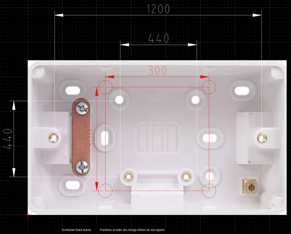

                        Macolm
                          @macolm
                          To illustrate how much or how little a CAD package ploy may help, here is an example where an old double socket box had to be replaced with a modern version. The box image can be disappeared by switching off visibility of its layer, and the fixing dimensions were simply left as 10 times actual millimeter numbers.
                          BackBoxExample
                          A lot of CAD applications allow this sort of working. I like QCAD because it suits my disfunctional work flow! The most common “rescue” functions for me are draw offset line, extend/shorten, break out segment, and cut/paste with reference. This avoids the need for a competent plan when you start.
