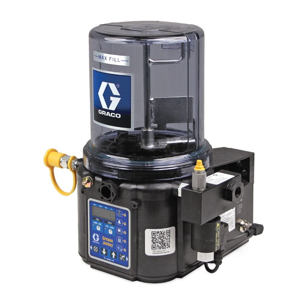

                                  Paul Lousick
                                    @paullousick59116
                                    Automatic lubrication systems are used on trucks (lorries) to distribute grease .
                                    Like this unit from https://www.graco.com/gb/en/vehicle-service/product/25c990-grease-jockey.html

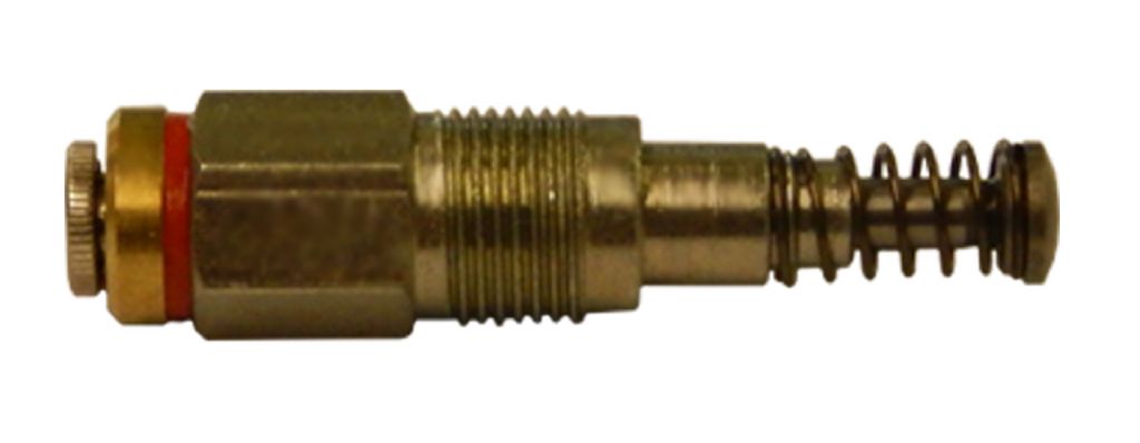

                                                    These pump modules from Interlube are used in their automatic lubrication systems in trucks and operated by an electric motor to turn a cam to press the plunger. They are available with volumes from 0.01 – 0.1 cc/stroke. A mechanical version is used in the Model Engineer lubricator for steam engines which I listed above.
                                                    A possible solution to lubricate the chain on your bike is to use one operated by a 12v motor/gearbox (possibly a windscreen wiper motor) , solenoid or mechanical linkage to clutch/brake lever, etc which could give a shot of oil every time operated. Just an idea.
                                                    Paul

                                                      A most interesting device and not silly expensive (£12 – 20 ish) despite being a professional machine component. Although I was aware of such systems I'd always believed them to be related to the Bujur / Enots et al systems in relying on a metering orifice to control flow rather than being an actual pump. Presumably the operating device is normally immersed in the lubricant being pumped as the inlet appears to be concentric with the plunger and mounting body.
                                                      Maybe I was rush headed in ordering that heater pump!
