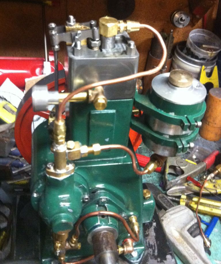

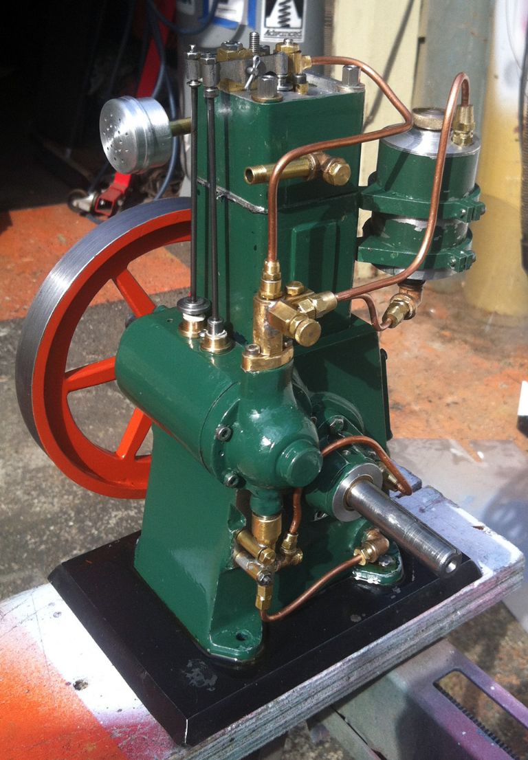

      This is the present state of my Lister build. All the photos are in my album. If anyone is contemplating building one, I would be pleased to assist where I can with drawing help etc.
      Edited By HobbyNut on 07/08/2013 15:56:13

          Looking at the other thread, I think we can say you have achieved the impossible. Very lovely
          #126429
          Diane Carney
            @dianecarney30678
            It is indeed a lovely thing.
            Not so impossible after all …..?
            #126430
            HobbyNut
              @hobbynut
              Thank you for the thumbs up.
              I am "obsessed" with it according to my wife. I call it therapy.

                      Jason, that is what I am hoping for, a running engine.
                      Jeff, George Punter did at the onset contact me re the crankcase dimensions, but I have not heard from him since.
                      I have high hopes of this running, the only "iffy" parts are the injector and pump, the #5 gas jet is an awfully small orifice to get some parrafin thru. I did not use a #5, I made mine from brass, drilled #80 which is ,34mm dia, the #5 is .2mm I hear. I may have to restrict the flow elsewhere.
                      I am awaiting the arrival of a package of 3/32dia balls so I can finish off the pump valves. The same shipment will have the head nuts, which are 1/4" hex x 1/4" long x 3/16-32TPI.
                      The assembly appears to have compression, the valve timing appears to be OK, so it is just injection timing and delivery that is the ?.
                      Also George's design of the valve gear, which has not appeared in print yet. I am thinking of going it freestyle! I am sure that the rocker ratio is 1:1, and the valve retainers, springs and rocker support will be "to suit".

                          Added the rocker stand and 2 rocker arms. These are my own design based on the exploded view of a head posted by Ennech.lister rockers.jpg
                          Edited By HobbyNut on 15/08/2013 05:25:01

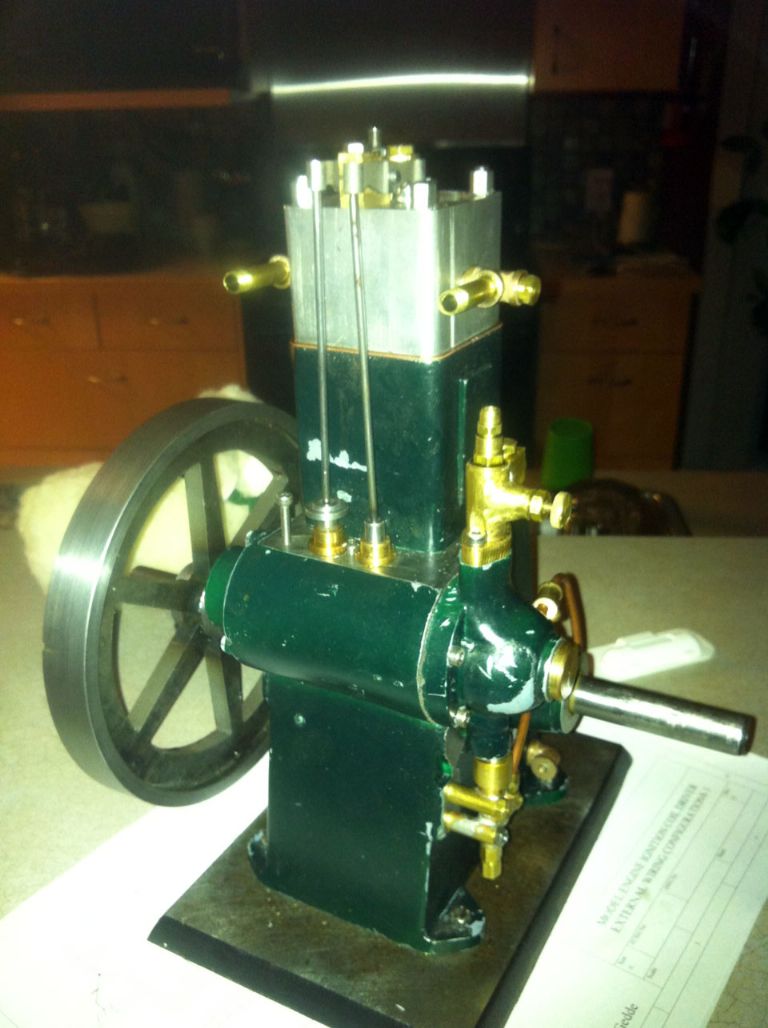

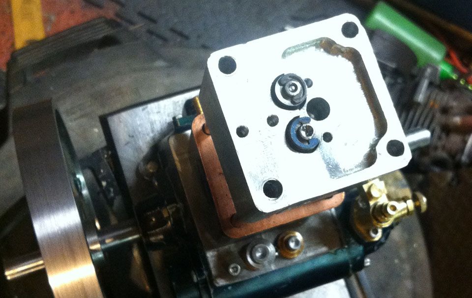

                            Worked on it again last night. I made the second valve, 2 of the spring caps, and installed them in the head. I made up a couple of "quicky" pushrods to see haow everything works.
                            Pleased to say that everything does work, mechanically! Inlet valve refuses to seal after much lapping with coarse and fine lapping compound. The exhaust vale works great.

                              I am going to put caps on the valve stem tops to cover the center drill depressions. You may also notice that the adjuster bolts are not fitted(nor made!). My ADHD cut in late last night and I just had to see the valves opening and closing.

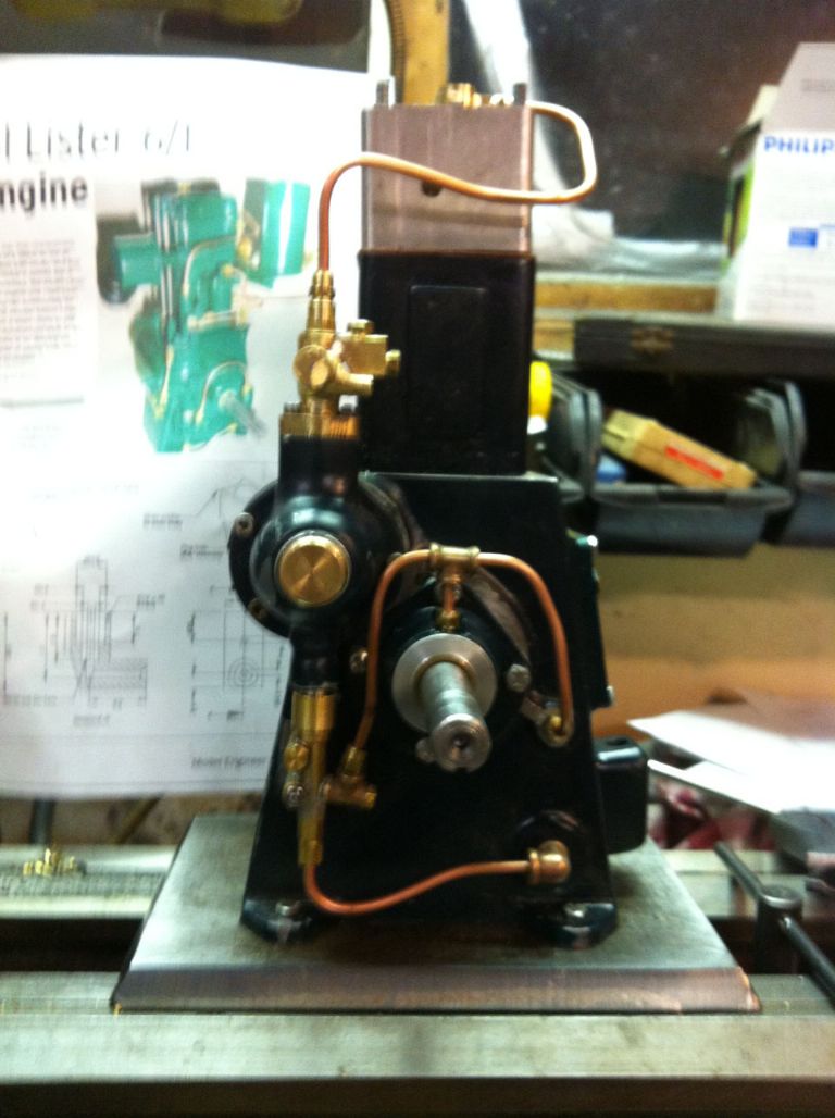

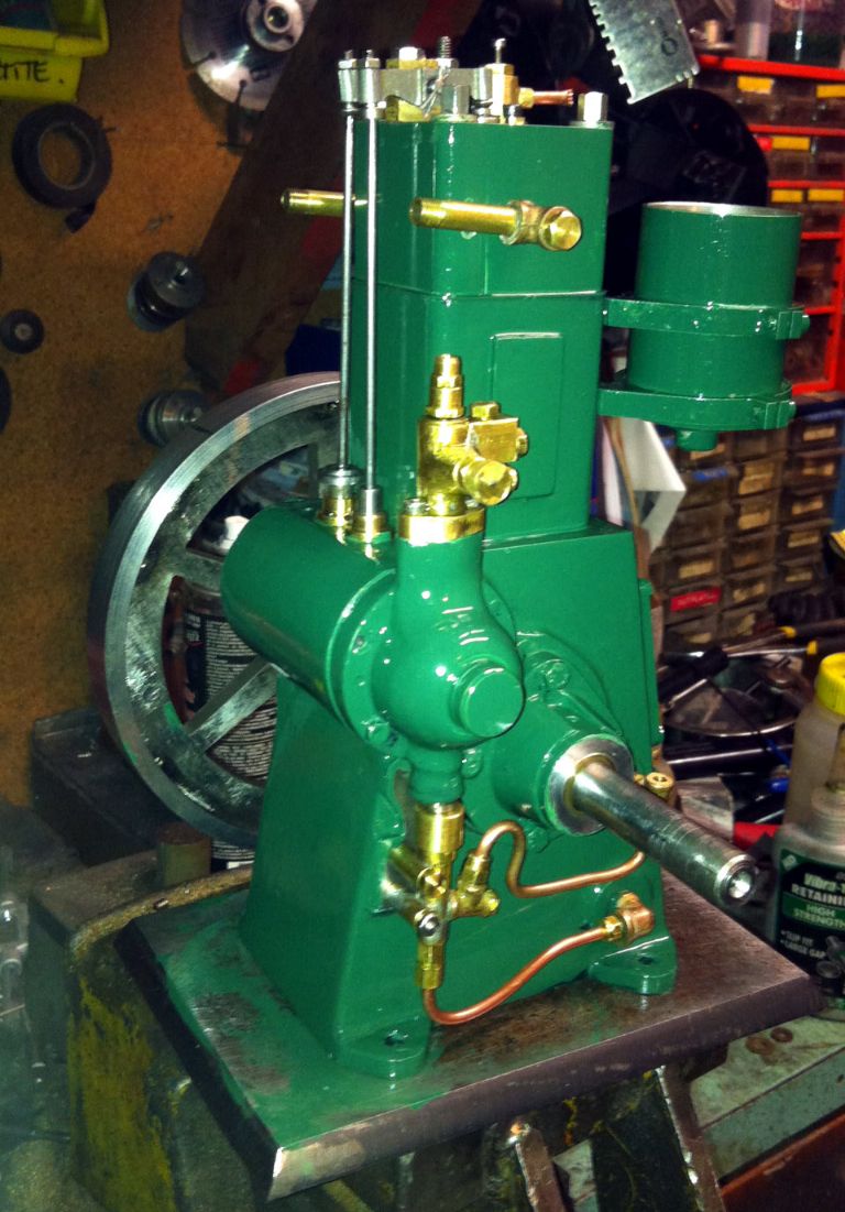

                                This is the latest photo of the Lister.
                                The fuel delivery pipes are not installed due to the pump and injector mods I am doing. The fuel tank needs a top yet.

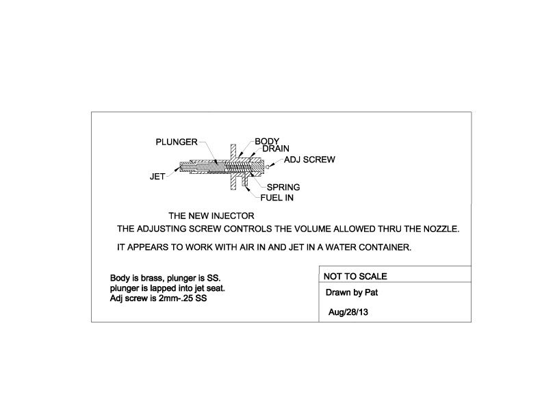

                                  @hobbynut

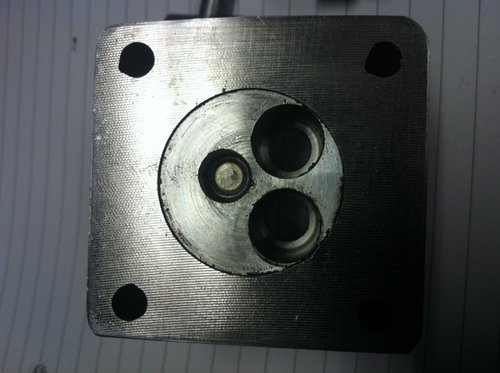

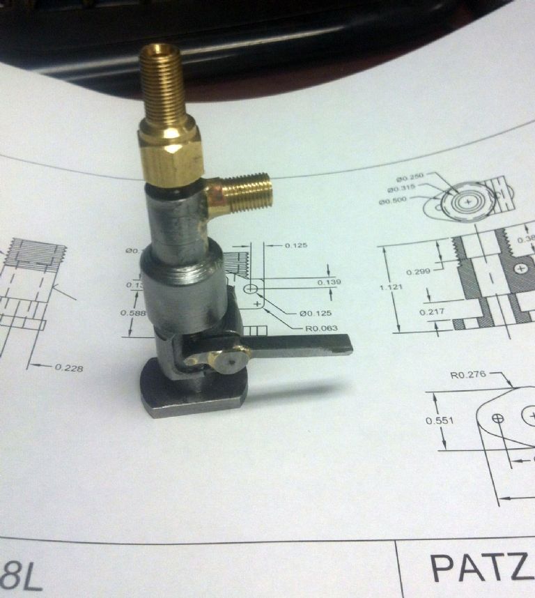

                                  This is my new injector detail. I inserted the jet into a water bottle and put air into the fuel inlet. I could control the amount of air escaping minutely with the top screw. what the spray will be is another question, but I imagine that with such a hard path for the fuel, it may be OK. I will be trying this in the next few days.

                                    That works….kind of.
                                    There appears to be too much bypass tho'. Quite a bit of fuel comes out the drain hole. The bleeder valve on my pump is not working, I'm not sure why yet, I am going to do some invetigating tonight.
                                    I also think that I do not have enough compression. My head gasket is about .75mm thick. I am going to replace it with a much thinner alum. one, The rings may also be replaced, as there appears to be some fuel making its way into the sump….blowbye I would say.
                                    Anyway, thanks for following, I am still perservering on the Lister.

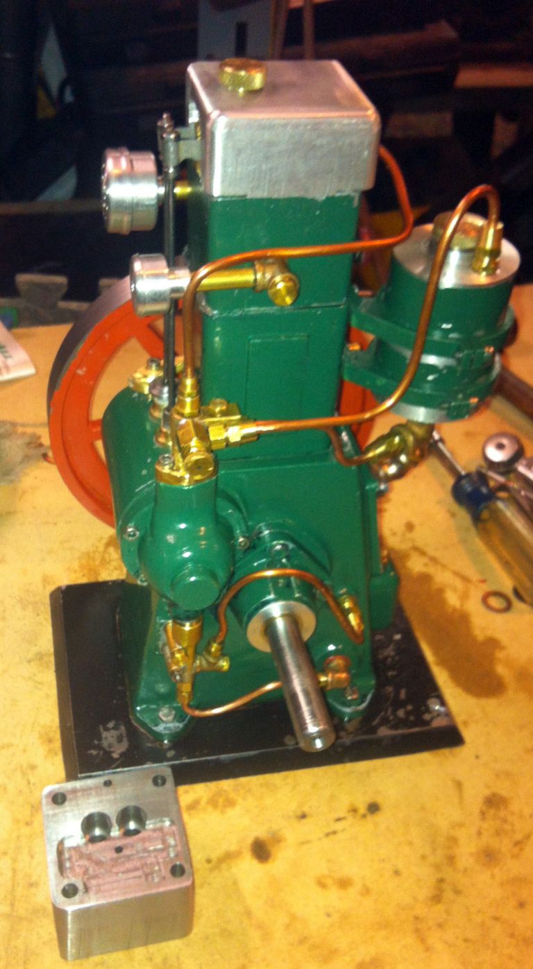

                                      The fuel pump was rebuit and the bleed moved and made to work. I have now put it all back together with all the pipework completed.
                                      The lubrication delivery pipes work, as does the bleeder from the pump. Now all that needs to be done is stop the injector from leaking and getting it to work consistently.
