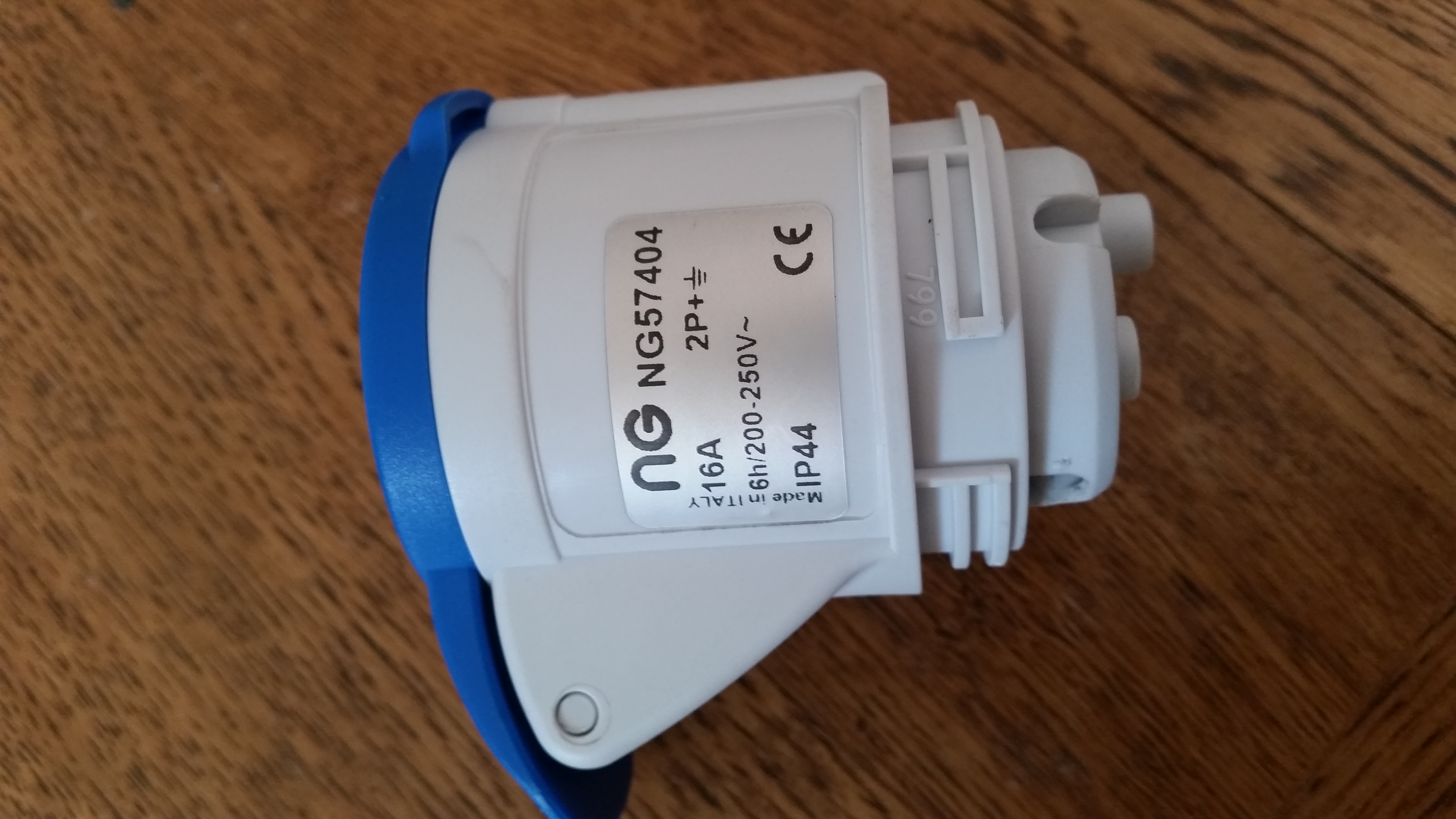

      My dad had an Axminster 150 x 2000 belt linisher arrive this morning but he can't get it starting… and as Axminster aren't open now until Tuesday, I thought I'd ask here to see if any kind folk might be able to point us in the right direction
      This model: http://www.axminster.co.uk/axminster-engineer-series-150mm-belt-linishers-ax942736
      It is single phase.
      We bought the correct cable, plug and fuse but when we start it up, it begins for less than a second but then cuts out immediately and won't start again – the fuse is blown. A new fuse just repeats the problem, it keeps blowing. Nothing trips.
      Here are the details we're given on the electrics via the manual (you can also download the manual via the link above)

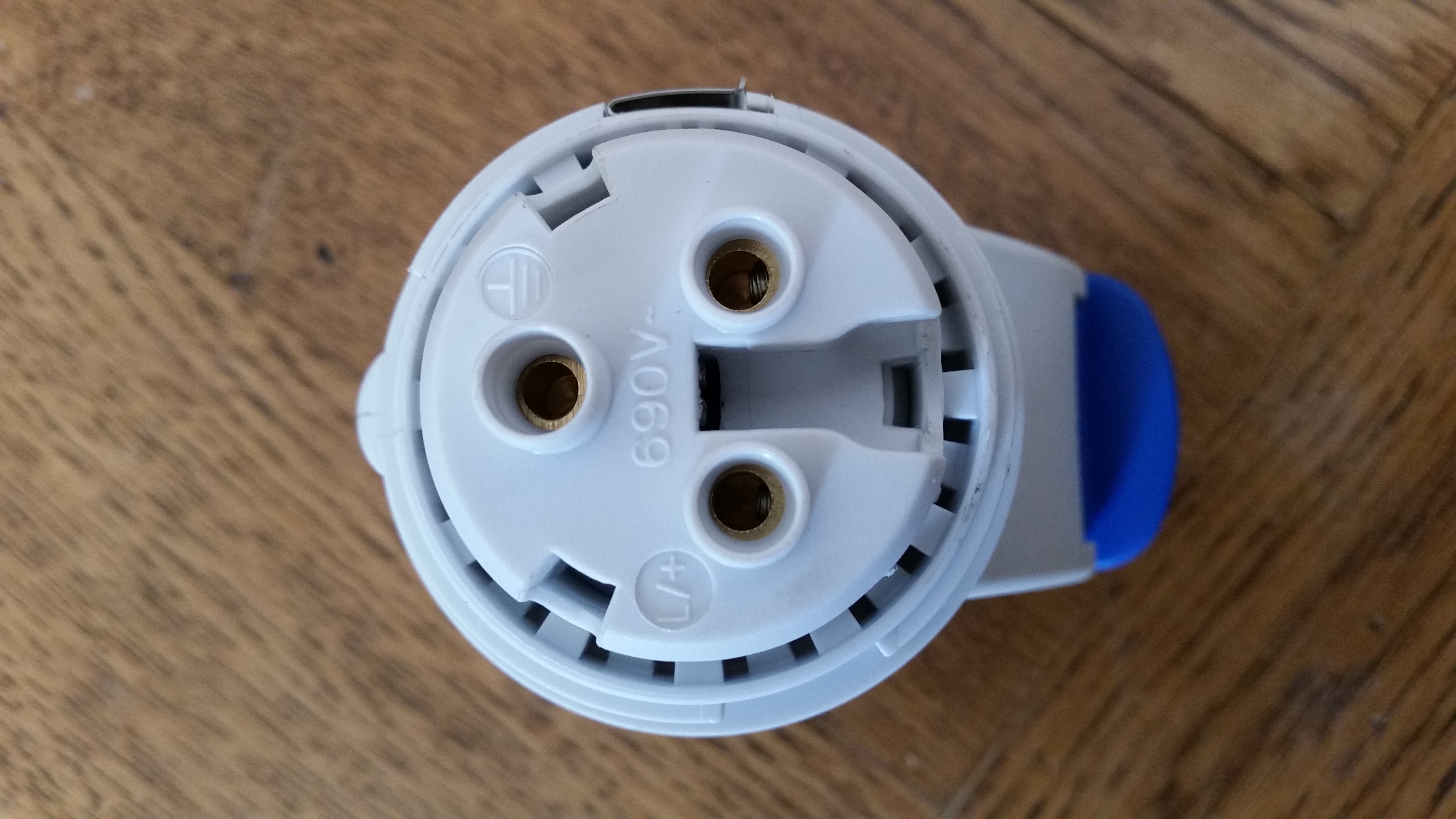

      A couple of photos of the plug that he wired below. L/+ means live, we assume??
      Any ideas what could be going wrong here? The cable is 5 meters by the way, I assume that alone wouldn't have any effect on the fuse ?
      We're a bit lost as it seems we've done everything right… He was quite excited when it arrives but the enthusiasm has vanished since it won't start up

          What is the rating of the fuses that you keep blowing? Can you pull the belt over by hand, or have you tried starting up with the belt tension off?
          There seems to be a discrepancy between the blurb in the catalogue that suggests a 10 amp fuse and the wiring diagram in the manual that suggests a 12 amp fuse. If the full load power is 3kw and the voltage is 230 volt then that is 13 amps continuous. Looks like you should try a heftier (but not silly big) fuse. It's most probably the initial start up current that's popping the fuses.

              I would think that starting a 3.0kw motor on a ten amp fuse is likely to pop the fuse, try removing the abrasive belt and see if it will start off load. Personally I would be inclined to up rate the fuse and see if it starts, switch off quickly if it does not start. The ideal solution would be to check the motor does not have a fault before deviating from the recommended values. As it is brand new it is probably best not to do anything to invalidate the warranty and wait till Tuesday. Slipping the abrasive belt off will not invalidate the warranty.

                What have you got on the other end of your 5m lead, a 13amp plug top? You really want to wire that 16A socket directly

                  Update: Tried 13 amp fuse, no real difference. Begins to start then cuts out immediately. ..

                          If its rated 3kW @ 230V, that's about 13 amps. It's a bit like trying to run a fan heater on full heat AND a kettle on the same plug.
                          As Jason says, it should be wired directly to a suitable amperage supply with a 16A socket. Even a 13A fuse will be pushing you luck and almost certain to overheat even if it doesn't keep blowing.
                          Axminster's website says: "N.B. These machines are designed to be bolted to the floor for stability, and we recommend that they are hard wired by a competent electrician."
                          Edit the manual is confusing as 10A fuses would be OK for 3-phase use, but not single phase.

                            If you are going to be using machines that will draw these sorts of current then get some 16A wall mounted socket outlets wired back to your fuseboard on a dedicated circuit.
                            The start up current is likely to be more than a 13A fuse in a 3 pin plug can take.

                                even on a 16A supply you will probably need a type C RCBO (ie a slow overcurrent trip) to allow for the starting inrush current

                                              The motor is rated 3kW at 220V. Doesn't that mean it would be a 3.6kW motor at 240V? If so that's nearly 15Amps.
                                              My guess is that the machine's motor is too big for a standard 13A feed hence Axminster's recommendation to have it wired by an electrician. .
                                              #314069
                                                Yes best bet is to have a separate fuse board in the workshop with circuits for lighting, sockets and also the heavier machines. Talk with your electrician as you may well now be drawing more current from the house than you were before so cable sizes etc need to be right.
                                                Had the machine been able to run off a 13amp plug then I'm sure Axminster would have supplied it with one rather than the 16A
