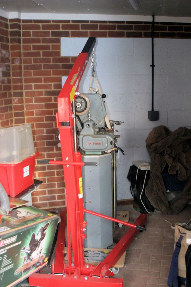

                                        CJ – Balance point and lifting demo (fully practical and done by 80 yr+ with knackered knee and back problems) ML7B – raised onto a couple of Lidl's finest 'pensioner's skateboards'!!
                                        rgds
                                        PS – lifting strap was ex-Mil 5000 breaking strain tie down webbing.
                                        B
                                        PPS – crane was 1 ton engine hoist and assembly of THAT was the most difficult bit!
                                        B
                                        Edited By Cornish Jack on 31/03/2018 11:46:41

                                          CJ2 was lucky to get away with that, it's a very unstable lift, nothing stopping it toppling towards or away from engine lift. If the lifting point is below the centre of gravity you need a 3 or 4 point lift. 2 straps splayed out so that you get a 4 point lift would have been much safer. Or move the single strap towards the headstock a bit and tie a bit of rope from the hook and round the tailstock end of the bed. Alternative lift each end separately and use the "piglet" as described above to get it onto the skateboards, then put bolts through the front mounting lugs to stop it toppling backwards. I reckon you could do that with a crowbar, no hoist required (apart from getting the lathe onto the stand)
                                          I know it all sounds pedantic, but it doesn't take much more effort to do it safely, and the consequences of getting it wrong are high.

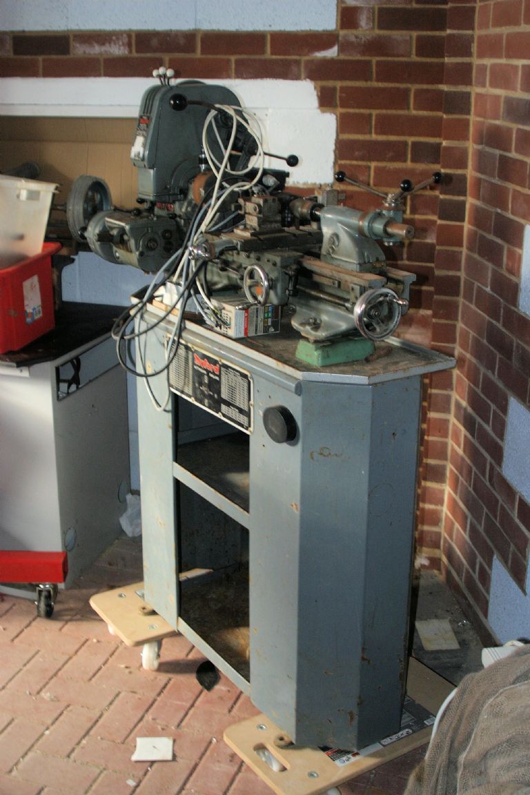

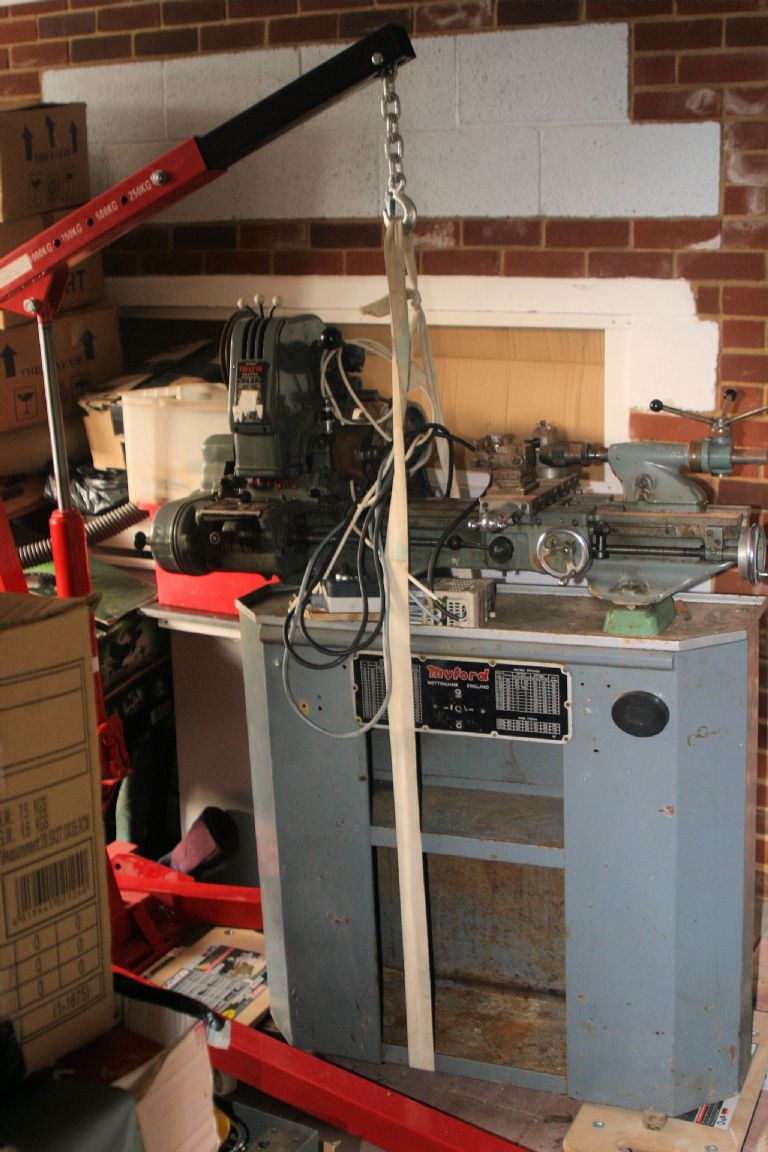

                                              C J
                                                @cj88518
                                                Many thanks for all the advice and suggestions.
                                                I want to just lift the lathe onto a strand.
                                                I prefer to use a crane because when I got the lathe it's quick change gearbox was out of line and having set it just so I don't want to risk putting it out again with lifting.
                                                I will do some trial runs with the crane as I need to get the lathe onto the floor or a dolly first as it's sort of in the way on the kitchen table at the moment smiley
                                                img_5928.jpg!
