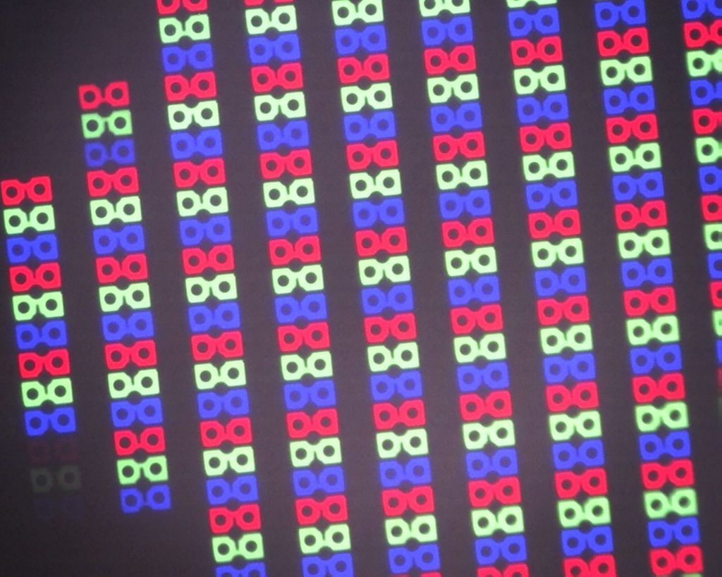

                                              #252625
                                                Totally random, but this closeup of a phone display may be of interest, I can't remember if it was LCD, LED or OLED. Although he filename claims it was LCD I would expect larger square pixels with LCD so I guess OLED. Interesting how little of the area actually lights up.
                                                Not bad for 200x with a £30 microscope.

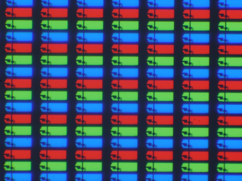

                                                #252636
                                                  Here is the 'retina' display on my iPod Touch, for comparison:
                                                  Interesting structural differences.

                                                    #252668
                                                      Predictable response, Neil
                                                      You are of course correct in that statement, but that's not really relevant to the point I was making.
                                                      The real origins of the 'Retina' name were explained in the early days, but I'm blowed if I can find any reference now … Because Apple adopted the 'retinal resolution' aspect as the marketing message. **LINK**
                                                      The origin of the name was to do with the innovative construction, which allowed the sub-pixels to be more closely packed … This involves putting some of the wiring in front of the light emitters, and is therefore reminiscent of the way that our own retina is built [with the nerve layer in front of the receptors].
                                                      I didn't post the photo for any sort of 'competition' … Just to show a different bit of engineering
                                                      [quote] Interesting structural differences. [/quote]
