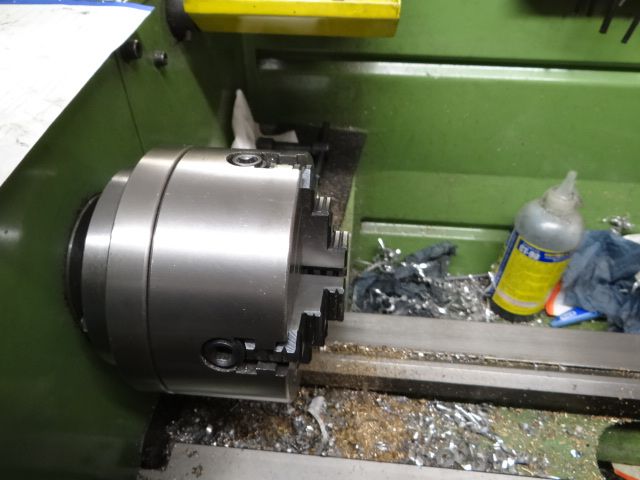

                                    Not all strobing is strobing!
                                    The same effect can be caused by pure unmodulated light bouncing off a shiny surface like a chuck jaw.
                                    In this picture I've angled the stopped chuck so the jaws don't bounce light into the camera:
                                    And in this photo the chuck has been turned slightly to angle the jaws to reflect light into the lens (or eyeball):
                                    When the chuck is rotating the jaws are much brighter at one angle between eye and light source than the others, which is enough to fool the brain that the chuck isn't turning, or might if it wasn't for gear and motor noise.
                                    In my experience real strobe effect caused by rpm matching the frequency of a flashing lamp is quite hard to see unless the rotating item is strongly illuminated by flashes whilst the rest of the workshop is dim. Strobe accidents were certainly a problem on noisy poorly lit old-fashioned factory floors. They tended to be filthy black, with relatively few lamps in the ceiling for general illumination, maybe a work-lamp on the machine and lots of distractions. And the racket caused by surrounding machines made mistakes far more likely because the operator couldn't hear his own machine.
                                    I think strobe effect is unlikely to catch a Model Engineer out in his own workshop partly because we know when our machines are turning and partly because decent lighting makes strobe effect hard to see in a reasonably bright room. Anyone ever had an accident due to strobe or my reflecting effect?
