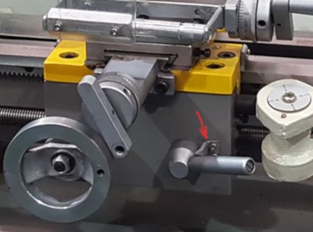

      Hi all, I’m new to the site, and have just bought a Chester DB7, lathe my question is, the lead screw handle has a bracket that limits the travel, can the bracket be removed and will the gauge still engage ok, I can’t really see it’s perpose anyway.

              It’s the lever that engages the lead screw, there’s a small bracket with a notch, the warco 180 is the same as my Chester, apart from the bracket, I can’t see what the bracket does apart from making engagement aqward.
              #442089
              Journeyman
                @journeyman
                I assume the bracket arrowed in the image below:
                Seems to serve little purpose and looks quite crudely made. Could it be a shipping device?

                  Does it limit the amount of disengagement? Agree with John it seems pointless, unless the cams or slots opening and closing the half nuts (or is it a single half nut) are loosely toleranced.

                      The bracket is there to prevent accidental engagement of the lead/feed screw, I found that when it was it new it was a bit notchy, Pulling the sleeve handle up to clear the notch and getting clean engagement is a bit of a knack which develops over time. It helps if you move the saddle with the hand wheel at the same time,usually away from the chuck this help aligning the half nut with the thread on the lead screw.

                        I wondered if the handle needs to be pulled out, to clear the bracket, so that it can turn to engage the half nuts.
                        This assumes that the bracket is there to ensure that the half nuts are not engaged accidentally.

                          Thanks for the answers all, Pulling The handle out and pushing down does release it a bit but when it’s released back in, the handle stops half out the half hole in the bracket, do you know if the handle is supposed drop out of the bracket completely, or is it just tight because it’s new, many thanks guys.

                            Sounds liek the halfnuts are riding on top of the leadscrew threads, stopping full handle movement. Are you doing this with the leadscrew rotating? It might take a second or two for the nuts to fully engage with the leadscrew threads. Or if not rotating, you might have to move the carriage along with the handwheel until the nuts drop into full engagement.

                                Thanks all , I have sent Chester an EMail , just waiting for reply, but have since found the gauge wasn’t fully engaging in the lead screw, stopping it turning properly, and all what was needed was fully tightening the Allen crew locating the gauge on the spindle, it was slightly loose so when moving the handle down it wasn’t engaging in the thread properly, Many thanks again.
