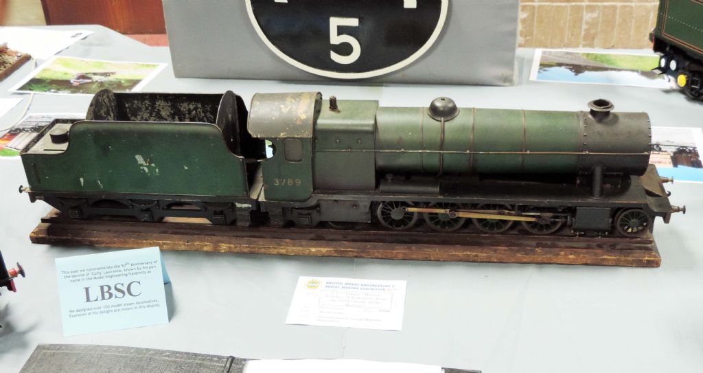

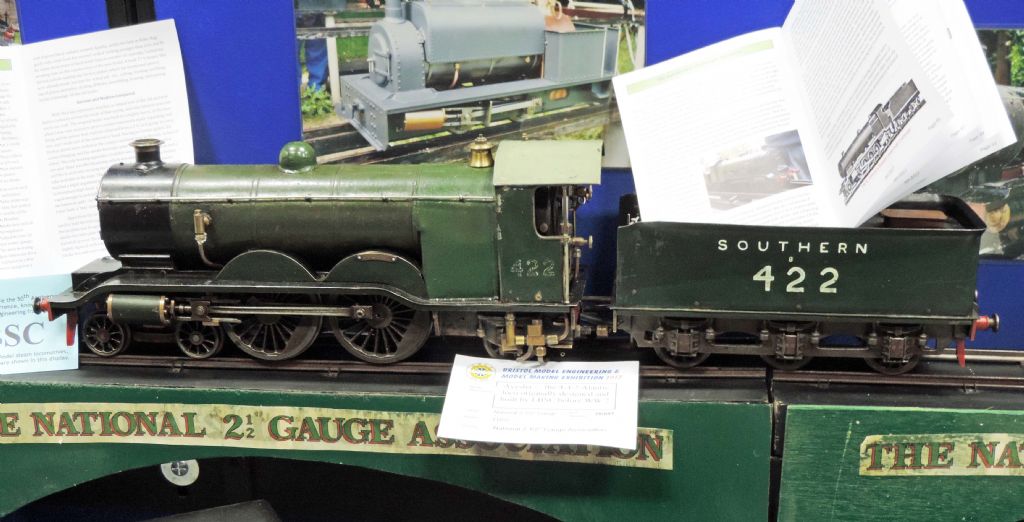

The 2 1/2" gauge association had Ayesha on show at The Bristol Model Engineering show last weekend. The show theme was the LBSC 50th anniversary:
More unusually, Greenly's rival Loco was also on show, on a different stand:
