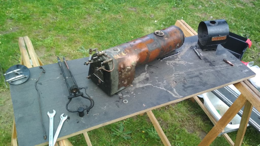

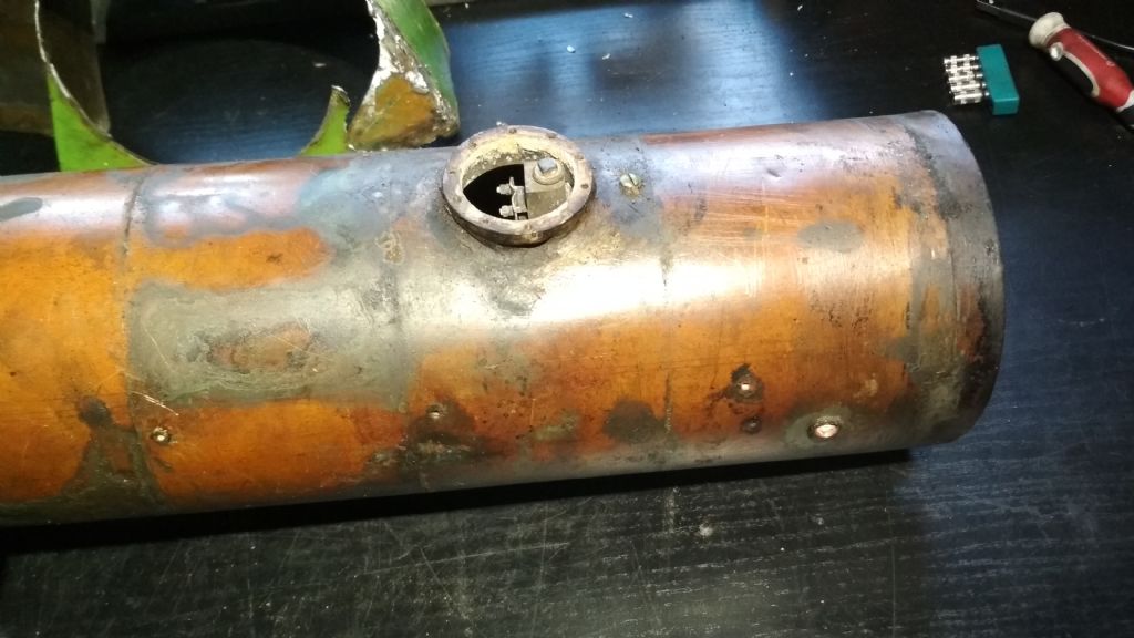

      Dear Fellows,
      in order to take the boiler for cleaning and inspection i hade to take all the wrapping off the boiler shell. It turned out it was soft soldered (grrr!), including the bands "holding" wrapping brass sheets sections. To desolder them i had to head them up to the temperature at which paint came off… Not only that: firebox section was badly bent and damaged during this job.
      This is my first loco and i don't have experience with sheet metal work. Could you advice me how to make a new wrapping? rounded sections are fairly easy – i'll make cardboard patterns to make all the necessary holes (for water check valves, chminey, steam dome, etc.) however the firebox section is a nightmare.
      Another thing is i found the builder didn't "lined" the boiler. I don't know if it is a good word for that? I'm reffering to that thin insulation layer wrapped around the boiler shell, under the final metal sheet wrapping. I know it is to reduce energy losses and i'd like to use it when making new wrapping. However that insulation has thickness… Could you point me to the source where i can see what material is usuallt used for that? And what thickness should i use. What worries me is the fact that smokebox O.D. is now equal with original wrapping (brass sheet ca 0.5mm thick). If i add, say 1.0mm thick layer it will increase overall O.D. of the boiler by 2.0mm and it will not be equal to the smokebox O.D. anymore.
      What you think about that?

          If it is a soft soldered boiler (rather than being caulked with the soft solder, in the odd place or two) then you have a potential disaster. My advice is to scrap it and build a silver soldered boiler.
          It will never pass the boiler inspection code and hence will be uninsurable. Sorry if I am the bearer of bad tidings.

                      The OP stated quite clearly that the boiler was soft soldered. Look at his second sentence. I am fully aware that stay caulking with soft solder was the norm until fairly recent times.
                      IF the boiler is soft soldered, as the OP says, then it is a potential disaster waiting to happen. Many years ago,I saw the results of low water level and a soft soldered boiler. It was in a model boat and when it exploded, the boat sank without trace. It was fortunate that the boat was a fair distance from shore and no one was injured!

                          I read that as meaning the cladding/wrapping was soft soldered, as LBSC, the designer suggested
                          If the boiler is rivetted for strength and caulked with soft solder to seal those joints it is far more complicated as, if the boiler has been tested in the past then it could have acquired 'grandfather rights' In which case, while a modern boiler would be better as you suggest, it would be up to the individual tester to decide whether to test it, and then to decide on its condition. It is unlikely that a new design would be published using this method of construction, and if not a published design the boiler inspector will need to see the design before construction starts and would probably say no at that point. But this is an existing boiler, so such criteria don't apply.
                          Unlike the one applicable to smaller boilers, the current boiler code does not specifically exclude a rivetted and soft soldered boiler, merely that joining procedures have been satisfactorily undertaken and all joints are sound.
                          Modern all silver soldered boilers are undoubtedly the way to go today, but the older methods, if sound, can still be re-tested and accepted at the inspector's discretion.

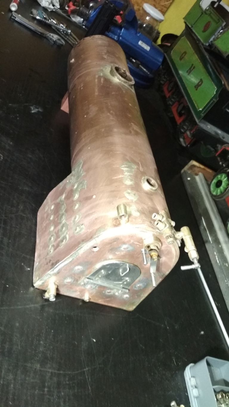

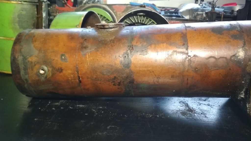

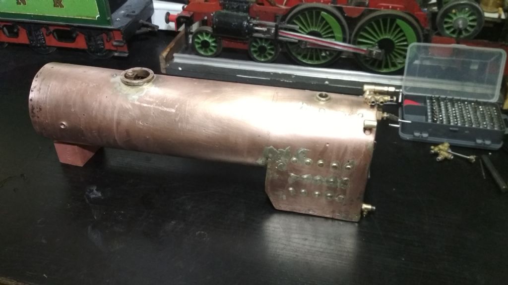

                                    by telling "it was soflt soldered" i was reffering to the WRAPPING only not the boiler itself Boiler is silver soldered for 100%.

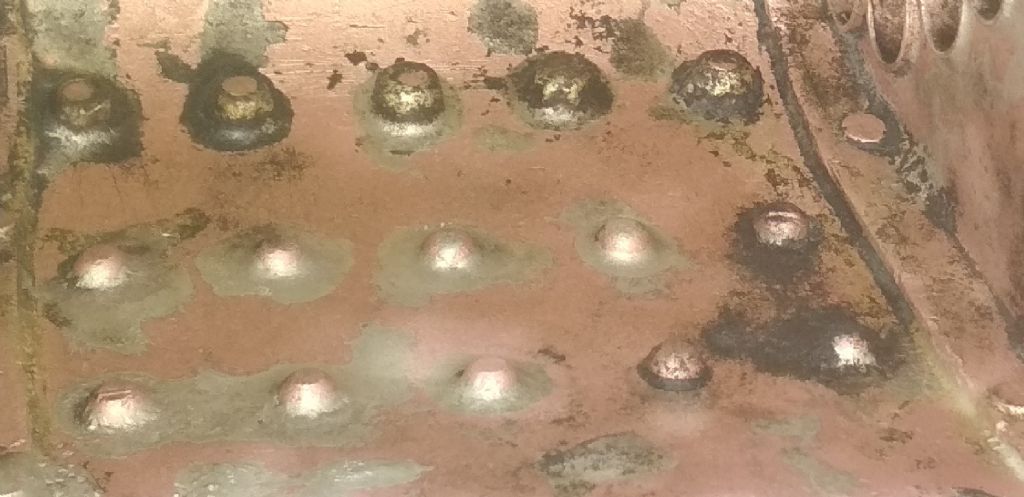

                                    Here's the boiler AFTER i removed the wrapping brass sheets. The below photo was taken during the cleaning. You can see, at the lower right corner of the firebox crown fundation (is it good naming?) – it is soft solder. It looks like someone was repairing that? On the forum i heard that was/is the normal practise. Is it?

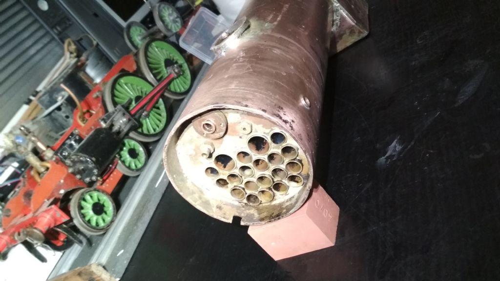

                                    Here is the boiler after i cleaned it:
                                    For cleaning i used soda blasting technique – never heard someone using it for boiler cleaning but it is completely harmless for boiler elements and solders. I had weak compressor available and the cheapest "sandblasting kit" so it took a while to clean it and the cleaning process for sure can be stronger when using better gear, however i'm pretty happy with the result. What you think? The good thing about soda is it is not aggresive, user friendly (eventually you can brush your teeth or bake a cake with it) and after cleaning just put boiler in water to dissolve any soda leftovers.
                                    Another view – preparation for cleaning:

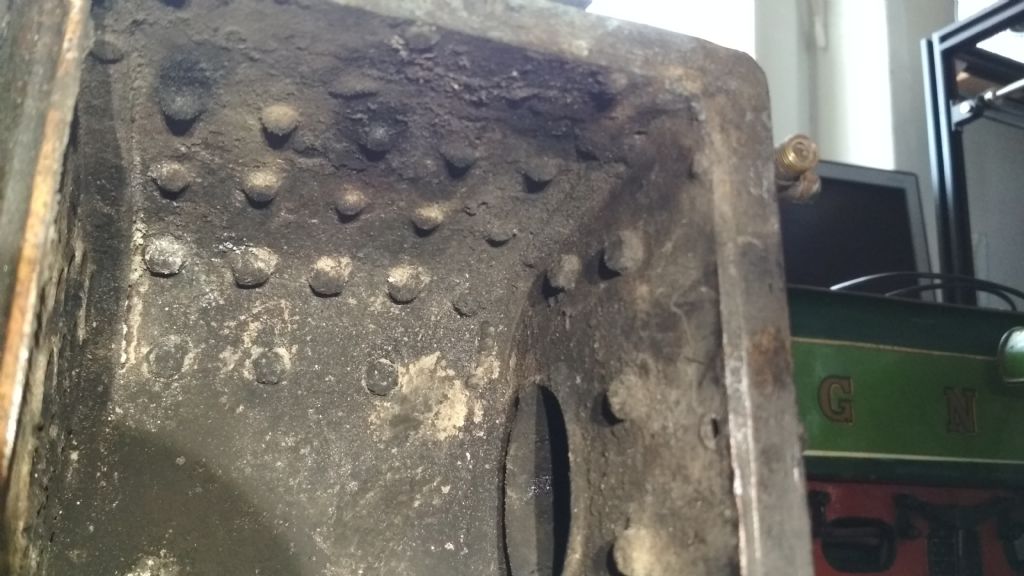

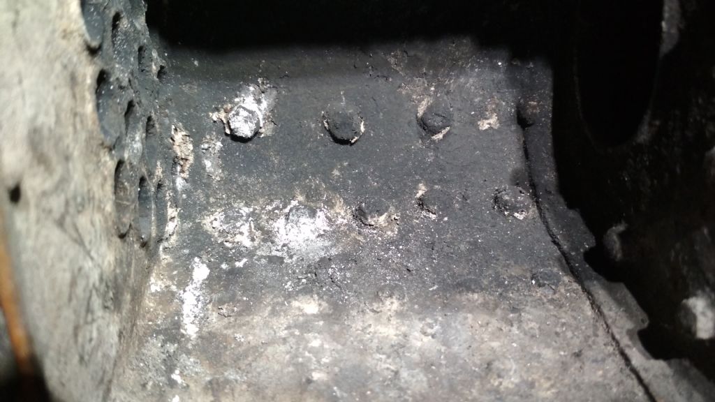

                                    Inside of the firebox – do you thing these whiteish thing on the stays are the signs of leak?

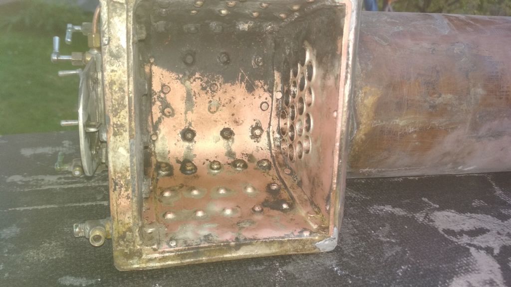

                                    Smokebox side after cleaning:
                                    Thank you for explaination guys. If i manage to find 1mm thick insulation material i think i'll try to use it as i need to make new wrapping anyway. Smokebox is ordinary mild steel. Maybe i'll make slightly bigger one to accomodate O.D. increase of the boiler?

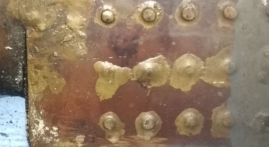

                                        Difficult to tell for certain but that looks like it is fully silver soldered because the side stays look like snap head rivets? I suspect you know this but it needs to be seen by your local inspector before you go any further (difficult at the moment I know).
                                        The chassis in the background looks nice.
                                        A soft soldered repair – if it is soft soldered repair might have a hard time with your inspector.

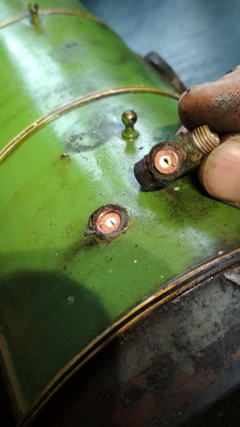

                                          The problem is there is no live steam models boilers inspectors around me. ZERO. In Poland there is no live steamers clubs or associations. No market for that. We had different problems in the past…
                                          Now i'm collecting necessary taps and dies to make plugs and new fittings. Some of them broke when trying to undo threads! What i dont like is the way hand rail going along the barrel are fitted to the boiler. These are screwed into the boiler body directly! I bet someone used glue for that as all of them need to be lined-up accurately to pass the rail bar through the holes. Unfortunatelly some of them are broken. How to fix it? I plan to drill and cut new thread in the boiler shell (the shell is 3mm thick i think) and screw in plugs using Locktite (high temperature). These plugs will have blind threaded holes for new handrail fittings – this way there will be no problem with leaking handrails fittings. You can see these small threaded holed here:img_20200501_184944.jpg
                                          And some broken fitting – boiler water feed check valve:
                                          BIG QUESTION: how to remove scaling from the inside of the boiler? It is not bad, but i'd like to descale it / remove "limestone". I know the broken feed valve is showing a lot of scale but i've check inside with boroscope and looks good. I have a problem with regulator but i need to start new thread as it is quite different story.

                                                      Back to the boiler: it is all silver soldered. Stays are also silver soldered. The photos are taken before i finished cleaning.boiler_stays_outside.jpgboiler_stays_inside.jpg
