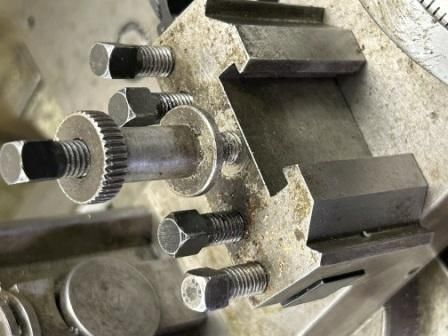

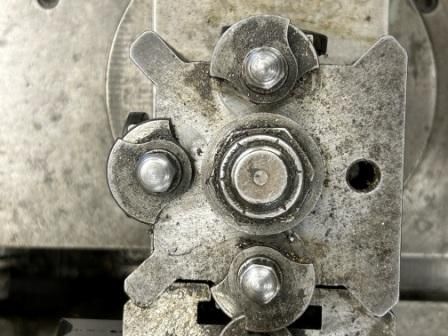

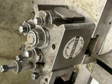

      img-9400.jpgimg-9399.jpgI find that I could do with some extra tool holders for my Colchester Bantam. Despite searching the web for hours, all I get are general descriptions rather than what I need. I though I had found the correct one at Zoro Tools (Type 1 is a match in all dimensions they give, which does not include angles). Unfortunately they told me that holder was specific to their tool post.
      I did find one article that suggested Colchester changed form their own post, to Dickson, and that may be what I have.
      Could anyone help by telling me exactly what my tool holder is so I can search, or if they know of any retailer that sells them please?
      Dimensions are, length 73mm, overall width 31mm, height 43mm. Tool slot varies between 18-22 height and 14mm wide.img-9398.jpg

        John Haine
          @johnhaine32865
          Dickson type. RDG may stock?
          #659254
          Emgee
            @emgee
            See this page at Lathes UK for some dimensions of Dickson toolholders.

                        I don't think the tool post holder height is the deciding factor, it's the centre distance of the vee slots and the height of the tool post itself that determines what to call it. As ever, Tony at lathes.co.uk has the definitive chart here but they seem to be an "S" number not a "T" number.
                        If the overall length of the holder is 73 mm, then that makes the vee centres credibly 63 mm, which in turn identifies the variant as a T63, previously known as a T1. I have several, all are 43 mm high though they have a variety of tool slots mostly 19 mm though some will accept 22 mm.
                        That's a re-badged Dickson quick change tool holder sold as an alternative to the four way tool post Colchester also offered. I fancy the business about there having been an alternative tool post is a choice between a four way and the Dickson style. Whether Colchester badged Dickson or made their own others may know, but I can say that I have tool holders which have the original Colchester part number, also genuine Dickson ones and I've bought no-name equivalents including the relatively cheap Indian ones and they all fit the toolpost without any debate about the accuracy of the vee spacing. No wobble.
                        As for Zoro's suggestion that their tool holders only fit their tool post, I think that's probably them being cautious. I have at least one of their holders, fits my tool post perfectly fine. I believe my tool post is as originally supplied by Colchester, though the badge has worn off long since. But the lathe came from AEA Harwell, so I doubt if they bought anything other than the manufacturer's recommendation.
                        HTH Rgds Simon

                          A quick blip on the googlenet revealed we've been here before:
                          Dickson Tool holders
                          and also that Dickson were part of the same group as Colchester so it would be pretty natural for a simple re-badge exercise.
