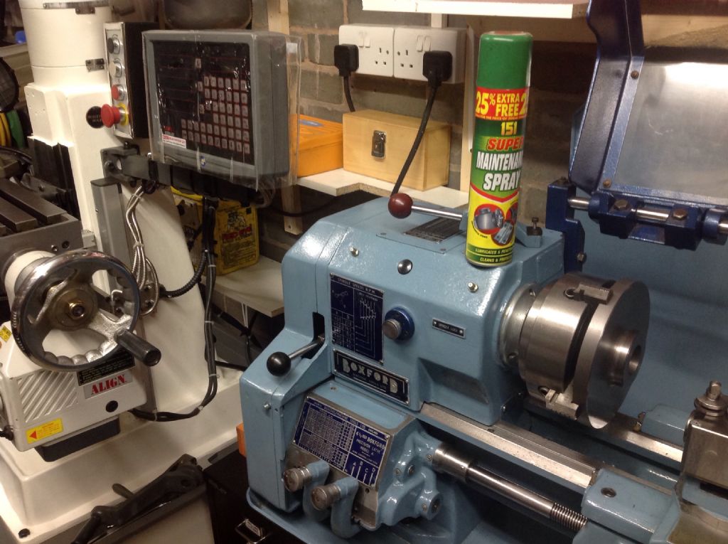

                                                  I use this stuff £1/can from local pound shop. Never pass it without getting at least 5 cans. Lubes and protects. Use it on loads of things.image.jpg
