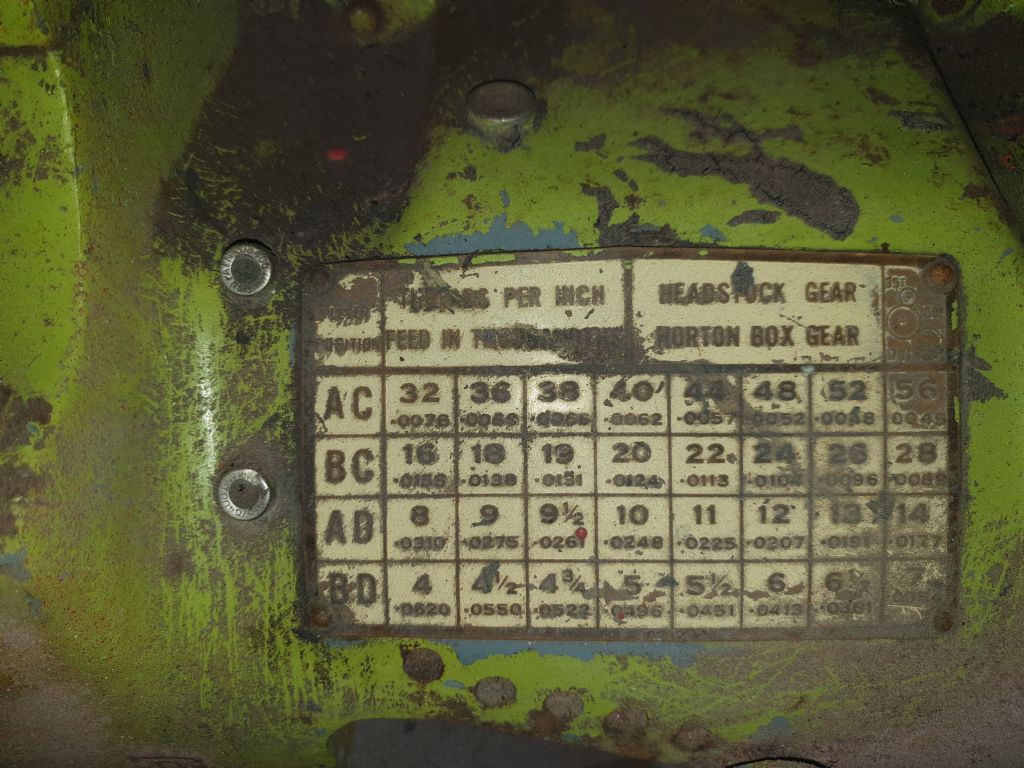

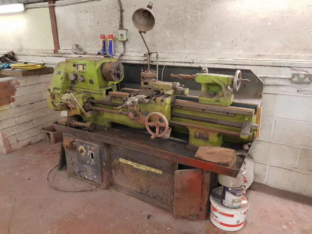

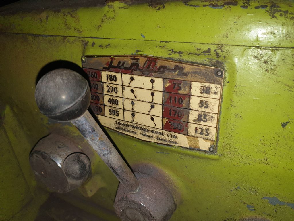

      I have recently inherited a Town Woodhouse lathe by virtue of buying a house with it still left in situ in the workshop, and because I have always wanted a Lathe it was a no brainer to try it.
      Now with the 3 phase switched on and the start button pressed it just seemed to be jammed with sparks coming out of the contactor. I have managed to get a wiring diagram for this lathe and it seems the whole machine was wired up badly and differently to the diagram, so I rewired it all to the original diagram and guess what ? It still wont start but there are no sparks now !
      So I am fairly sure it must be the contactor which was why somebody had attempted to rewire it, is it worth me just buying a cheap 25 quid contactor from ebay just to confirm this, and presuming this cures my problem what make contactor would people recommend as a long term fix.
      Sorry for the long post. Paul.

                                    Before you jump into electrics, can you turn the lathe by hand?
                                    Either at the chuck or belt /motor. It the spindle is locked you will get an electrical overload. Mis-cordinated controls could lock the spindle.
                                    Robert G8RPI.
                                    #567719
                                    Howard Lewis
                                      @howardlewis46836
                                      As Robert says, start checking for mechanical problems. BUT start at one end and work your way through.
                                      Is the motor free to turn?
                                      Then check through the drive train to the Chuck to see if anything is locked / seized.
                                      It might only be an overlength bolt, an overtightened clamp, or a seized bearing.
                                      It could even be that back gear is engaged without freeing the driven pulley from the mandrel.preventing rotation, or defect in the gear selection mechanism all owing two speeds to be engaged at the same time..
                                      Once a mechanical problem has been eliminated then start the same logical sequence on the electrics, starting at the power feed switch, and following through to the motor feed cables..
                                      Power OFF, use a multi meter, of course
                                      Howard

                                                To really be able to do a diagnosis we meed pictures of motor, inside motor terminal block, and inside the starter, but check the following in this order. all with power OFF!
                                                Remove belts and turn the motor, it should spin freely and cary on for a rev or two when given a hand spin.
                                                check for any motor bearing play which could be allowing the rotor to touch the stator.
                                                wrap a couple of turns of cord round the motor pulley and give it a brisk pull, does the motor still spin freely?
                                                Check the motor rating plate and see that it is a 3 phase motor!
                                                Remove the motor terminal block cover and check the connections and the visible condition of the insulation.
                                                Check the smell of the motor, it should smell slightly of varnish and oil, if it has a very strong burnt pungent smell, it is the motor windings that have failed.
                                                The motor will be star connected, three coil ends will be connected together on a spare terminal, and the other three ends will have one phase each connected to them, I am assuming the motor is a similar age to the lathe, and does not have the star connection point buried in the windings,
                                                With a multimeter set to resistance, connect one proble to the star point, and then test from each phase in turn, all readings should be virtually identical within 1-3 ohms of each other is ok.
                                                You really need a megger tester to check the motor windings insulation from earth, but if you get any reading with a multimeter from the star point or any phase to earth (motor case) be suspicious that the motor is at least damp, and needs drying out. If you have or can get someone to megger test the insulation you want at least 1Megohm to earth. Hold the megger test on, or keep winding if it is a wind the handle megger, and if the reading starts to improve, the motor is damp, use a fan heater, hot air gun or even domestic oven on low to dry it out.
                                                Check the belts are not catching anywhere.
                                                Turn the lathe belt pulley, Is the lathe in gear? Is the clutch (if fitted) engaged or disengaged? disengage the clutch, and put the machine out of gear so that the chuck does not turn when the lathe pulley is turned, and then check that the lathe pulley turns freely.
                                                In order to diagnose the starter, we need an internal pic, and also one of the motor plate and inside the motor terminal box. Does the starter "chatter" when the green button is pressed, ie does the amature jump in and out rapidly and repeatedly, if it does you have confirmed that the coil is working (in some way) so the next check would be the holding in contacts, and the overload tripping contacts, but without knowing what type of starter it is I can go no further at the moment, hope this helps!

                                                  Sorry for delay in getring back on here, been really busy with work, i will post up photos i have now.
