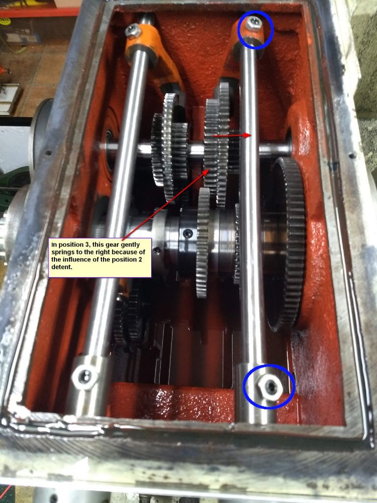

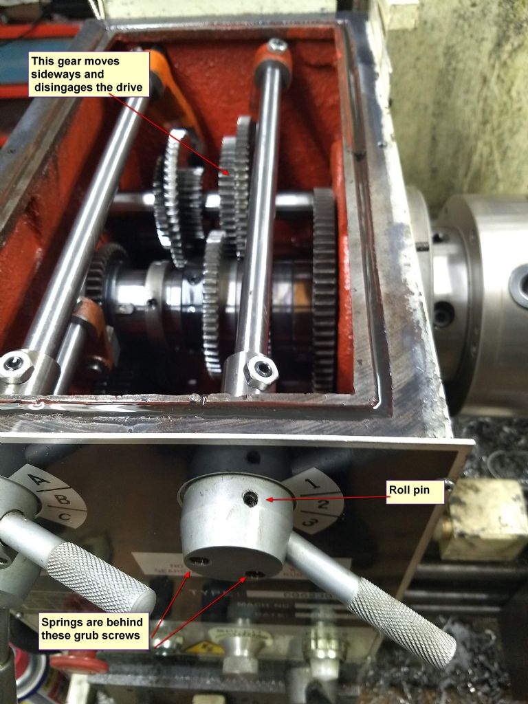

      I've had my Chester 12×36 geared head lathe for about 20 years, with no problems until now. I was turning a bit of aluminium when there was a clattering noise and the spindle stopped turning. The motor turned fine, but not the spindle.
      I took the gearbox cover off and noticed that a gearwheel cluster wasn't in line with the corresponding gear on the spindle. See attached photo. The cluster revolves fine but wasn't turning the spindle.
      Further investigation revealed that the gear cluster can move sideways by itself, without the turning the control knob. I think there should be a detent to hold it in any one of its 3 positions. The knob, the shaft, the fork, and the gear all move as they should, but when the knob is released there is nothing to maintain its position and the gear can drift sideways and disengage the drive.
      I removed the two grub-screws in an attempt to remover the knob and discovered that there is a spring behind the left-hand one (not sure about the right-hand one). And the knob didn't come off – it must be the roll-pin that retains it. I figured that adjusting the grub-screws would do the trick, but the only effect it had was to restrict the full movement of the gear. I haven't tried removing the roll-pin.
      Any ideas?

          Gary,
          Until you can get to see what is actually behind the control knob you don't know the full story. I would expect a ball bearing detent of some kind.
          Regards Brian

              Hi Gary,
              I am not a user, but I would guess there is a ball bearing in front of each of those springs, one of which should slip into a slot for each position of the gear. I’m guessing that if the gear ‘locks’ in one position, but allows it to float in the other, one detent (ball?) is stuck or worn, or the spring is broken.
              I suggest you fish out those springs and see if the ball, or whatever is behind them, is to specification. If not it looks like removal of that roll pin will be necessary to determine any damage to the casing.

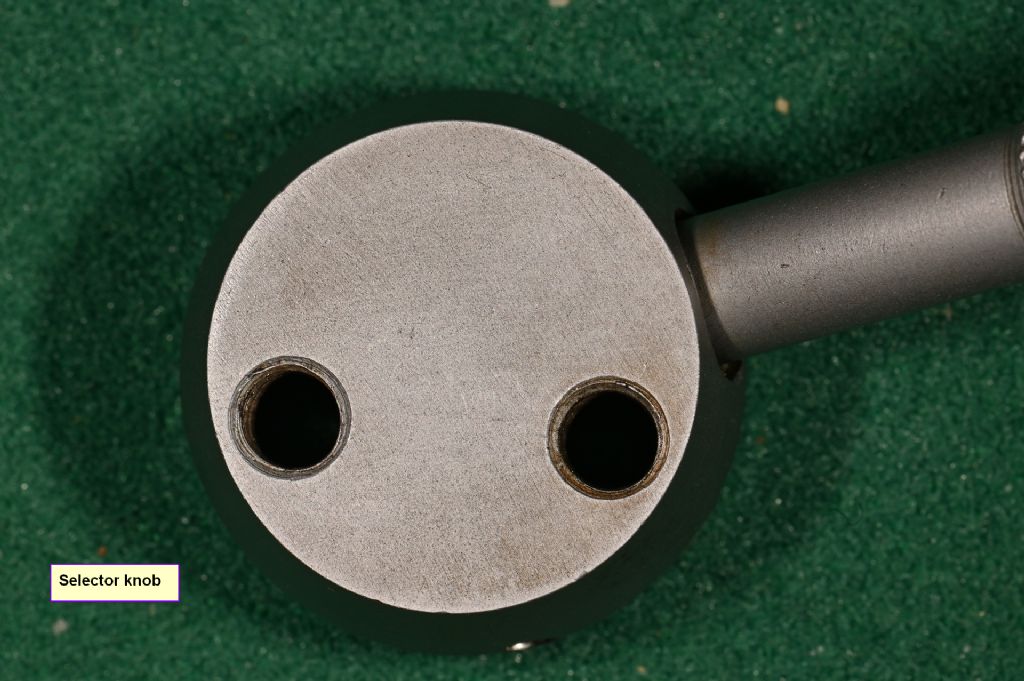

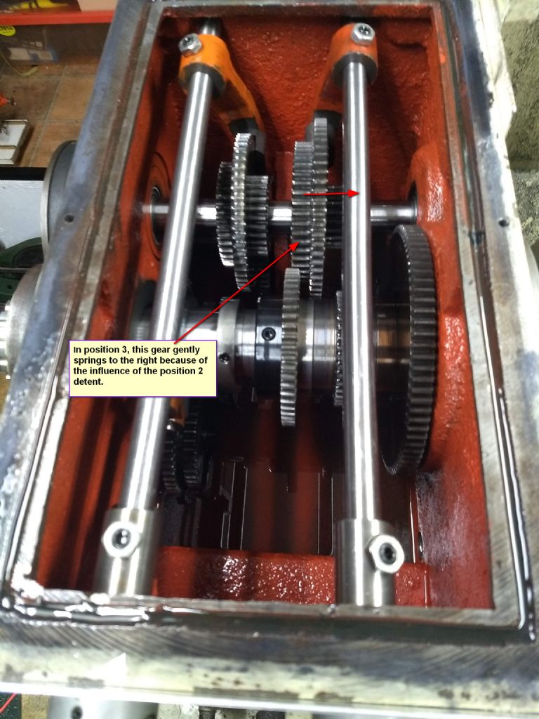

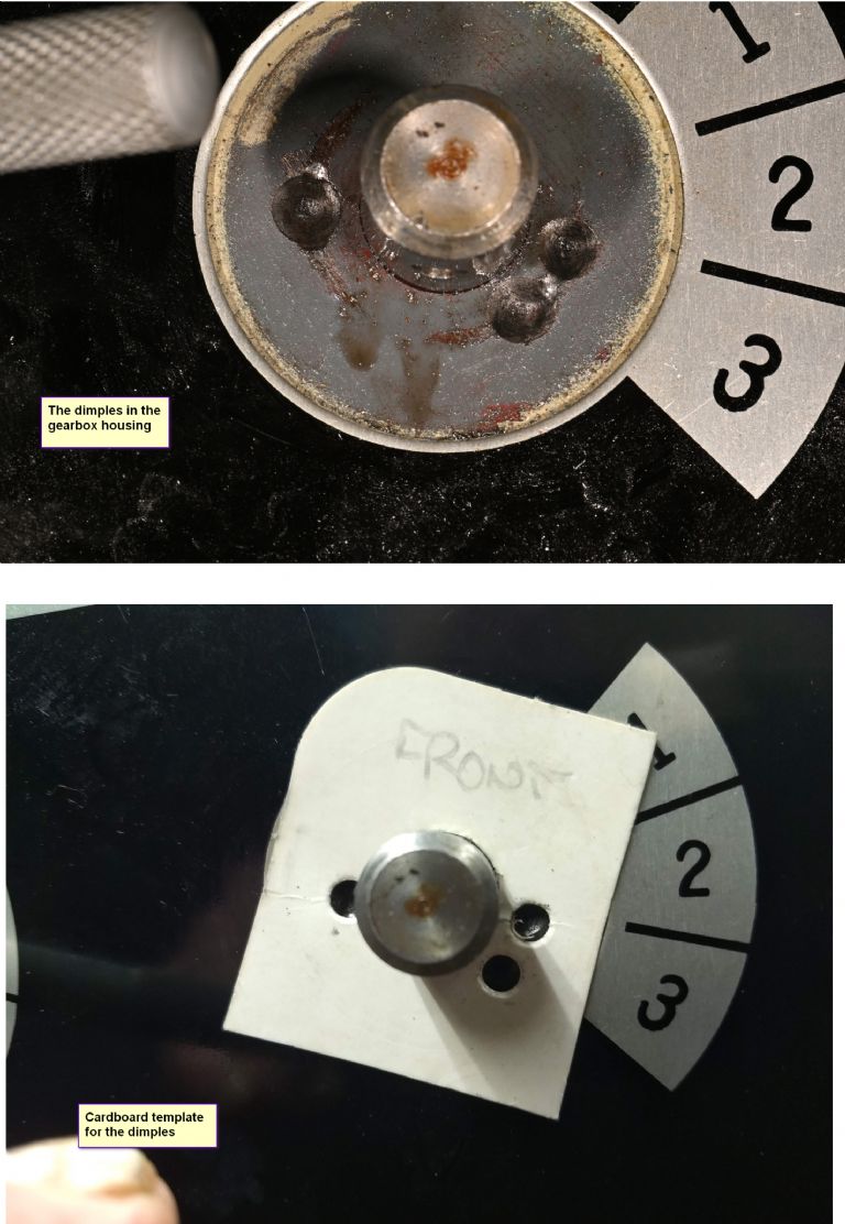

                          I've investigated much closer. I removed the grub-screws, springs, and balls from the selector knob and removed the knob from the shaft. Neither the springs nor the balls showed any signs of damage or wear. The detents in the gear housing also looked fine. I made a cardboard template that fitted on the selector shaft and contained holes that revealed the detents in the housing. The following photos shows the detents and the cardboard template.
                          I also took a photo of the selector knob showing the positions of the holes for the two spring loaded balls.
                          I then found a short length of bar that fitted into the rear of the selector knob, and positioned the cardboard template on it to give a view as if looking from within the gearbox, outwards to the rear of the in-place selector knob. The three holes in the template representing the the three detents. I was then able to see how the detents aligned with the balls when the knob was rotated in its three positions.
                          I position 1, the detent at 9 o'clock lines up nicely with the hole in the knob. In position 2, the detent at 3 o'clock lines up nicely, but in position 3, when the detent at 8 o'clock is aligned with the knob hole, the 3 o'clock detent is nearly aligned with the other knob hole, which has the effect of both detents trying to align the shaft.
                          Because of this slight misalignment, the gear in the following picture gently drifts to the right.
                          Seems like a manufacturing fault to me. In the meantime I intend to adjust the fork to the best compromised position. Any ideas about a solution?
                          ***EDIT*** There was no noticeable wear on the fork.

                                    Posted by Brian Wood on 29/12/2022 12:29:36:
                                    I might be tempted to bore out the rogue hole, fit a slug of metal to fill it and re-machine that detail to correct the situation.
                                    Please look very well at the photos he has posted and reconsider your advice.
                                    In one gear, the left hand hole is used and lines up correctly. In the second gear, the right hand hole is used and lines up correctly. In the third gear, the left hand hole is used (again) and lines up correctly but half of the right hand one is showing.
                                    So which one do you suggest he fills? If it is the left hand one, he looses two out of three gears. If it is the right hand one he looses one out of three gears.

                                      Simon Williams 3
                                        @simonwilliams3
                                        Forgive me if I'm being thick, but the cardboard template with three holes is mimicing the stationery part, you need a piece of card with two holes the same as the two in the selector lever hub. The the one with two holes slides over the (stationery) one with three holes.
                                        There's got to be three unique positions of the detents else it would never have worked from new. The stuff about a detent covering half a hole doesn't make sense.
                                        Have you dismantled the selector cross rods and forks to check that there isn't a flat or a hole that's smeared and is sticking but moving erratically?

                                                I wittered on about coarse and fine adjustments in an earlier post. I've marked two lock-nutted screws in blue which I'd investigate.
                                                The one at the rear attaches the fork to the actuating rod, and the angle of the fork is probably adjustable. It may be the nut grips the shaft directly and has shifted, or it sits in a notch that's worn, also allowing the fork to shift.

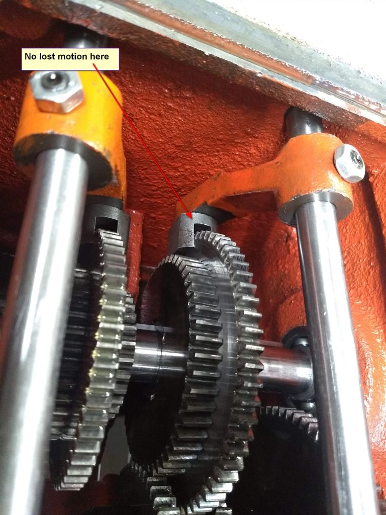

                                                Gary Wooding
                                                  @garywooding25363
                                                  Thanks for all the suggestions. Here are some answers to the questions.
                                                  There is absolutely no play between the knob and the selector fork – the knob is attached to the shaft with a roll-pin and the lock-nuts at either end of the shaft are good and tight. The are are no flats on the shaft. The slightest twist of the knob results in a corresponding movement of the fork and there is no lost motion. The play between the fork and the gear it moves is no more than would be expected.
                                                  When the gear drifts to the right, the shaft, fork, and knob move in unison. There is no lost motion. It certainly appears that the fork moves the gear.
                                                  Although the lathe is more than 20 years old the the gears are very seldom used for speed changes 'cos I use a VFD just about all the time.
