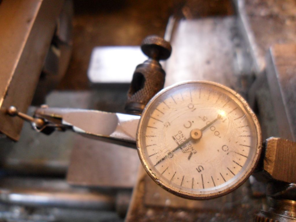

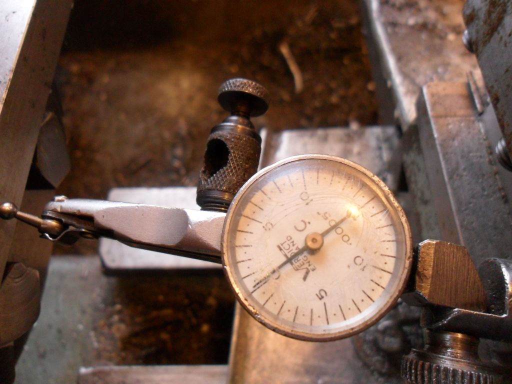

                  towards centreCheck my 40 year super 7 mark 1 turns measure's 0.0003 " over "from outside
                  Edited By Nobby on 24/02/2014 23:11:52
                  Edited By Nobby on 24/02/2014 23:12:27
                  Edited By Nobby on 24/02/2014 23:12:47
                  #144977
                  Nobby
                    @nobby
                    Should have said concave over 3"

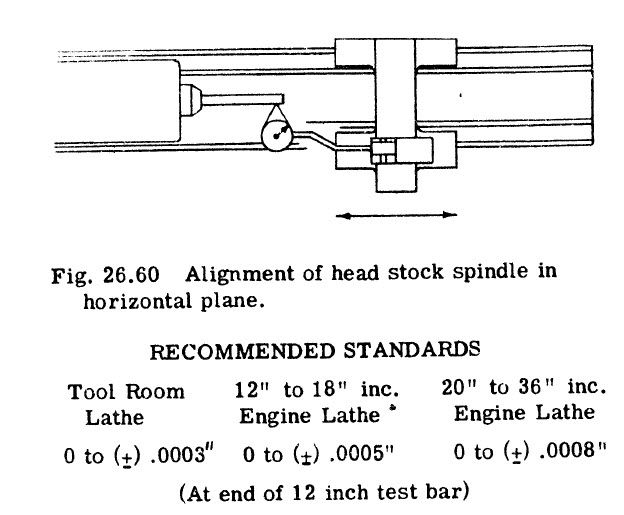

                                John McNamara
                                  @johnmcnamara74883
                                  A lot of the work we do on a lathe is not between centres. Allowing the deflection demon to spoil our work even a say 20mm shaft will deflect away from the cutting forces. if it does the work will be a larger diameter as the cutting point moves towards the tailstock. Very annoying if you are fitting a shaft to an existing hole by feel. It will appear to be tight but when you finally get it to enter the hole it will be loose, Not good.
                                  On the other hand if you are turning a base of some sort that has to sit on a flat surface you want it to be touching the surface all around its periphery not possible if it is slightly convex.
                                  Both the above cases suggest that making the lathe turn very slightly concave is better then allowing it to turn convex.
                                  Edward F connely In "Machine tool reconditioning" 530 pages
                                  Recommends (For a tool room quality lathe) the end of a 12 inch test bar points .0000 to .0003" towards the operator
                                  Boring is a different case you want it to be dead on however that is almost impossible, almost because. a few degrees change in the temperature can move the whole lathe frame out of alignment. I guess that is why many books on the subject suggest we err slightly away from perfect in the direction that is most likely to help us produce good work.
