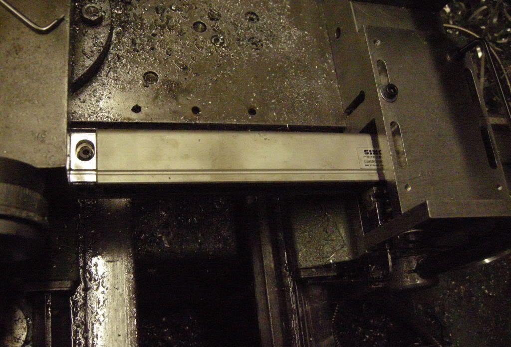

          Next job is to fit a DRO. This is also applicable to a Chipmaster as they share the same saddle and it's not a good design to fit a DRO to. This is what you are faced with.
          There is a groove machined into the saddle either side but it's not wide enough to take the scale. Add to this these lathes have the slot for the compound bolts in the side of the cross side so you cannot cover these up.
          Result is the whole lot has to stick out the back and into the air. Asked around for pictures as to people who have done this and everyone has had the same problem.
          This is a typical one.
          Which puts the scale right out the back, sticking up above the cross slide by 1/2" and needs a further 1" at the rear. In all fairness this is about the best you will get fitting even the slim profile glass scales. Possibly do better with a Newall system but these are not budget systems.
          So staring at this and wondering how I can do better I decided to remove the carriage to have a better look. It was slated for removal as it's only equipped with one ball oiler per side and a tiny one at that, plus when up ended there are no oil grooves in the flat face. Whilst on the subject the cross slide has no oilers fitted at all ?
          Those two grooves ? Well they are purely clearance and no reason at all why they have to be that size. So any purists now need to get their Horlics and go off to bed or if you are reading this in the morning I'm sure your Audi need polishing – again.
          So onto the mill with the saddle and with a nice sharp cutter open the groove up by 1/2".
          While we are at it, poke the tiny oilers out, drill thru for some of Mr ARC's finest 8mm ball oilers and gouge an oil groove in the flat section, the V is taken care of by the vee on the bed being flat topped.
          That takes care of the saddle.
          Hunt a bit of 5" x 5" alloy plate out and using precision felt tip marks, pocket the insides out.
          The two screw holes line up with two existing holes on the back end of the cross slide so when it's bolted to the slide it forms a nice neat extension.
          Scale offered up and it all fits where it touches so job must be a good un?
          Bracket underneath to take the read head and a bracket on the headstock to take the display arm and display.
          Quick test and it's half past dark so that will do me for tonight.
          Just need the long scale fitting which isn't too bad other than the flat machined surface on the rear is at an angle to the bed so needs some bent plates to carry the read head but that for later.

                  Collective answers and questions.
                  Mike,
                  Never thought about magnetic strips, how do these cope with flood coolant ? Plus I already had this DRO setup.
                  Neil,
                  2 M4 cap heads supplied with the scale, didn't realise you could TiG weld alloy to cast ? wink
                  Murray,
                  I'll get some pics from the back later today and post them. Yes the read head is at the rear and again mounts to two existing 1/4" Whit tapped holes in the carriage. I used a slice sawn off a generic scale bracket left over from fitting another kit.
                  Saddle comes off easy and just as you say. Bracket off, the two dowels are tapped 2BA for an extractor, screws out, they just pull thru. Apron is secured by 4 cap screws, two front, two rear in the 'top wings ' of the apron and it drops clear. Then the saddle slides off the back and you can upend it to remove the retainers if needed.
                  Long scale will fit where the taper turning should fit which for me isn't a problem as I never use one, much prefering to use a boring head offset in the tailstock. That should be uneventful except for making a read head bracket that mimics the angle of the bed where the TT should sit.

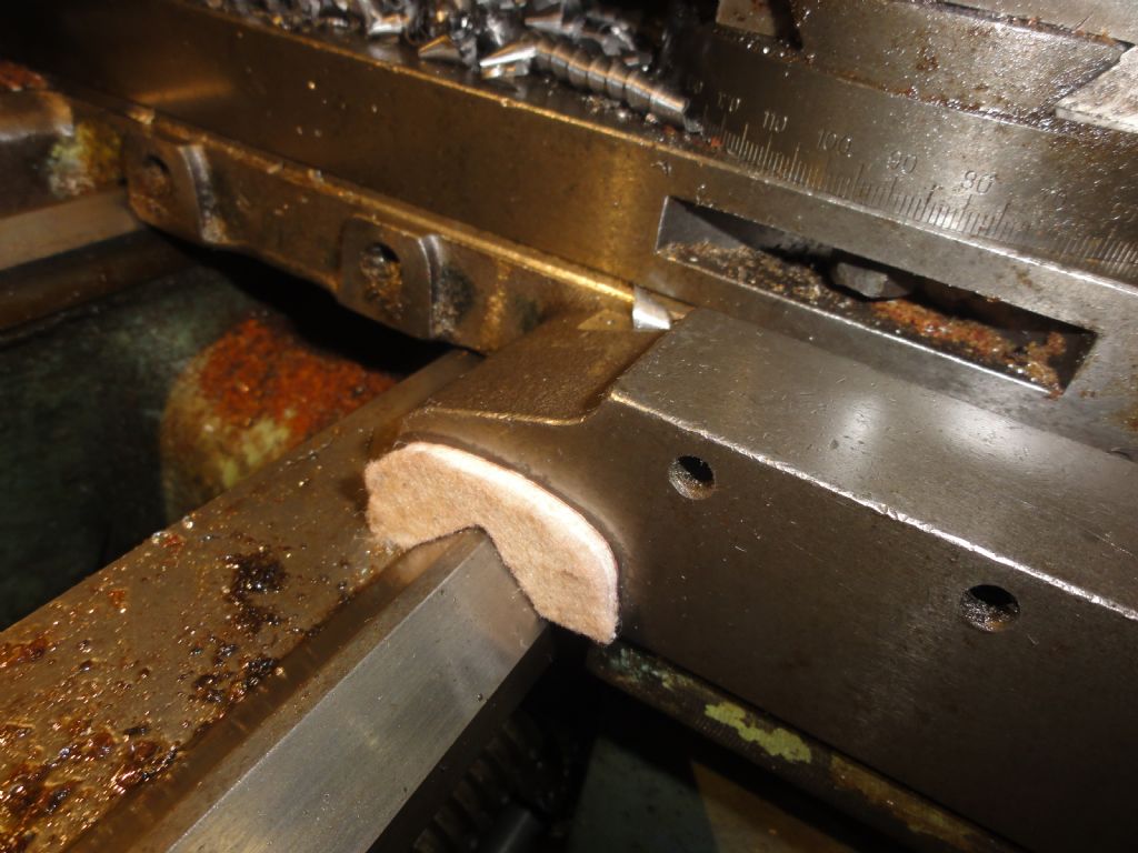

                        Good progress John. Looking forward to seeing more photos once your grass has been cut. I did mine earlier.
                        I made some wipers using that heavy felt that is sold for making furniture feet. About 1/4" thick and self adhesive although the adhesive just looks like double sided tape. Wood chisel and hole punches. It's not really a squeegee type action but you probably don't want that?
                        All the spare tapped holes in my cross slide and saddle have been bunged up with swarf whenever I've looked. What's the clever trick for clearing them without an air line?

                          OK pic of the cross slide read head.
                          Also shows underneath the sub exyension and also not to self that the transit clips, yellow, are still fitted to the scale.
                          Then I got side tracked and started to fit the long scale. Bolted this to where the taper turning attachment should fit as it already machined flat.
                          For anyone following in these footsteps later the face is at 15 degrees to the vertical
                          This is one of the generic brackets supplied with the long scales, not that clear but the bottom leg has been shortened and milled away at 15 degrees. Next job is a flat link plate between theis bracket and the long read head.

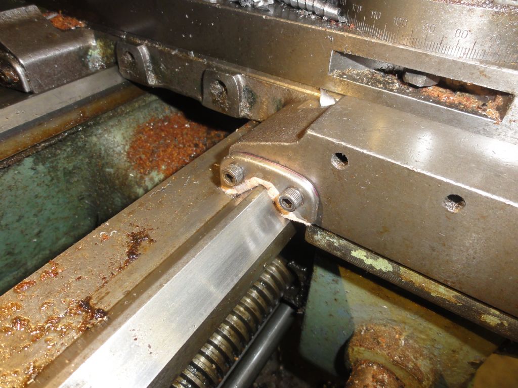

                                                    In terms of wipers, what function do you think they should do? I can't completely convince myself quite what the ideal mechanism is.
                                                    Should they be completely wiping the ways clear each time they pass, rather like a squeegee? Or leaving the oil but pushing the swarf out of the way? Or sweeping swarf out of the way and actively spreading oil on the ways? I would think the middle way myself but it's rather critical to decide which is best.
                                                    The wipers that I removed had gone hard and possibly shrivelled, so difficult to draw any conclusions.
                                                    Looking through some photos earlier I came across a couple of photos of the wipers I made using felt and a set of wood chisels and hole punches. To my mind they clear swarf but leave a film of oil.
                                                    Murray
                                                    Wiper 1
                                                    Wiper 2
