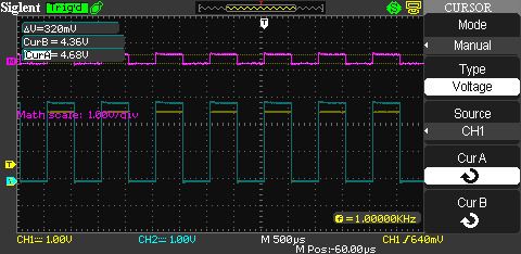

        Meanwhile, I've been exploring my oscilloscope's math functions. No sense made of it whatever until I eventually spotted the math range was set to 1 picoVolt per division! Then took me ages to work out from the manual how to change it. All obvious when you know, baffling when you don't.
        In the learning phase I'm avoiding mains voltages for safety reasons. I was able to calculate the actual value of a random setting of the potentiometer with this set-up:
        and this display:
        I used the oscilloscope's square wave calibration output rather than a sine wave but same sums. Hard work compared with measuring resistance directly with a multimeter, but this is proof-of-concept for the next stage.

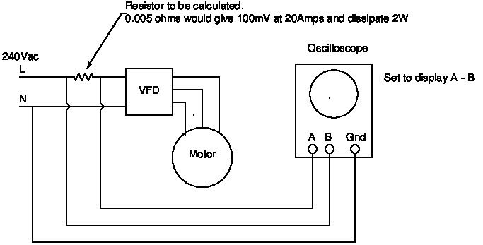

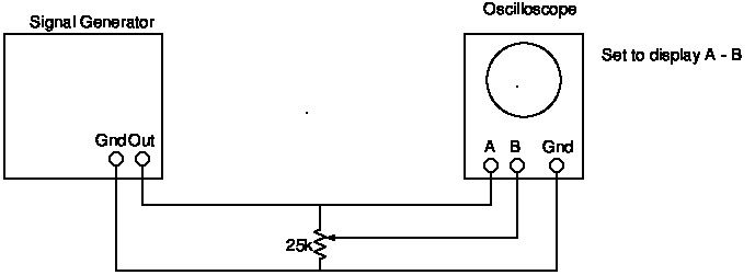

        Plan A looked like this:
        This would allow the start-up current to be calculated accurately at any point of time over a few seconds, but setting up is slightly hairy because the measurements are taken at full mains voltage. Not frightened of that, but Andrew's 'current transformer' suggestion is both safer and likely to give indicative results with less fuss. It's not necessary to use the oscilloscope's Maths functions at all. (Now I've wasted an hour learning how to use them.)

            As shown your set-up is likely to damage your oscilloscope if it dosen't electrocute you. It will certainly trip any RCD you have on the circuit because you are connecting the neutral to ground via the oscilloscope.
            As a minimum you need to use proper 600V CAT II high voltage 'scope probes and an isolation transformer. The proper way to do this is with isolated differential probe, a specialised oscilloscope with isolated inputs or a power analyser.
            It's really not something you should be playing around with unless you really need to and take precautions.
            Robet G8RPI.

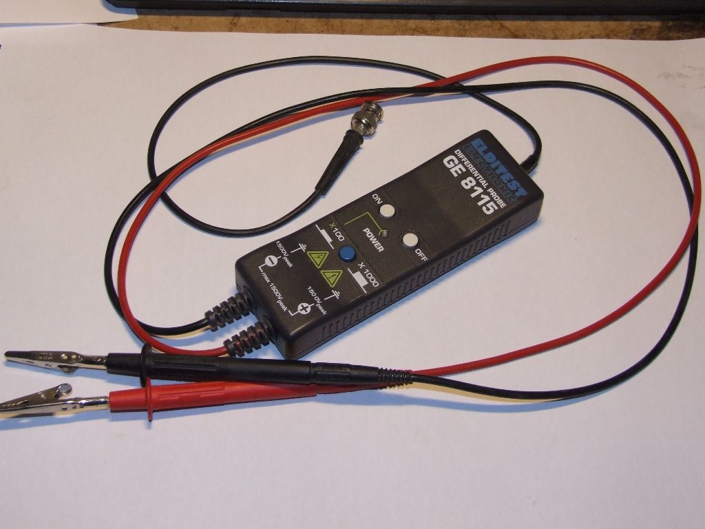

              If I recall correctly differential probes have been discussed before, quite possibly wih SoD. This is what I use:
              It's not isolated and doesn't need to be. However, it's not really the best probe for the measurement specified as it uses an input divide ratio of 100:1 or 1000:1. That's fine if you're measuring mains size voltages, but not helpful if one is trying to measure small voltages riding on a large common-mode voltage.
              Andrew

                At CAT III 1000V and 80M input impedance that differential probe is effectively isolated and is ideal for the job in conjunction with a current clamp.
                Croc clips are a bit dodgy though.

                  Robert, have you never used an oscilloscope on a hefty valve radio transmitter? My scope probes are suitable. The Gnd is the signal ground, and unless there is an earth fault, there is no difference between earth and neutral. Popping the RCD, or damaging the instrument, or electrocuting the operator whilst using an oscilloscope to measure mains voltage is a new one on me!
                  But as explained, Plan A isn't how I'm going to do it. Andrew suggested a current transformer, £4, which I've ordered. No need for an expensive differential probe, and no direct connection to the mains. The disadvantage of the current transformer method is it might not have the frequency response needed to catch spikes and it can't give accurate current measurements without me doing some sort of calibration. Nonetheless, I'm hoping the results will be sufficiently indicative. Unless EMC wrecks the experiment; the waveform close to the lathe could be dominated by VFD switching transients.
                  The question I'm exploring is: 'What current waveform is drawn from the single-phase supply by a VFD/3-phase motor combination when they are first switched on.'
                  I'm interested in the current profile over the first few seconds. With my lathe, I'm expecting to see a largish current, about 20A peak lasting a few hundred milliseconds, after which the current steadies down to a much lower level. Thereafter I expect the average current to be entirely proportional to the load on the 1.5kW motor, couple of amps idling, rising to 6 or 7A working hard.
                  Part of the fun is checking theory with an experiment. Double fun when the experiment itself is challenging.

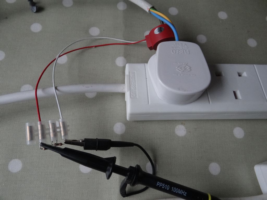

                          The current transformer arrived today and I was able to hook it up to an extension lead:
                          The live wire passes through a hole in the current transformer. There is no direct electrical connection to the mains.

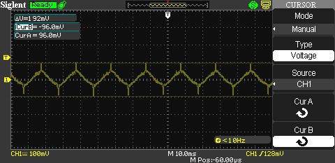

                          I used a 60W tungsten bulb as a test load to prove I could:

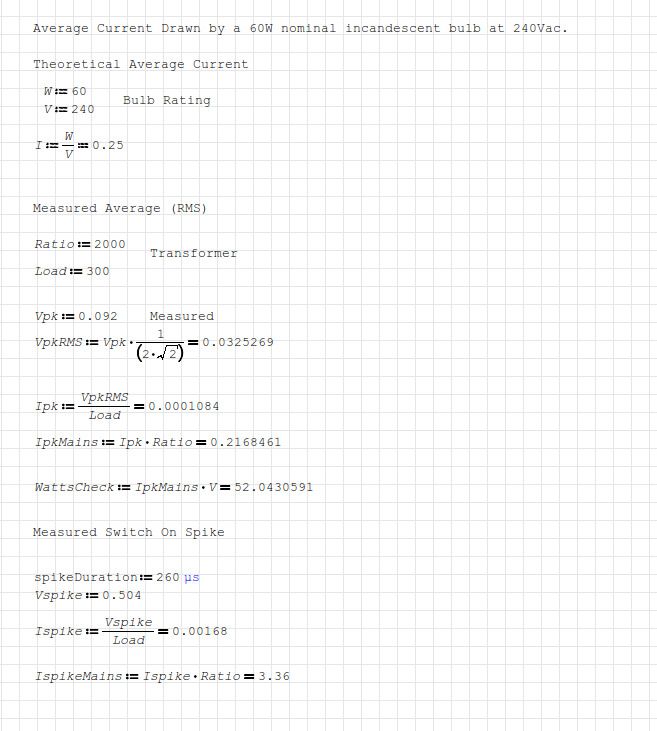

                          1. Measure the average current being fed to the lamp
                          2. Capture a switch-on spike.
                          Success, although the transformer is non-linear at 60W, I got a reasonable match between theory (current calculated for a 60W lamp on 240Vac), and practice (current calculated from peak waveform measured with an oscilloscope and my – hopefully correct this time maths. Theory 0.25A, measured & calculated 0.22A.
                          The current transformer is a TA17 L-04. 2000:1 ratio, 0-20A converted to 0-10mA, 20Hz-20kHz, sample R 300Ω
                          After measuring the average, I tried to capture the switch on current surge. Another success.
                          Turning on a 60W tungsten filament bulb causes a 3.36A spike lasting about 260 microseconds. For average use a 1A fuse would be plenty for a 60W bulb drawing 0.25A. But the fuse would be stressed by that starting current, which is nearly 13.5 times higher normal. Fortunately, the spike doesn't last long.
                          In case I've fouled up the numbers, here's the sums. I calculated RMS current for normal running at 50Hz, and actual current for the spike, which doesn't repeat.

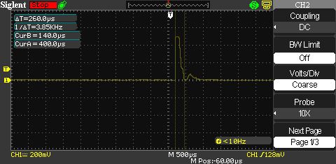

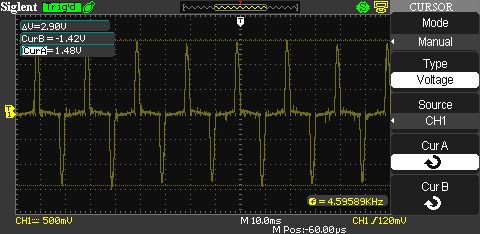

                              Connected my lathe to the oscilloscope with somewhat unexpected results.
                              Firstly, there is only a short spike at power on, VFD only, the motor is switched off. startspike.jpg
                              The spike is about 19A but it is very short. The current waveform immediately becomes a sine wave for several cycles over which the current gradually falls. Then short peaks, of about 0.6A, appear at the top of each cycle, although the waveform remains sinusoidal.

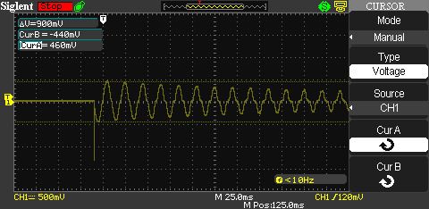

                              Switching the motor on makes the current peaks much larger. This is the motor running at 2500 rpm, with change gears, gearbox and drive shaft engaged, but the motor is otherwise unloaded.
                              This view show the current waveform to be dominated by sharp spikes, of about 9.6A each, and lasting about 2.4mS. As 50Hz UK mains takes 20mS to deliver a full cycle, the VFD only takes cuurent for about 10% of the available time. Presumably this is recharging the capacitors.
                              My VFD takes most current in sharp bursts at supply voltage peak. It does not spread demand for power across the supply waveform, nor does it soften the blow with any zero-crossing cleverness. The fuse is subjected to current spikes, not a gentle rise and fall. With the motor at 2500rpm the average current (measured with a wattmeter) is 3.1A but it is actually drawn from the mains in 9.6A pulses
                              Unfortunately I can't cut metal with the lathe and work the oscilloscope at the same time to see what a heavy load does to the current. Do the pulses get bigger or longer in duration or both? Don't know.
                              However, from the point of view of the 13A fuse:
                              • It has to survive a 19A pulse when the lathe is switched on.
                              • The fuse is subjected to a pulse load, not one smoothly proportional to mains voltage.
                              • When the lathe is consuming 3.1A on average it is actually taking power in 9.6A slices of about 2.4mS
                              • Unproven but, if the 3:1 peak to average is maintained, then the 6A average needed to drive a 1.5kW motor, is peaking at over 18A twice per cycle.
                              • Although the 13A fuse doesn't blow because it has time to cool, it must be stressed by this duty.
                              Going back to the original question, a 20A fast blow fuse looks like a better choice for 18A peaks than an ordinary 13A fuse. Although the 13A fuse might fail relatively early due to this mistreatment, it's not unsafe or unreliable. But pulse stressing an ordinary 13A fuse would be more problematical with a bigger motor, say 2.5kW: I think that's why the makers recommend high amperage fast blow fuses – a more appropriate balance of safety and reliability given all those sharp spikes.

                                          First I think we owe a vote of thanks to SoD for making these measurements. Darn it, should we ever meet I'd even buy him a beer. thumbs up
                                          The current measurements are pretty much what I would expect. The initial short spike is probably some EMC/filter capacitors charging. Looking at the current waveform after that it is not sinusoidal as stated by SoD. If one looks closely the first cycle or so is sine like, but after that each half cycle pulse becomes slightly narrower with a longer period of no current flow between peaks. Exactly what one would expect for a rectifier charging a bank of capacitors starting from full discharge.
                                          With the motor running the current waveform is as expected. Even on no load the motor consumes some power, so the DC link voltage will decease as current is drawn by the motor. The rectifier can only charge the DC link capacitors when the input voltage is greater than the DC link voltage. This only happens near the top of the input voltage waveform. Hence the short current pulses. If an input voltage waveform was superimposed on the current waveform they would nearly coincide, with the current pulse beginning somewhat before peak voltage and ending at, or slightly after, peak voltage.
                                          While it would be interesting to make measurements of the input current with the motor under load we can predict what the current waveform will be. More current will be drawn by the motor so the DC link voltage will drop further on each cycle. So the input current will start flowing earlier in the input voltage cycle. The current pulse will get wider, with the rising edge starting earlier and the trailing edge staying pretty much where it is.
                                          From an electricity generators point of view the input current spikes are bad. That's why most VFD manuals recommend the use of an input filter. As well as preventing high frequency noise from entering the mains they also smooth out the current pulses so the VFD looks more like a resistive load, thus reducing the current harmonics on the mains.
                                          Larger and/or more expensive VFDs may have a power factor corrector at the front end. This replaces the simple rectifier and is essentially a rectifier followed by boost converter that controls input current to keep it proportional to input voltage, in which case the input current will be sinusoidal.
                                          To save SoD looking for his notes the output waveforms, from each phase to neutral, will be a PWM waveform swinging between the DC link voltage and neutral. The base PWM frequency is normally in the range 4-16kHz and the width of the PWM pulses changes every cycle so that the fundamental of the PWM waveform is a sine wave of whatever frequency is desired and with the appropriate phase shift.
                                          Andrew

                                            Andrew has explained this perfectly. I do note that SoD's calculations look bit suspect. For starters it's normal to use peak to peak rather than peak. More importantly, the root two factor only applies to pure sinewaves.
                                            The 13 amp fuse will not be stressed at all by 18A at a couple of milliseconds. The main effect is thermal and this will be averaged by the mass of the wire and the sand packed around it. In fact a 13A BS1362 fuse will not blow when passing 20A (RMS or DC) for long periods of time (hours). It will take 100A for 10ms without blowing.
                                            So a 13A plug fuse will not blow under this load and a 5A one would probably be a better choice as it will actually blow under sustained load. You might get failures if you try to start the motor under load though. An MCB needs to be higher current rating or/and B orC type as they operate on magnetic attraction so are much more sensitive to pulse currents.

                                              Thanks Andrew – that's a very helpful explanation and development of the results. I have a filter tucked away to reduce RFI from the VFD: I ought to fit it and see how much it improves the supply-side waveform.
                                              Also, thanks to Robert for the link to the graph of BS1362 fuse characteristics. The shape of the current vs time characteristic is more or less what I expected, that it lies above the 20A line wasn't!
                                              The point about my dubious maths is well made too: I often issue health warnings and show working so it can be checked. It's because I either:
