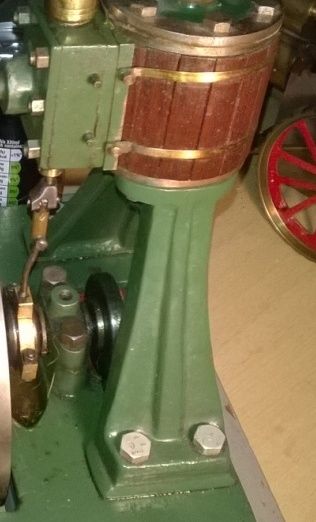

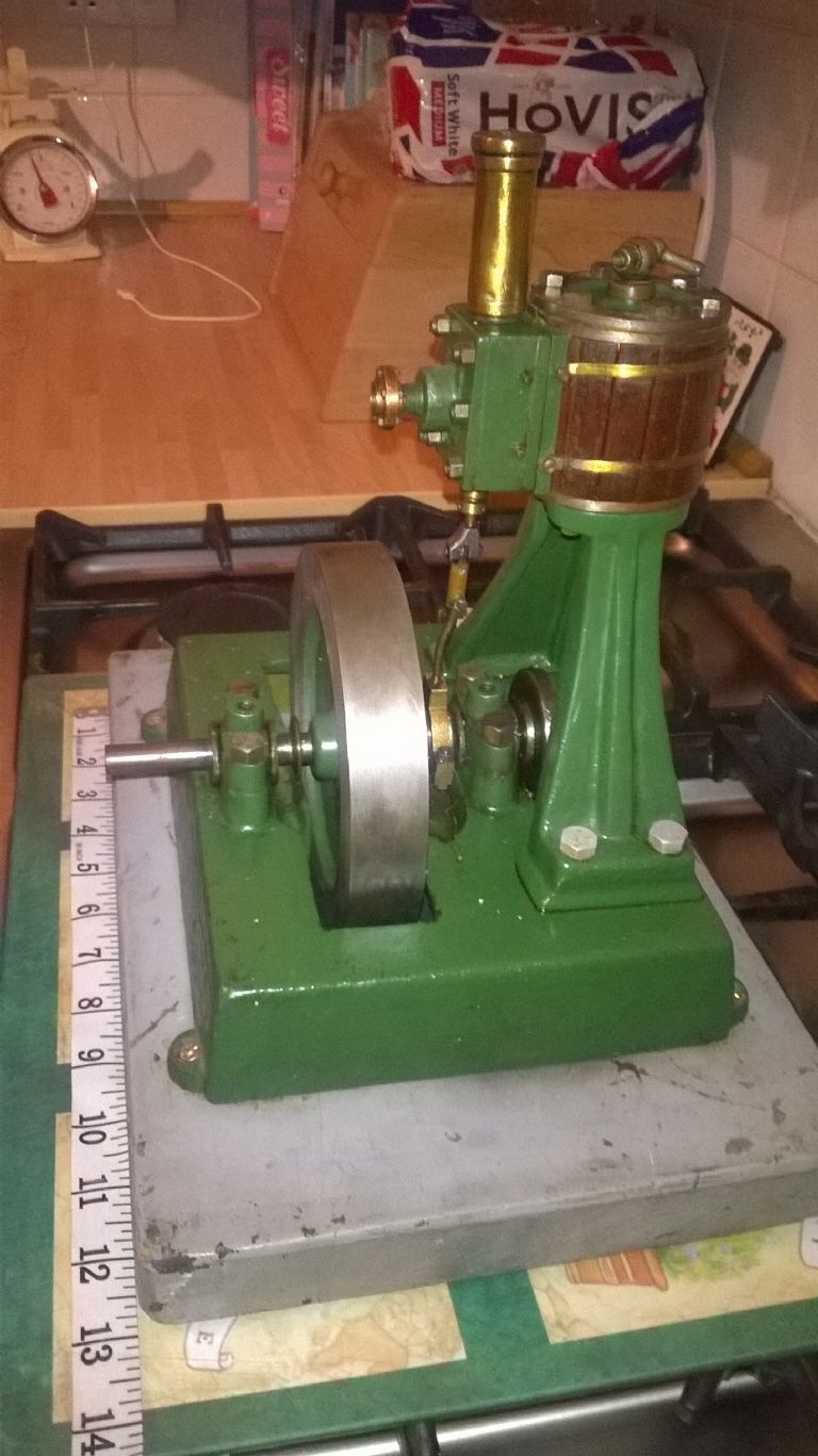

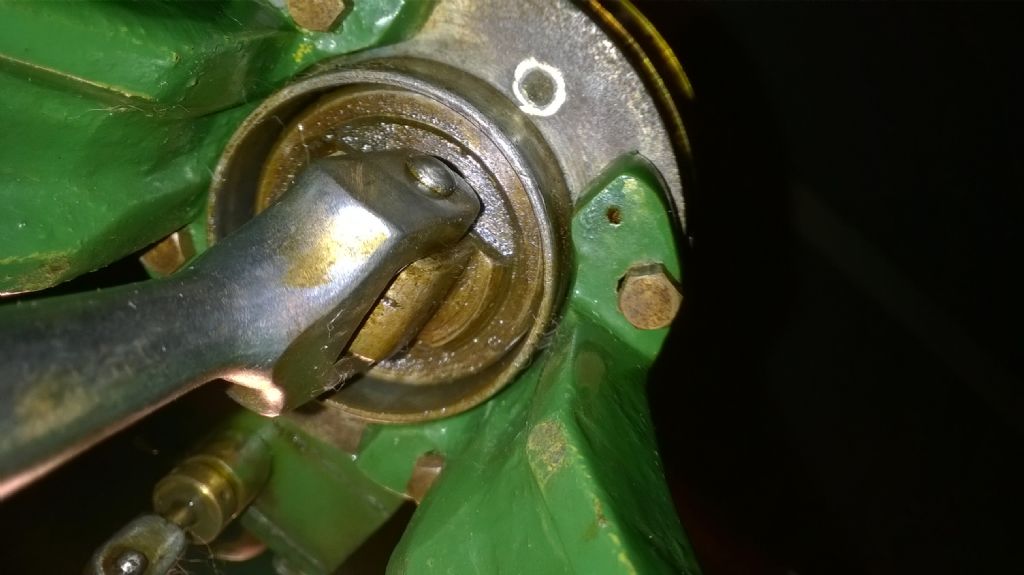

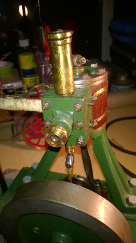

      . I acquired this rather large and heavy engine at the weekend and paid £100 for it.
      Its very heavy (10kg) stands almost 10" tall (excluding wooden base)
      Looks like a 1" bore with 1" stroke and the flywheel is 6" diameter and 3/4" wide.
      The base casting is huge and looks industrial although no visible markings or plate.
      Its been suggested that its a Victorian workshop engine used to power small bench tools.
      Another thought that its an apprentice piece or an exhibition model made by a full size engine manufacturer.
      Any help guidance and opinions would be appreciated.

          Just my unqualified opinion But bolts holding the column to the base instead of studs too few ( in my opinion ) studs holding the cylinder cover and the valve chest There appear to be bolts again holding the bearing caps so I would suggest not an apprentice or an exhibition model from a manufacturer I am open to be shot down

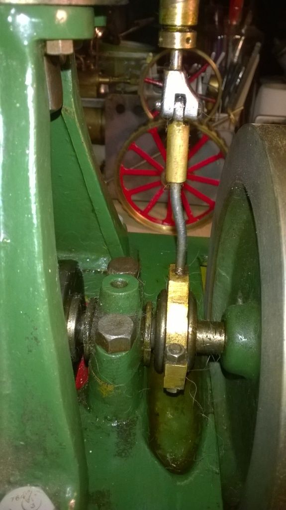

            When there is doubt as to whether an engine is a large model or a small working engine I always look at the big end. If it's meant for continuous running I'd expect to seem some means of lubricating the bearing, other than merely an oil hole. I'd be very pleased to hear other opinions as I do have just such an engine.

              The bolts holding the column to the base are not original in my opinion as the don't match either the studs or bolts elsewhere . The engine may have had some restoration work done in the past…
              Do you agree it may have been an actual working engine ?

                I think this is a one-off scratch built model and the builder has shown quite a lot of ingenuity in its construction probably using/adapting what was to hand. I certainly do not think it is an exhibition model as without being rude it appears a bit crude.
                It has some interesting features however. It is single acting with a truck piston and no crosshead. Is the large brass cylinder on top of the valve chest a lubricator of some sort ?.
                I agree with Bill the big end arrangement looks rather too weak for an engine designed to drive anything. Also an engine of 1" bore x 1" stroke will not produce much power even at 6 bar or so.
                Nevertheless it is a very nice and interesting engine to own and a bargain at the price paid.

                  Looks like lubricators are missing from the main bearings, but a decent lubricator on the valve chest and a drain cock. Would have expected some sort of lubrication for the big end.
                  Those bolts for the standard don't look original…
                  Six studs (screws?) is plenty for the cylinder head IMHO.
                  I suspect taken apart and put together again in non-original condition.
                  The steam pipe connection looks a bit fussy for a mass produced engine to me, but quite possibly made to earn its living. The disc flywheel suggest function rather than decoration as well.

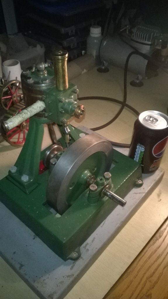

                    I note that the feet of the standard are tapered and the legs wide spread. It appears that the standard may have been adapted from say a Stuart 7A and split and splayed out to fit a diiferent base. It looks like a Bitza.

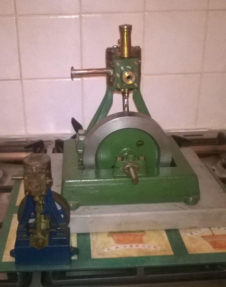

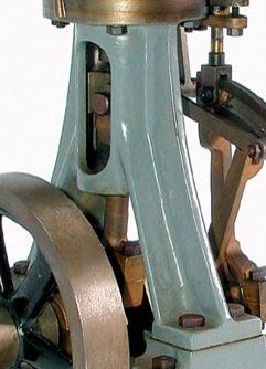

                        Posted by thomas oliver 2 on 16/03/2015 18:53:11:
                        I am inclined to disagree on the Stuart standard thoery
                        heres a Stuart number 7A standard……..
                        stuart 7 standard
                        And here's the one from my engine……..
                        unknown vertical engine
                        As you can see although they are mildly similar they are not the same when you look up close in many ways.

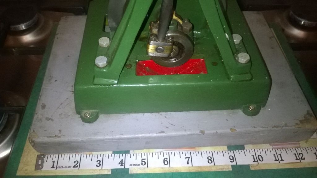

                                Loosenut, if you observe the 3rd shot from the bottom you will note that the top of the legs looks as iff the trunk guide has been cut away.. The tops of the legs look peculiarly thin.. On closer observation, I note that in fact the feet of the original casting have tapered packing fitted to achieve the correct splayed angle.
                                #184253
                                  The other sign that they are chopped about legs is in the view showing the underside of the cylinder. What was once a cast ring at teh top of the legs of smaller dia that the cylinder has been cut in half and moved outwards that is why the dia at the top of the legs is smaller than the OD of the cylinder flange.
                                  Probably not from a 7A but could have been home recasts from any one of several vertical engines
