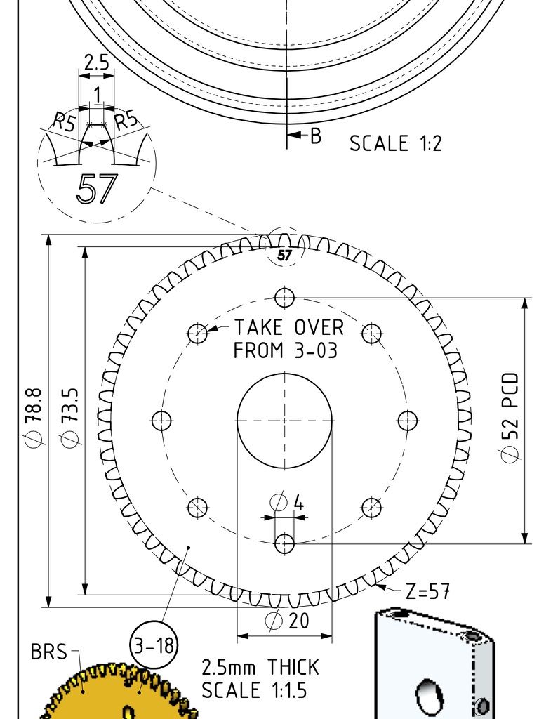

      …………… l take it the diameters stay the same, ………..
      If you go with teh 25:77T sizes then the large brass diff gear needs to be 79mm overall diameter and the smaller output from the gearbox 27mm diameter for MOD1. Cut is 2.4mm deep.
      Simple formula is (number of teeth plus 2) x MOD so taking the 77T you get (77 + 2) x 1 = 79.

        … to be honest the drawings could have been bigger with more space around them.
        These might help a little [if you decide to make your own cutters]

          Though it would have been better if he had dimensioned the gap (cutter shape) rather than the tooth.
          #418526
            Posted by JasonB on 12/07/2019 17:03:45:
            I suppose you must be grateful for what you're given.

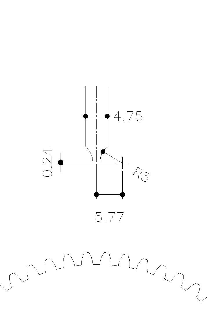

                  For those wishing to make the tractor as it is drawn I have produced a drawing of the gear tooth cutter for the 19 and 57 tooth gears. Based on the information given on the drawing.
                  Regards
                  Gray,

                    Yes l like that cutter design very clear as to how it would work , l no one of my lathe gears is a bit worn ,so looking at that design ,if you have a gear on the bench you can then make the cutter to the right profile ,one could make almost any gear set up ,will have a play when l get my gears out of the way,just to say l can do it,this week has been a week of learning for me and very nice people to go with it.
